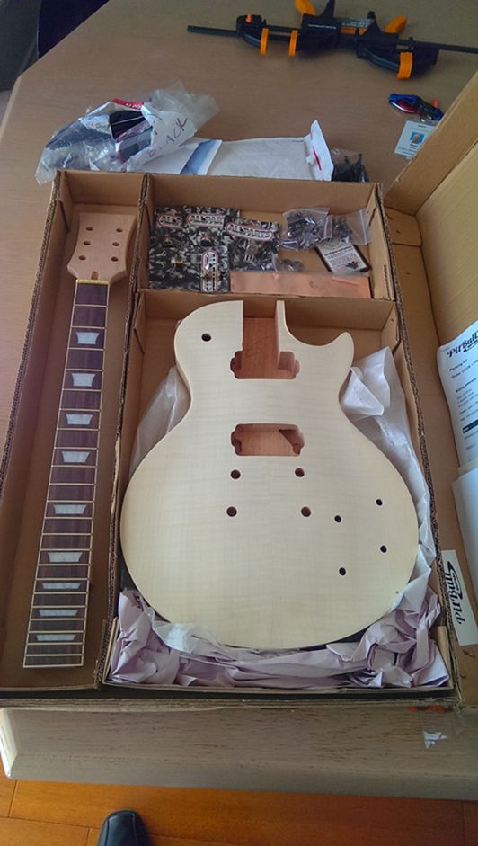

    So the WOFTAM arrived today...
    LP-1 with a flame maple veneer.

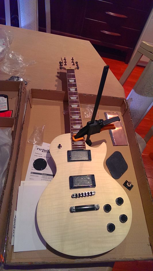

    Standard bridge and pups, but will probably swap in alternative pups down the line
    Electronic upgrades with Bourne pots, the fidelity widget, improved jack, shielded wires etc.
    Realised that I didn't get the bone nut - bugger. I'll order one of those before the build gets too far along, but would have preferred DB to do the hard work on that one!

    Mock up build has gone alright, found a few little niggles:
    - The pre-drilled pot holes are a little too small for the Bournes. Easy fix.
    - Small chip near the neck in the veneer - meh (I think). Hopefully by the time stain and finish is on it wont be noticeable. If it is - its character...

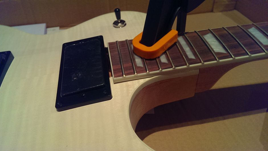

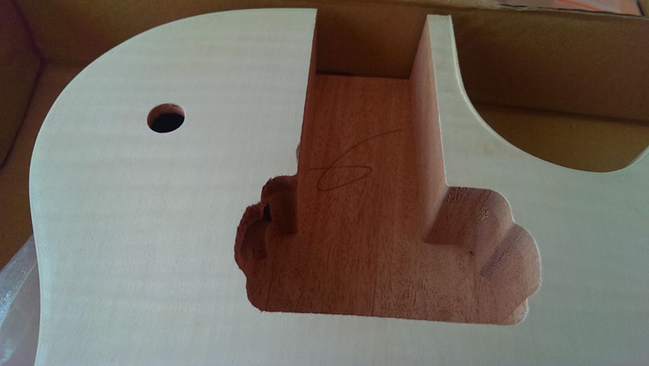

    - Gap between the neck and the neck HB. I honestly don't know if this is a thing, or just how its meant to fit. Neck fully seated as solidly in as it goes, but still has some air gap where you can see the light going into the cavity despite the HB being pushed as far neck-wards as the routing allows.

    Hi Griffo, kit looks pretty good. Looks like you will need to route or chisel some of the neck pup cavity on the neck side so the neck pup is flush with the bottom of the neck/fingerboard. Before you do that make sure enough of the pup surround will cover the bridge side of the neck pup cavity.
    Once the neck is glued you won't even notice the small chip.
