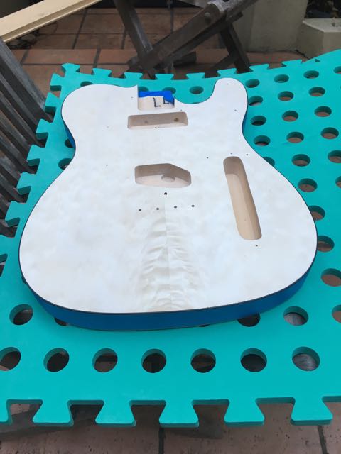

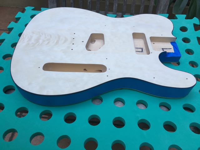

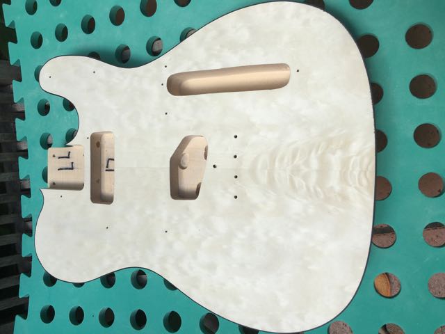

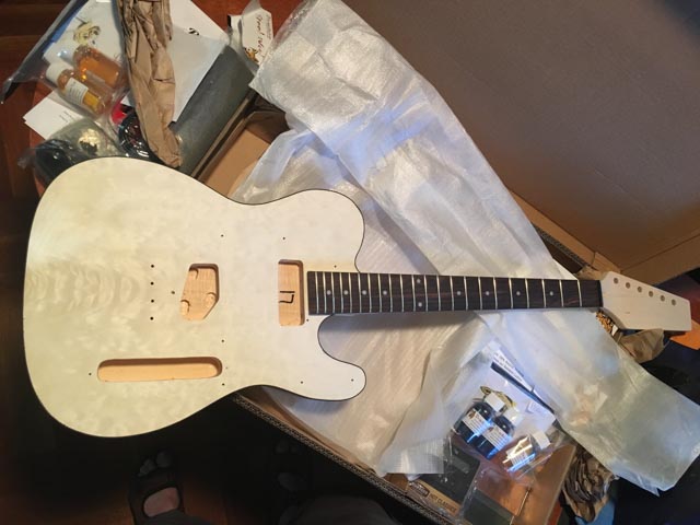

    Kit arrived nicely packed and undamaged after its trip from Perth:

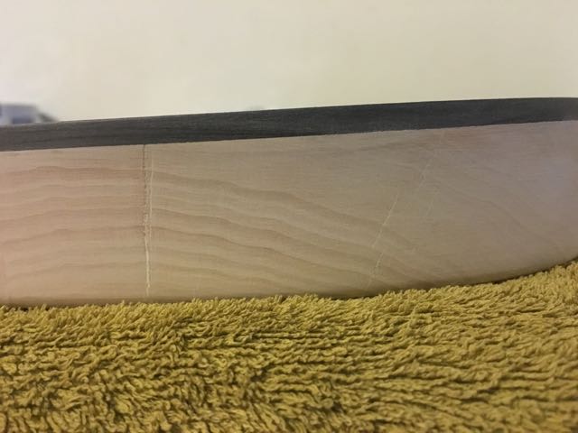

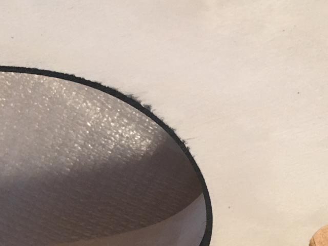

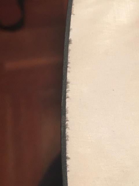

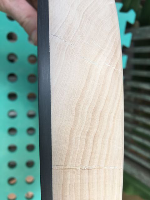

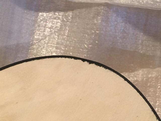

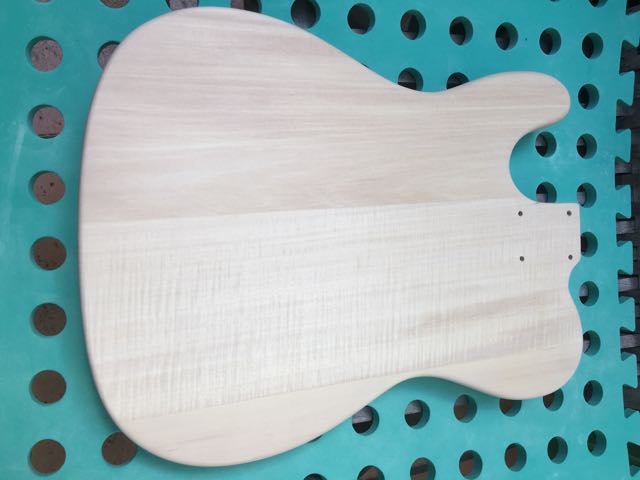

    One quirk has been the "bleeding" from the black edge binding into the grain of the quilted maple (see photos below). Adam has kindly offered to replace the kit with a non-quilted version, but I thought I would ask if anyone else has seen this and worked out how to fix it or work around it?

    I do like the quilted maple grain and would like to keep it if possible.
    Can't go wrong with a blue Tele Marze!
    As for the bleeding , with some very gentle sanding and the addition of the colour, I doubt it will be all that noticeable ... If all else fails you could do a dark blue or black burst to hide it

    Not much you can do about that bleeding, apart from what Stan suggested, and go for a burst effect and put a very thin black boarder around the whole top of the guitar.
    The problem isn't really fixable by sanding, as the veneer is so incredibility thin, in trying to remove the bleeding you would more than likely sand through the veneer, which is un-fixable apart from totally removing it and replacing.
    So options are
    1] Do a burst finish to cover the bleed
    2] Forget about the figuring and just go a solid colour.
    3] Take up the offer of a replacement.
    If you really want the figuring, I'd take up Adams offer on a replacement.

    That bleeding is caused by the acetone used to adhere the binding... It is real pain in the butt!!
    Anyhoo, wot Stan and Tweaky sed.... the black edge burst is a great work around for this problem.

    Back to the guitar, i am thinking of doing a black burst stain on mine, just being fancy, i think thats the way for you to go with the Acetone bleed on yours.
    Hi Marze, welcome to the forum
    as others have suggested. Keep sanding the veneer to bare minimum, Pablopepper from the forum sanded through a couple of spots and he didn't do much sanding at all.

    It's a shame they predrill the holes for the pickguard on these I think I have seen 1 or 2 other on here like it. Those toneriders should be great I have been meaning to get a set as a bit of an upgrade on a squier tele I have
