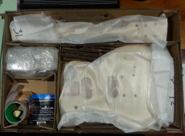

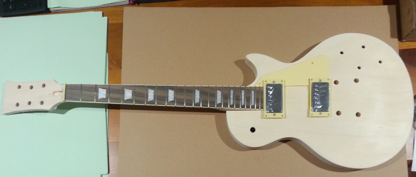

    Ok so I got my GLP20 – Gibson Les Paul Shape Guitar Kit and am about to start this project.
    Step 1: Mock up Your Guitar
    I did see where the pickups and bridge are placed but not to the point of installing tuning keys or the two outer strings.
    I’ll skip that unless advised I should do it with this particular model GLP20 – Gibson Les Paul Shape Guitar.

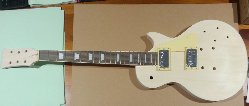

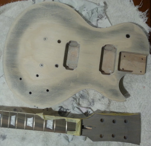

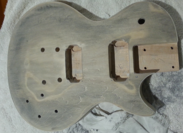

    Sanding and staining to pop the grain:
    -Spakfilla applied to all the dents on the guitar face and back
    -Sanding with 240 grit on guitar face
    -Stained the guitar face with black ink. (I think I used 10ML and added five drops of black stamp ink.
    Once the ink dried I sanded the guitar face with 240 grit to pop the grain.
    As you can see in the photo below I have gone through the veneer, if thats the correct term. (Above where I mentioned a 1mm top layer on the guitar face.)

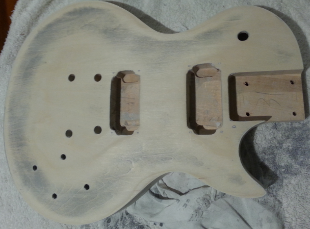

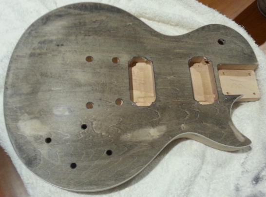

    It wasn’t dark enough so I think I used 5ML water and added five drops of black stamp ink.
    Sanded with 240 grit too much as you can see below with the unsightly patterns over the guitar face.

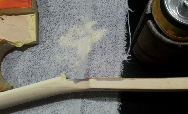

    Continued sanding the face with 240 grit.
    Put the masking tape over the nut and sides of the head stock.
    Sanded head stock with 240 grit.
    Stained head stock with a mixture of 5Ml water and five drops of black ink. After drying I sanded it with 240 grit.

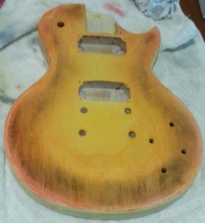

    When attempting the sunburst affect I diluted the Colortone with water with the same ratio as the black ink above not realising there was no need for this. (I am new at this and have no idea, even sandpaper is relatively new to me).
    As you can see in the image below it doesn’t look the best.

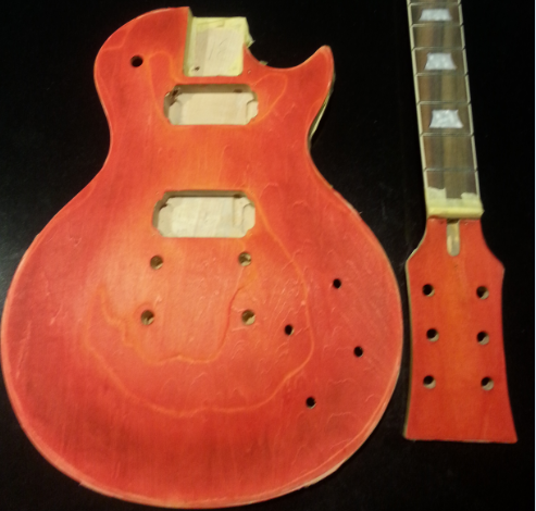

    To try and fix this mistake and forgetting to even try to go from red, orange to yellow I did the following.
    -Lightly sanded the darker areas with 240 grit.
    -Sanded with 320 grit and then 400 grit.
    -Applied more yellow Colortone over the middle section
    -Applied more red Colortone around the edges of the guitar face and slowly working my way inwards.
    The photo below doesn’t actually show the correct colour. Without the camera its a shade darker red.
    How can I make this a darker red? Should I add another layer of red Colortone or mix a drop of black ink with it first?

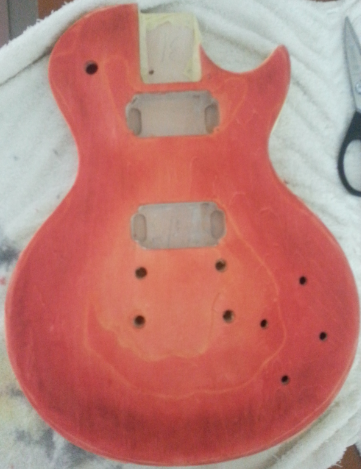

    I’ll try and deepen the colour slightly. Below is a picture of it now with the headstock currently. I’ll post another picture after I’ve deepened the colour.

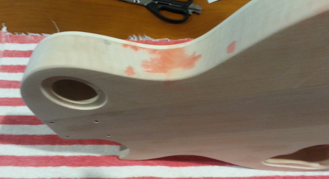

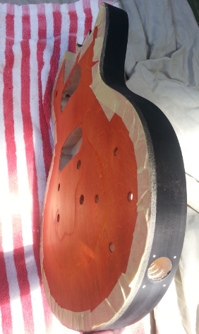

    Here are a few more pictures. You can see where the masking tape didn’t stop the stain dye from bleeding through onto the sides. Can anyone recommend some good masking tape perfect for guitar projects?

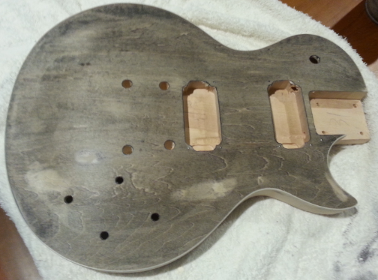

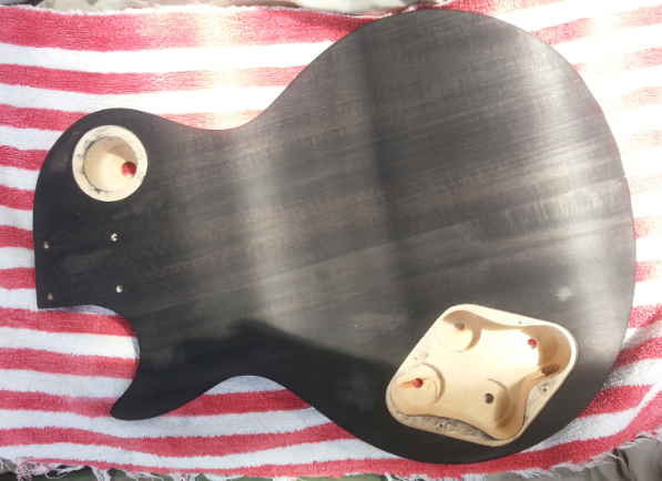

    I made a mistake and applied ink before finishing the sanding. I’ll try and sand evenly working from 320, 400, 800, 1200 grit and apply more black if needed. I might even go for a grey yet.
