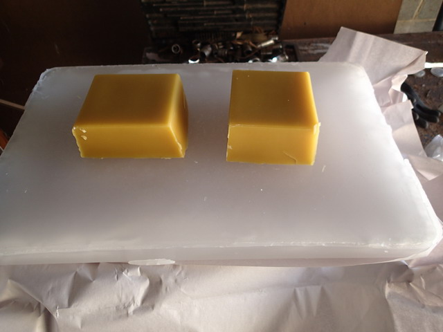

    My setup
    wax on wax off 80-20 mix

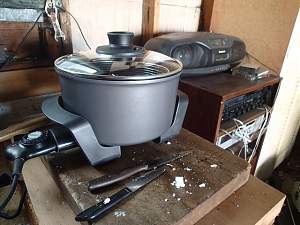

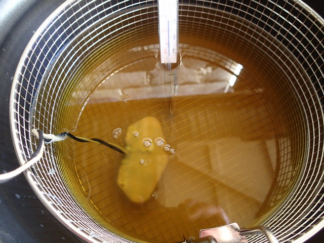

    Sunbeam deep fryer is perfect.

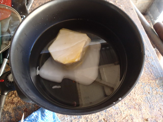

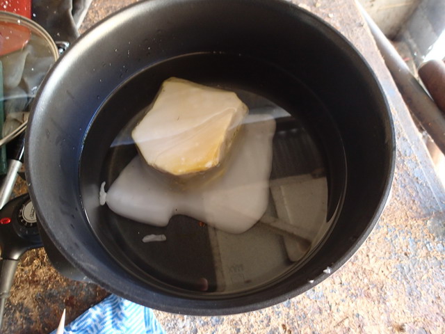

    Melting melting, keep your eye on it dont walk away and leave it.

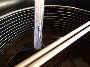

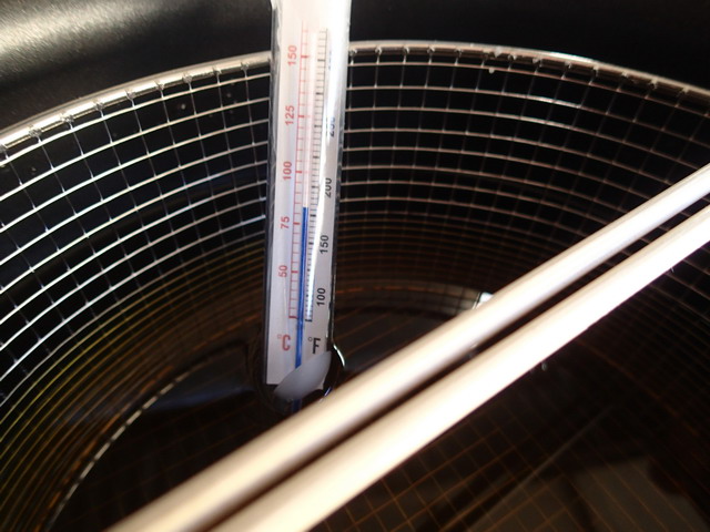

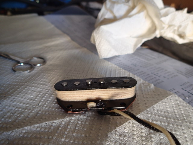

    Bubble Bubble, 15 to 20mins, i move it around a few times, also making sure it remains wholly with the basket

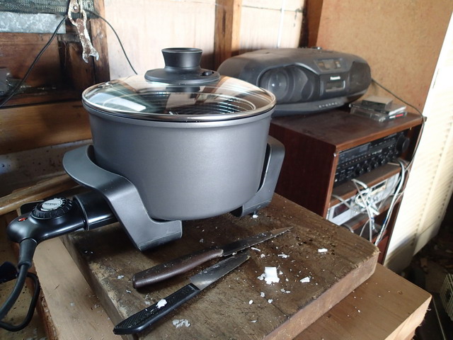

    Finished and ready to rock
