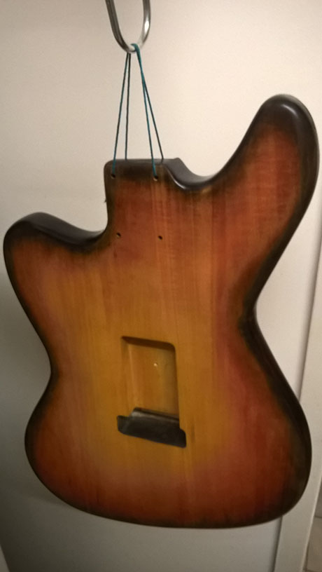

    This is a burst of Coolangatta Gold, Outback Sunset and Black Stump with 3x stain coats. The third coat seemed to be a sweet spot - the colour is vivid and it has a really nice satin feel with a bit of gloss. To be honest - really happy with the look and feel as is (or was). I applied the first intensifier coat, and I can't say there's that much of a difference - other than I wasn't really sure how to blend the different colour intensifier (not wanting to overwork it) so some of the orange to black areas will need some attention with the steel wool.

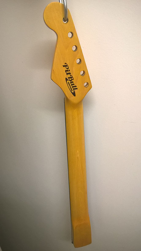

    This is the neck. Bastardised Mission Beach mix with 2x Stain, 2x Intensifier, 2x final. 110% awesome. The DT neck final coat is amazing stuff. Even before going over with steel wool it is super smooth. After the second coat it feels like something you'd pick up in a shop (and then take home to have your way with). I'm hesitant to do another coat because I feel like there's a greater chance I'll ruin it rather than making it better.

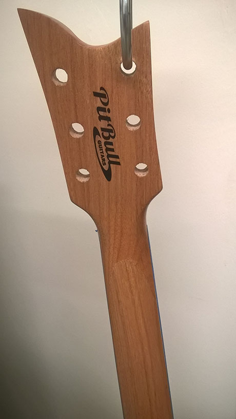

    This is the neck of my colourless kit. 2x Stain, 2x Intensifier (same as on the body below) and 2x neck final coat. I can't say enough good things about the DT neck final coat. Pure amaze-balls. Though I think the mahogany could take a 3rd coat.

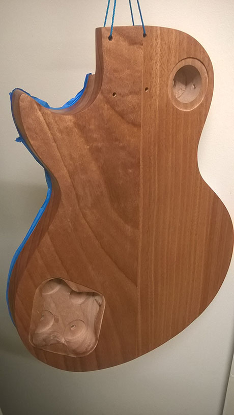

    This is a shot of the colourless kit with 1x stain, 2x intensifier and 1x final. Being colourless, I wasn't sure what the benefit of multiple stain coats would be. The second intensifier coat seemed to deepen the natural colour of the woods though. Plan is to put another 2x final coats on as the first was a bit patchy.
