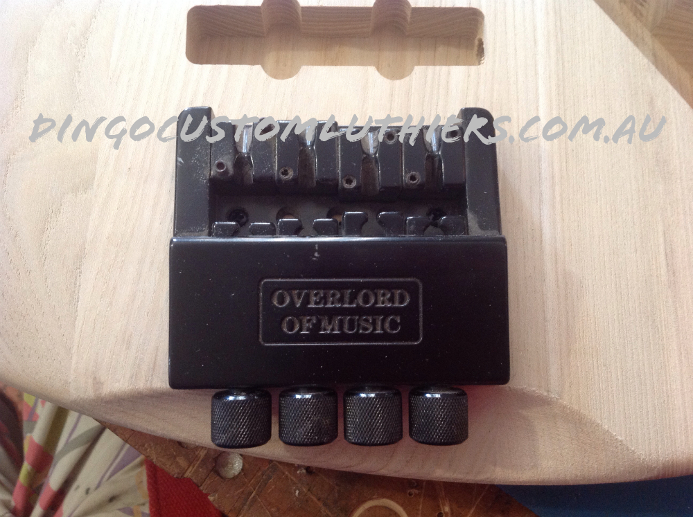

    This Bass features the Overlord of Music bridge...

    Looking great already DB. Can we get a close up shot of that nut end of the fretboard? Would be very interested if you could explain the setup a bit more, it's all alien to me. I guess the strings are threaded from the nut end? Looking forward to more steampunkedness.
    Moderator dingobass's Avatar
    4,491
    No worries Gav.

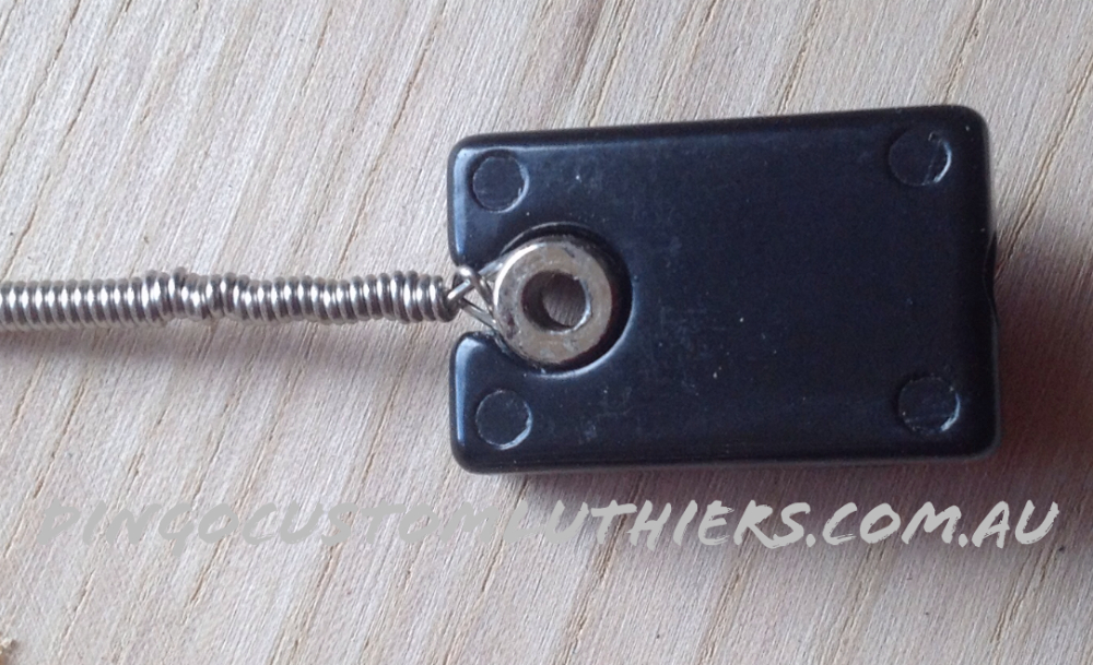

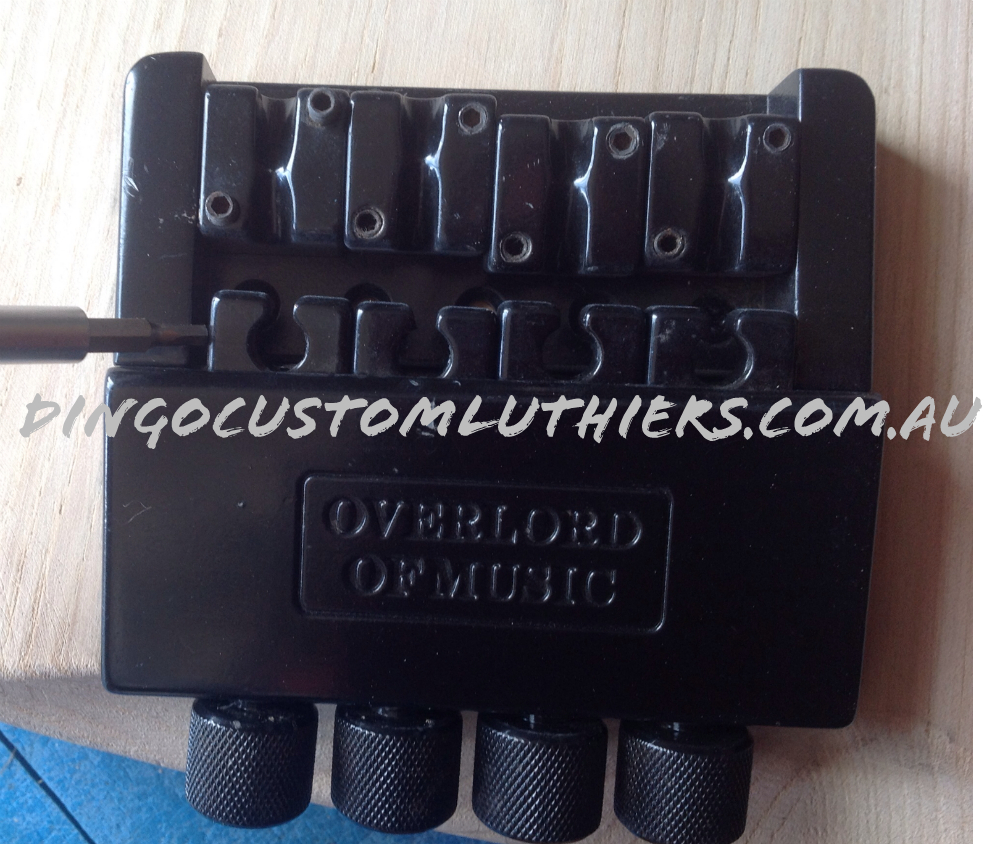

    The headpiece acts as both nut and string clamp. (Under normal circumstances, the slots would sit on top of the fingerboard)
    To string up, start at the bridge end.
    Back the string retainer off until the ball end holderer is exposed.
    Push ball end in half way!
    Then tread string through hole, getting as much tension as possible and tighten grub screw. Do not over tighten!!!
    The string clamps will hold the strings securely.
    It is wise to leave a decent length on the string at this point.
    As you tune up, you may have to loosen the grub screw and pull some more string through.
    Tune up with knobs, refer to above if you run out of travel....
