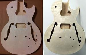

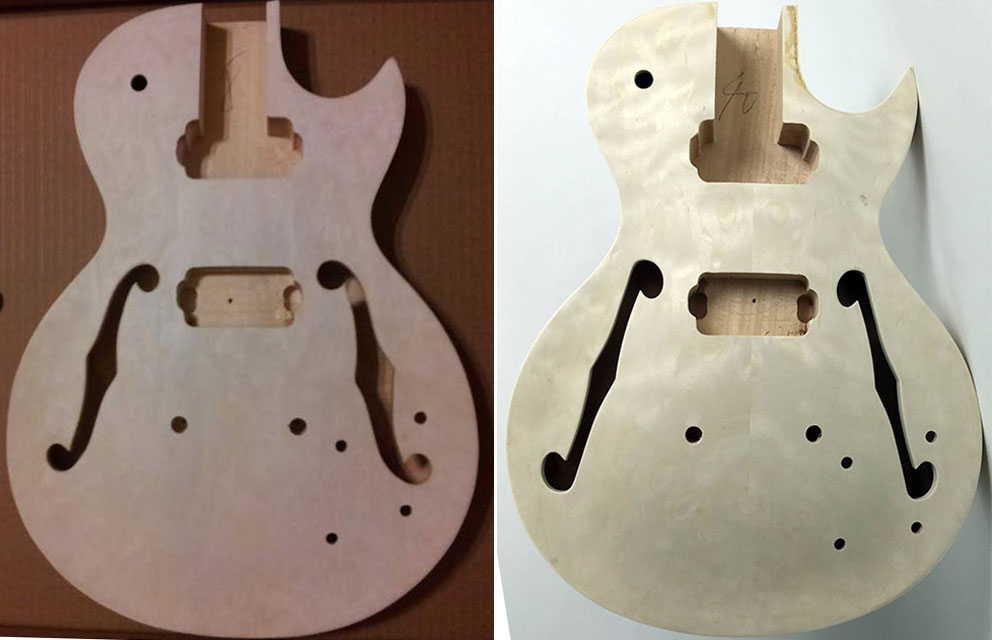

    Old ES-2V model on the left. New 'F' hole design on the right. I was just about to pull the trigger on one when I realised the factory had changed the design.
    I may be in the minority here, but I hate the change.

    Not a fan of the new style either.
