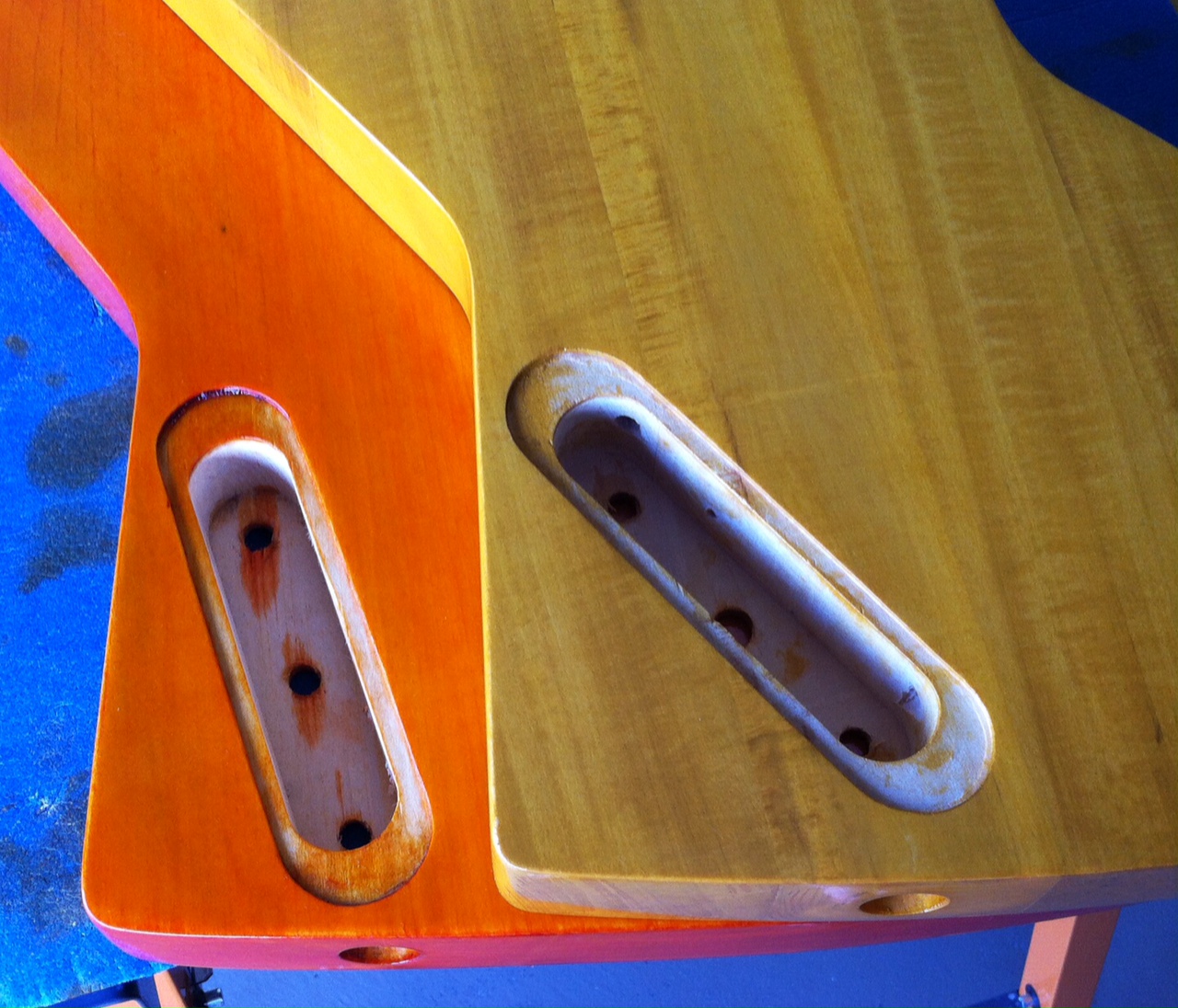

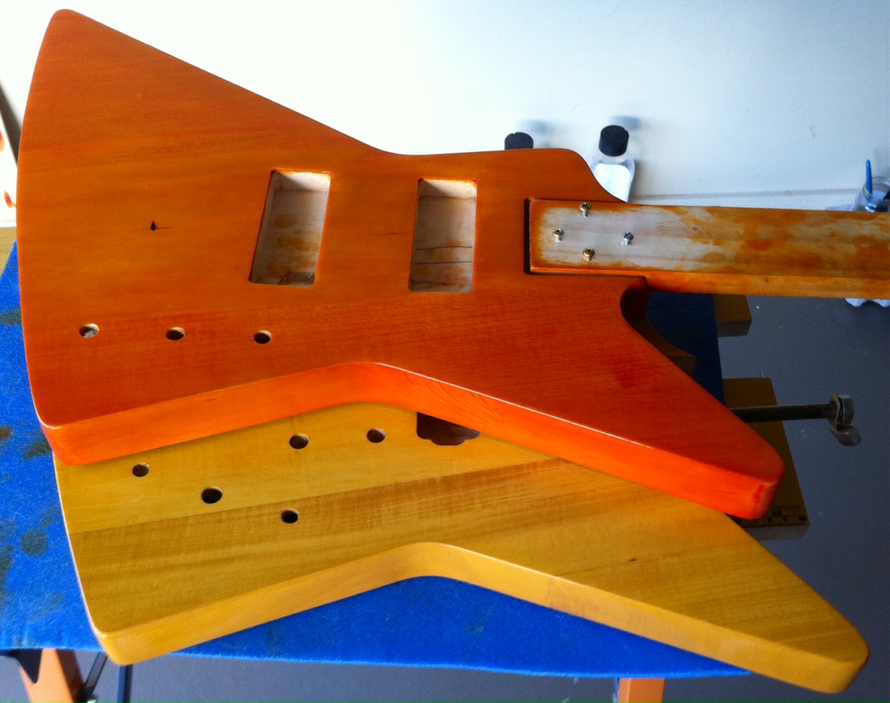

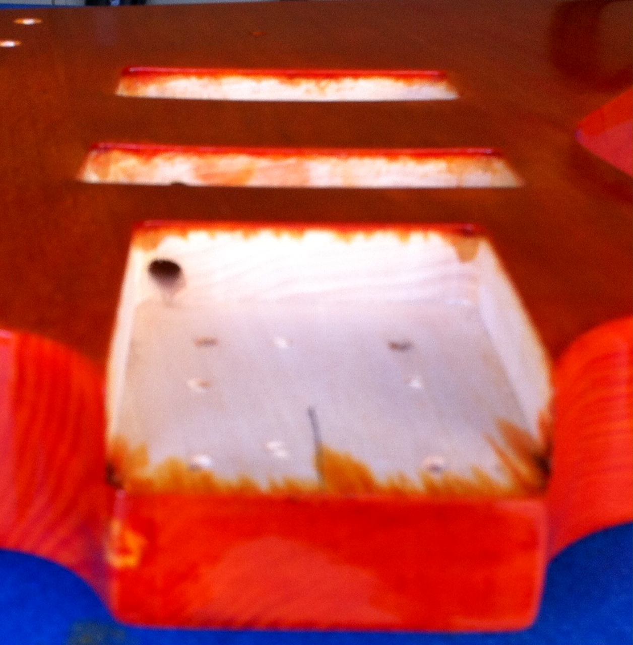

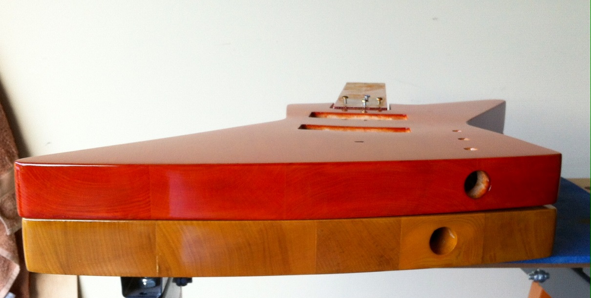

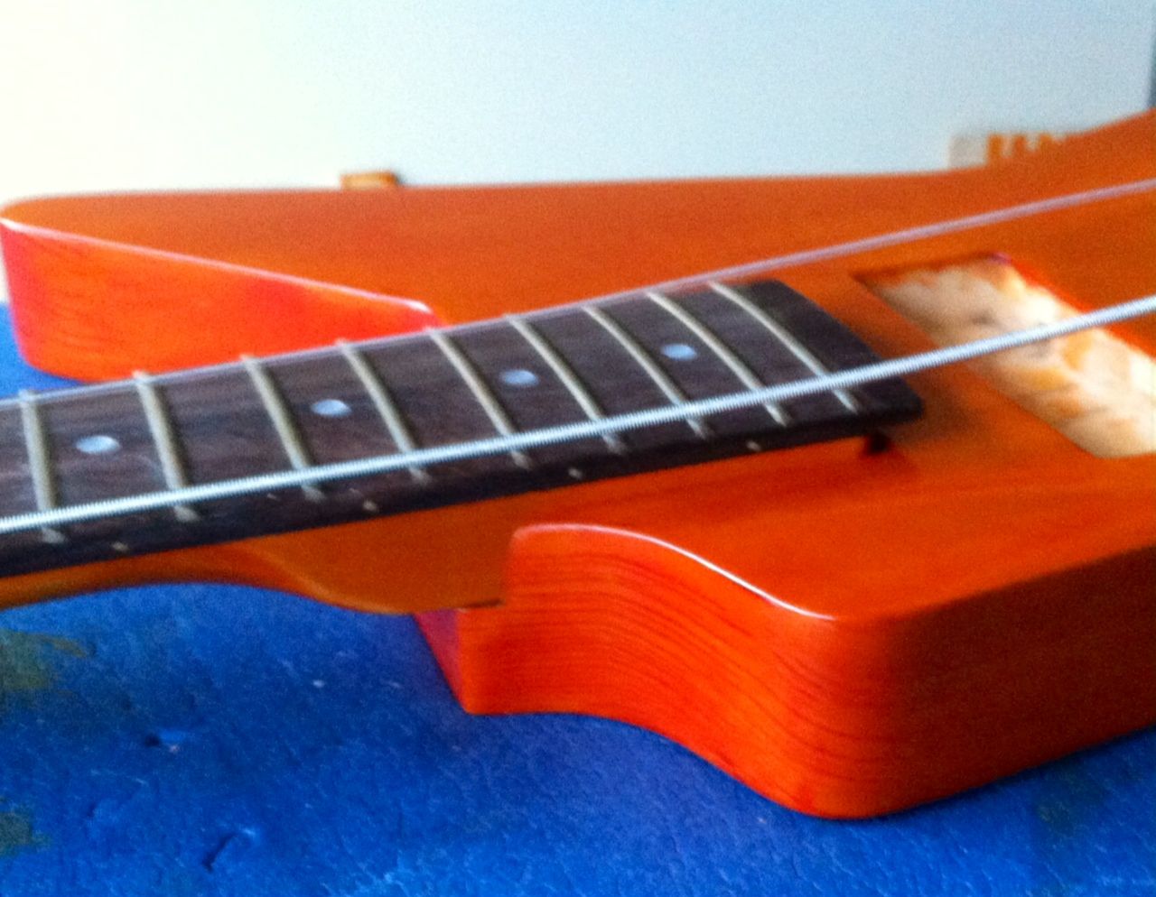

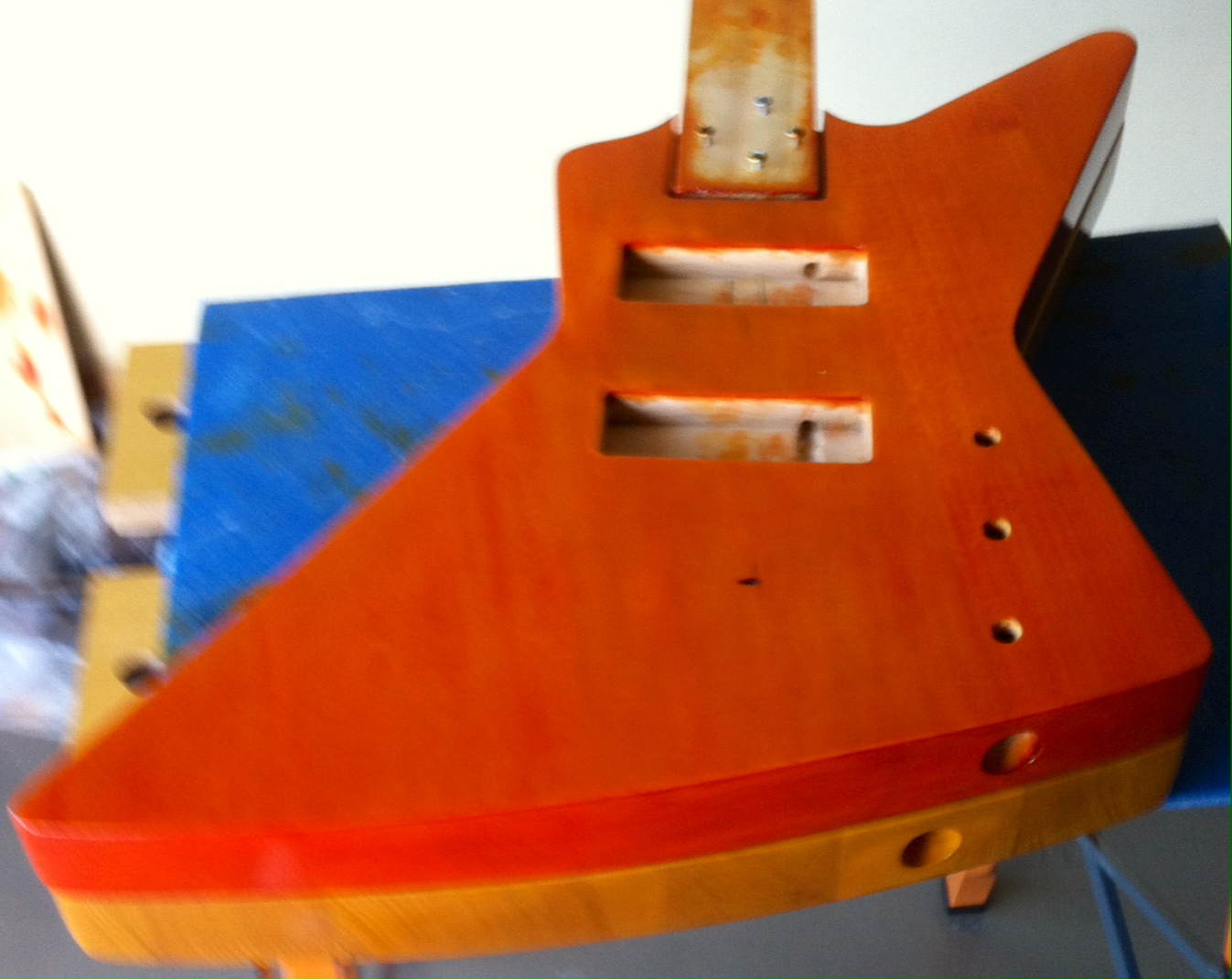

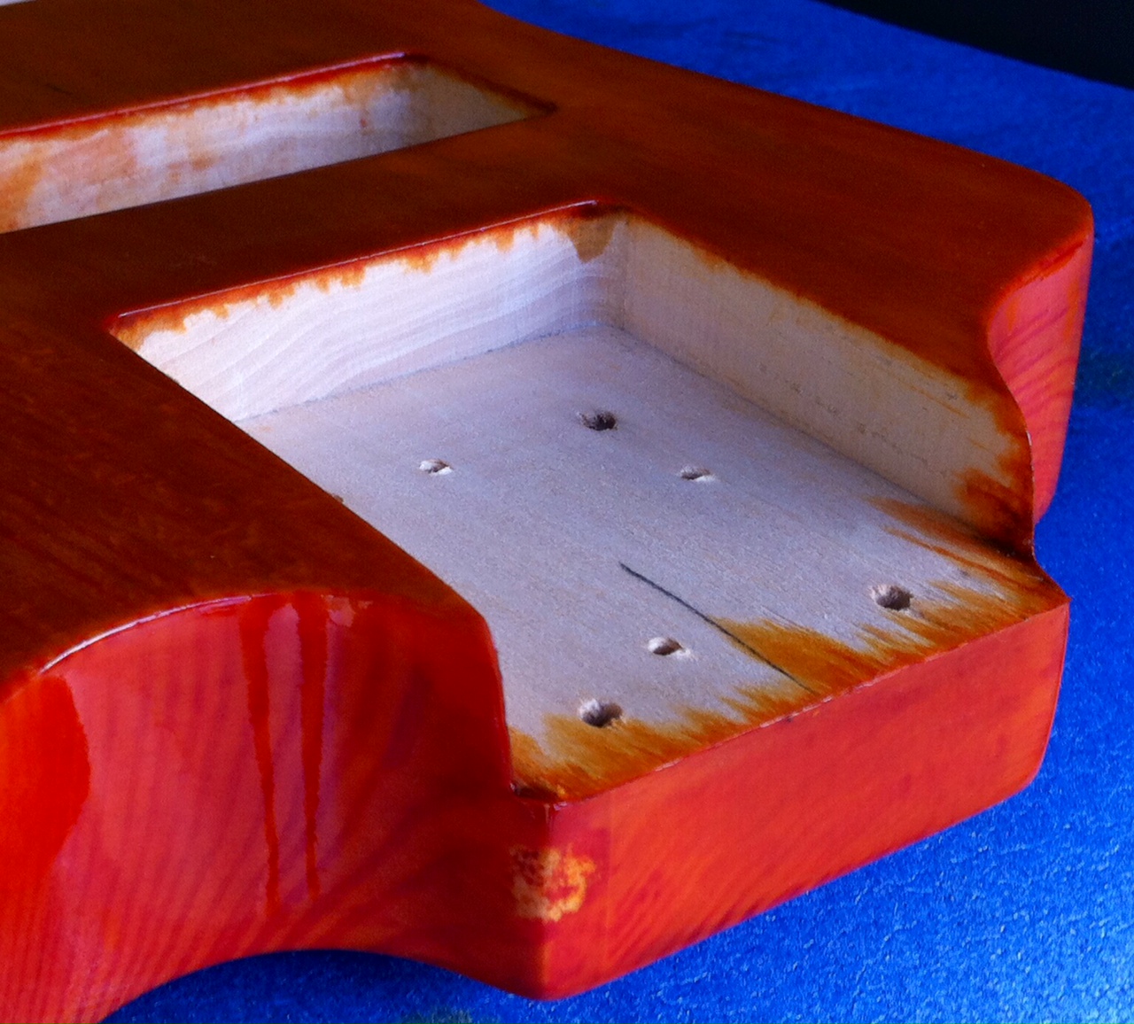

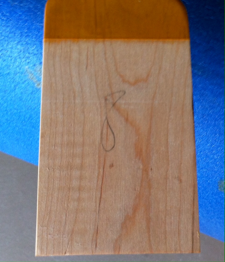

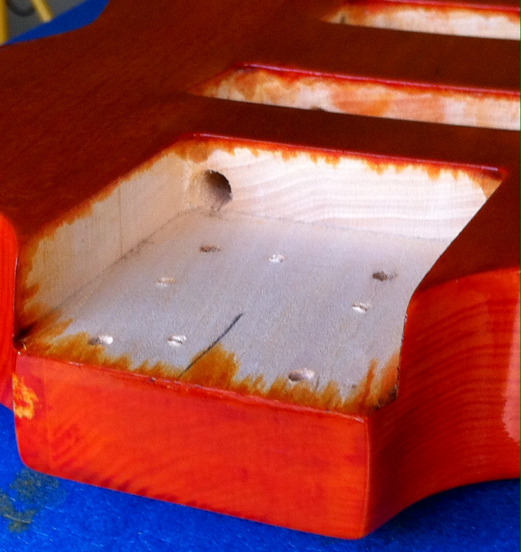

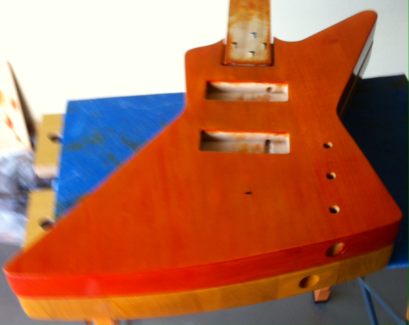

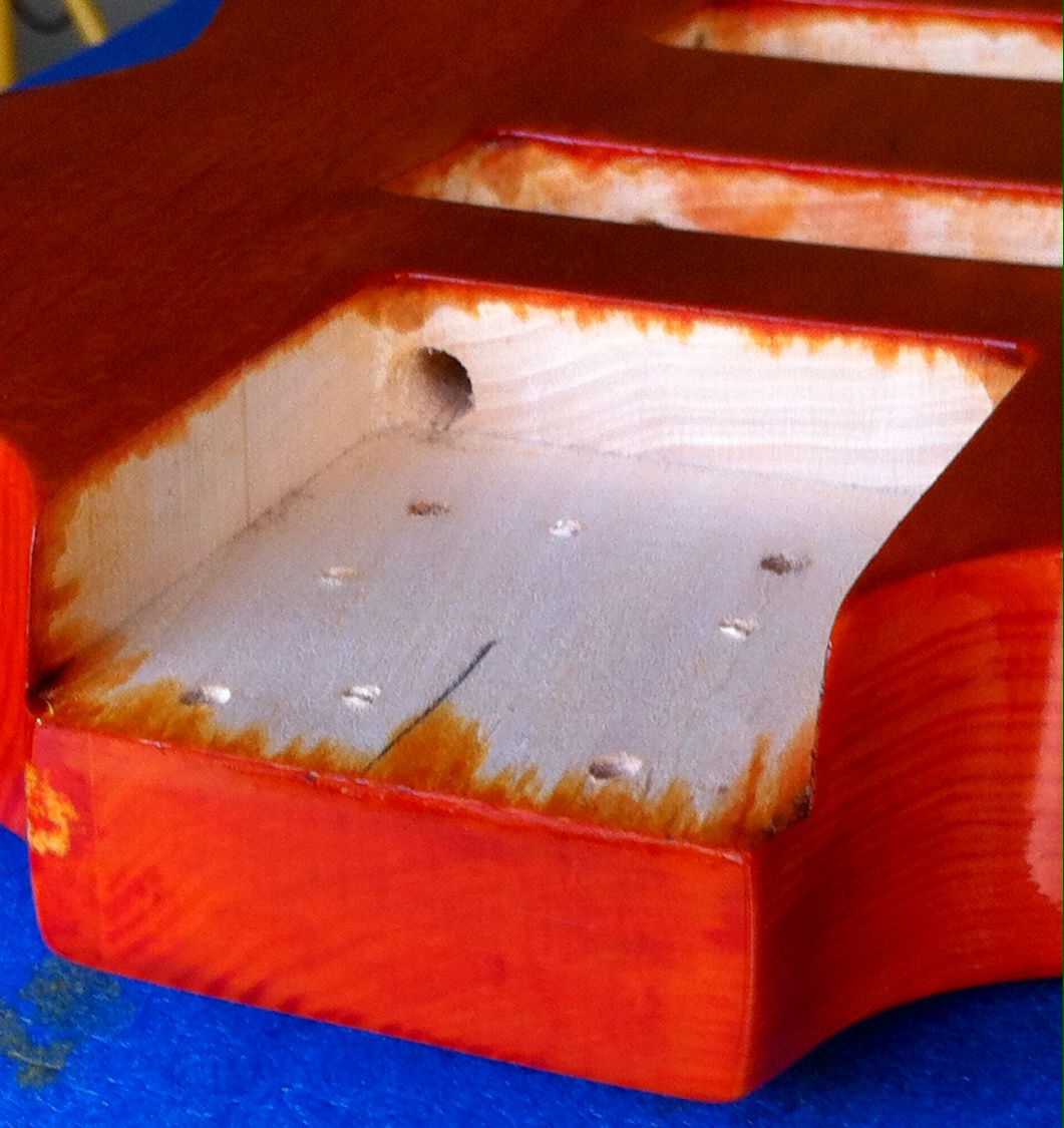

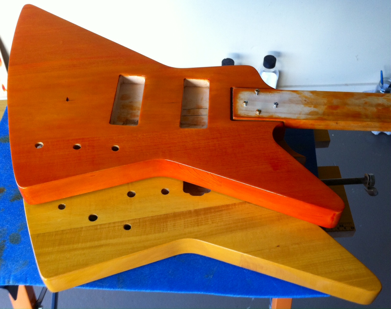

    Hi Folks, not sure how many people would contemplate building both Explorer styles and have attached some photos to show the slight differences.
    Other than one being a set neck 6 string guitar and the other a bolt on neck 5 string bass there are a couple of distinct differences.
    (1) Position of output socket which is a direct result of where the (2) control cavity has been routed, which in turn relates to (3) where controls are located on the top. Otherwise they are identical in thickness, shape, and bodies weigh pretty much the same.
ID:	7928Click image for larger version.
ID:	7929Click image for larger version.
ID:	7930Click image for larger version.
ID:	7931Click image for larger version.

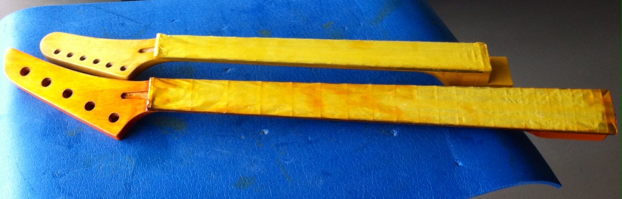

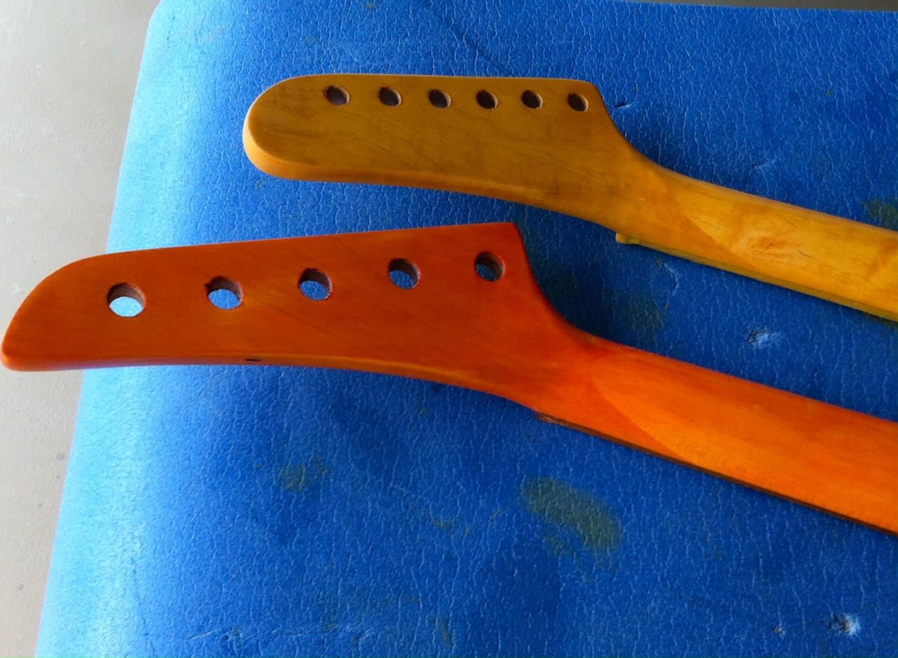

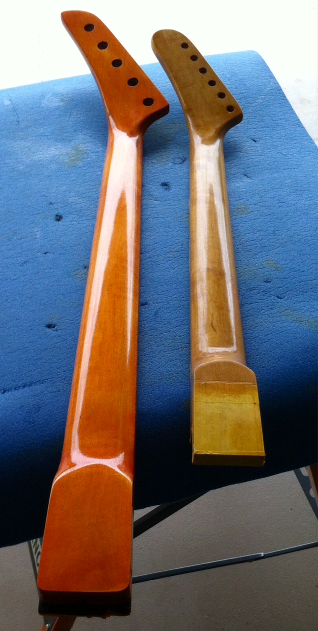

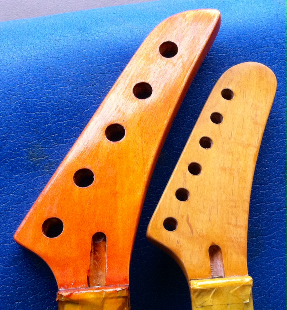

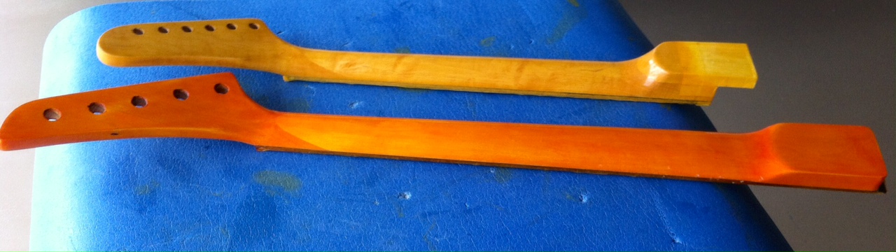

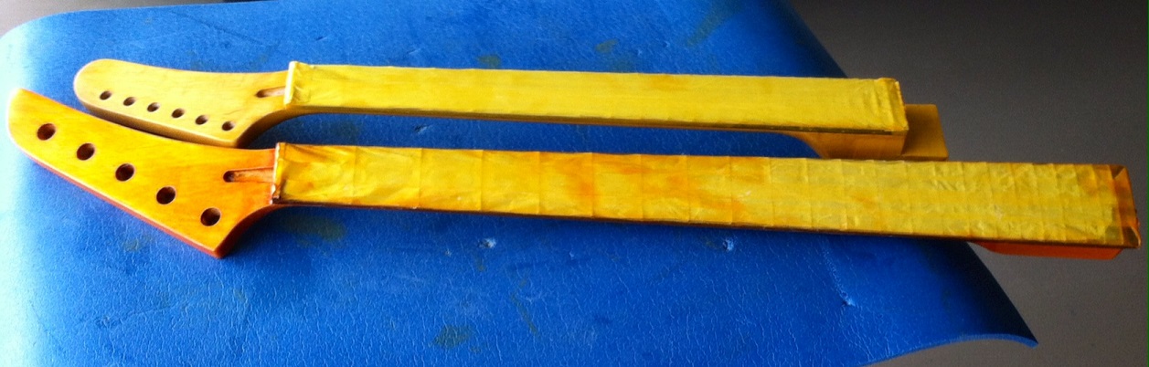

    Obviously where and how the neck joins the body and also the necks themselves are the glaringly obvious differences and will post photos of those tomorrow.

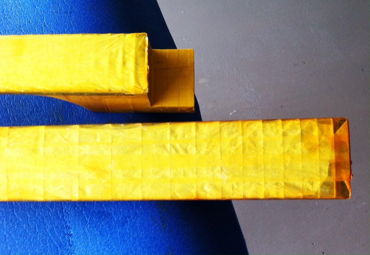

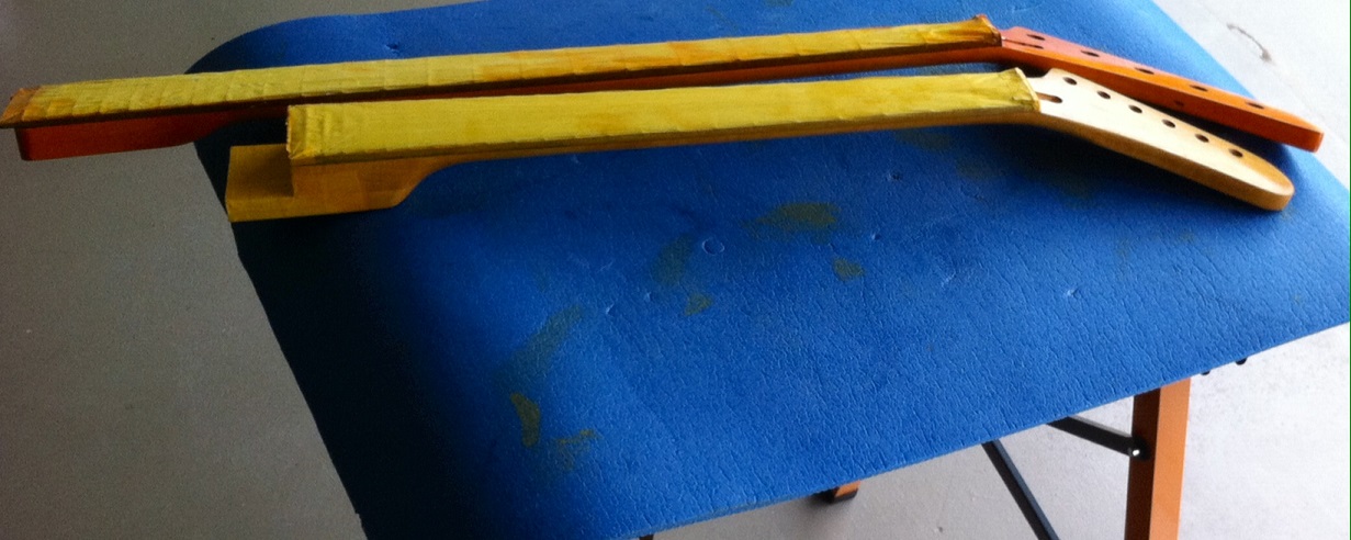

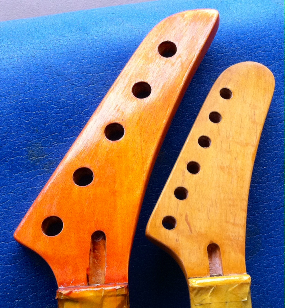

    Following neck shots have fret boards covered up as still finishing off but getting closer to fitting them to their respective bodies. Will post those shots as well to help show the differences.

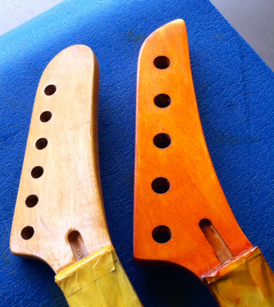

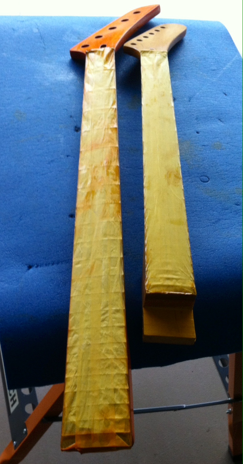

    In these shots the most obvious thing is the Bass neck being much longer as it has to accommodate 9.25" more scale length and surprisingly it is not too much wider across the fret board however it appears shallower with a slimmer profile compared to guitar equivalent.
    The pointy headstock is closer to original design on the EX-5 and also has more rake. Probably the only disappointing feature of the EX-1 is the standard headstock which is quite blunt and stubby looking, not as angular as the original.
ID:	7953Click image for larger version.
ID:	7954Click image for larger version.
ID:	7955Click image for larger version.
ID:	7956Click image for larger version.
    More neck shots.....
ID:	7958Click image for larger version.
ID:	7959Click image for larger version.
ID:	7960Click image for larger version.
    cool comparison, thanks
    nice comparison Waz, handy info for anyone thinking about either kit.
    They are both looking sweet as nice shine !
    Thanks for the info Waz. It's great to see your two axes side by side!
    Thanks Guys, hope to eventually show a bit more of them both side by side right through to completion. Maybe I am not the only one who thought about building both Explorers and hope this helps anyone considering either kit.

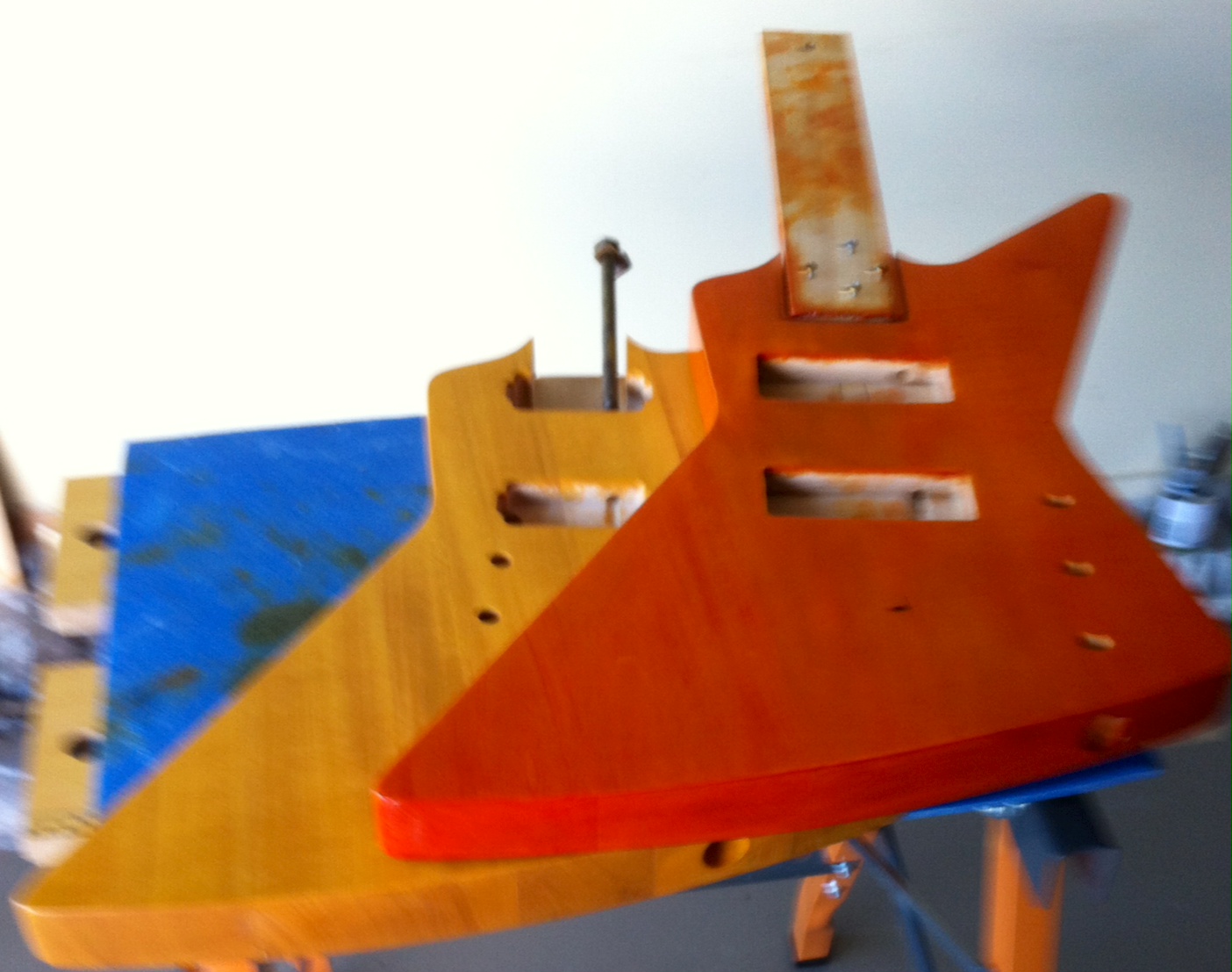

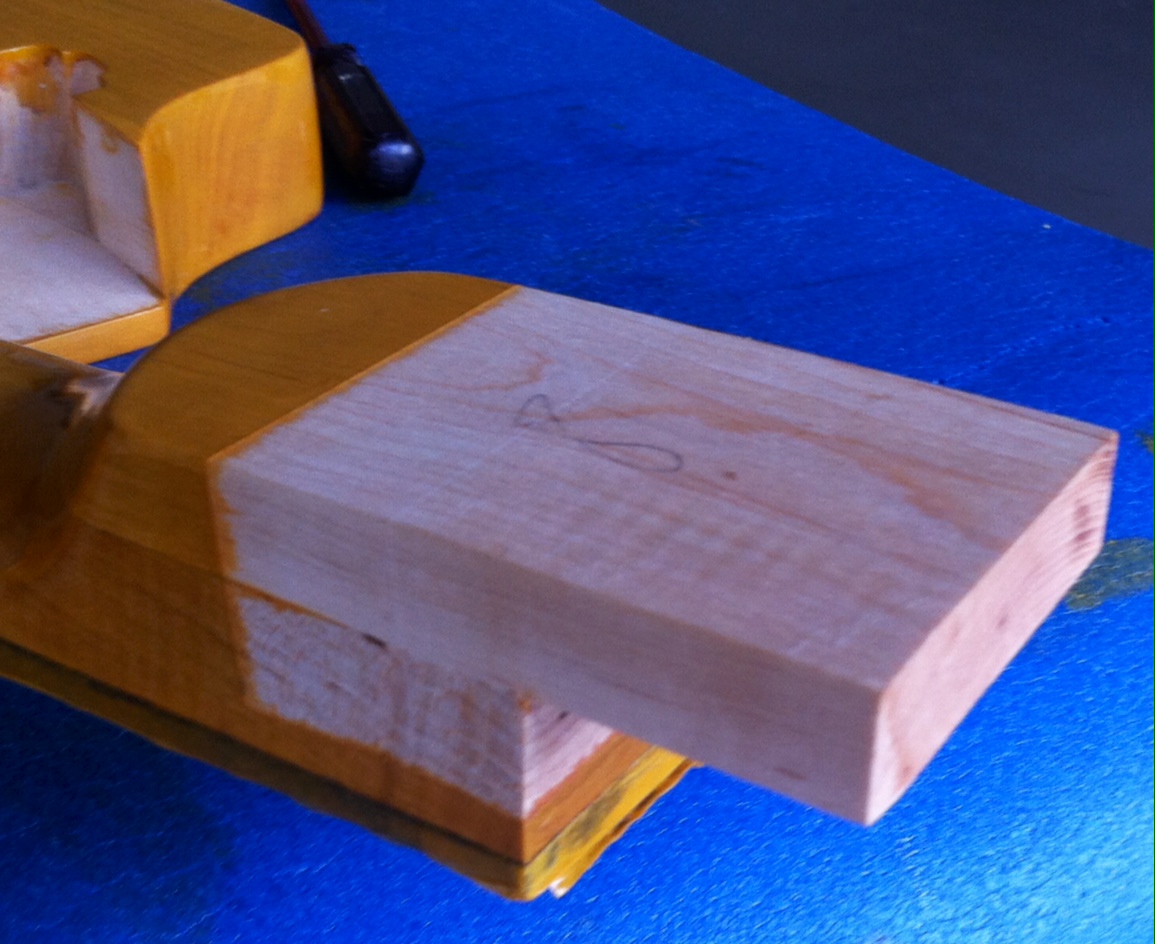

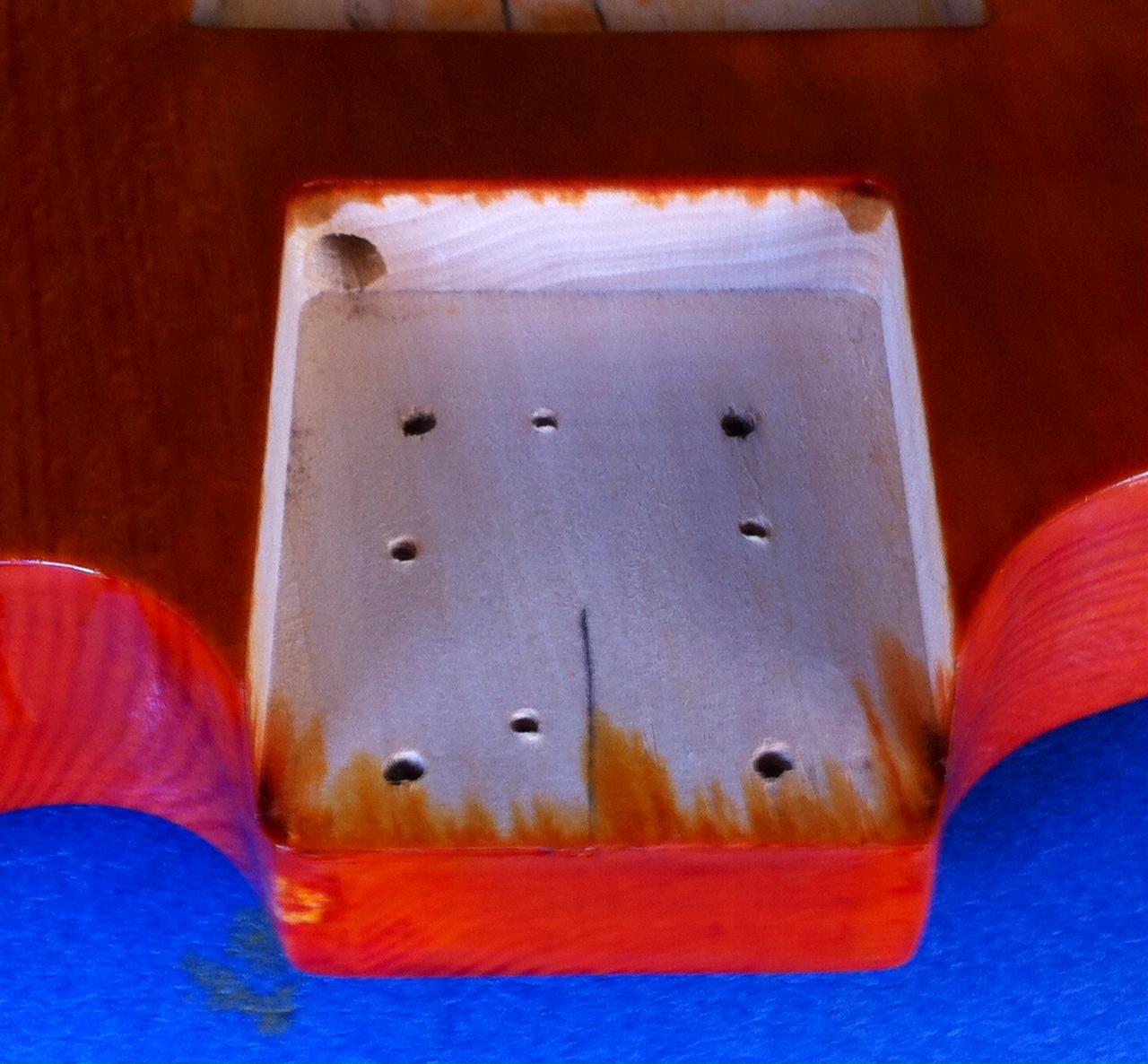

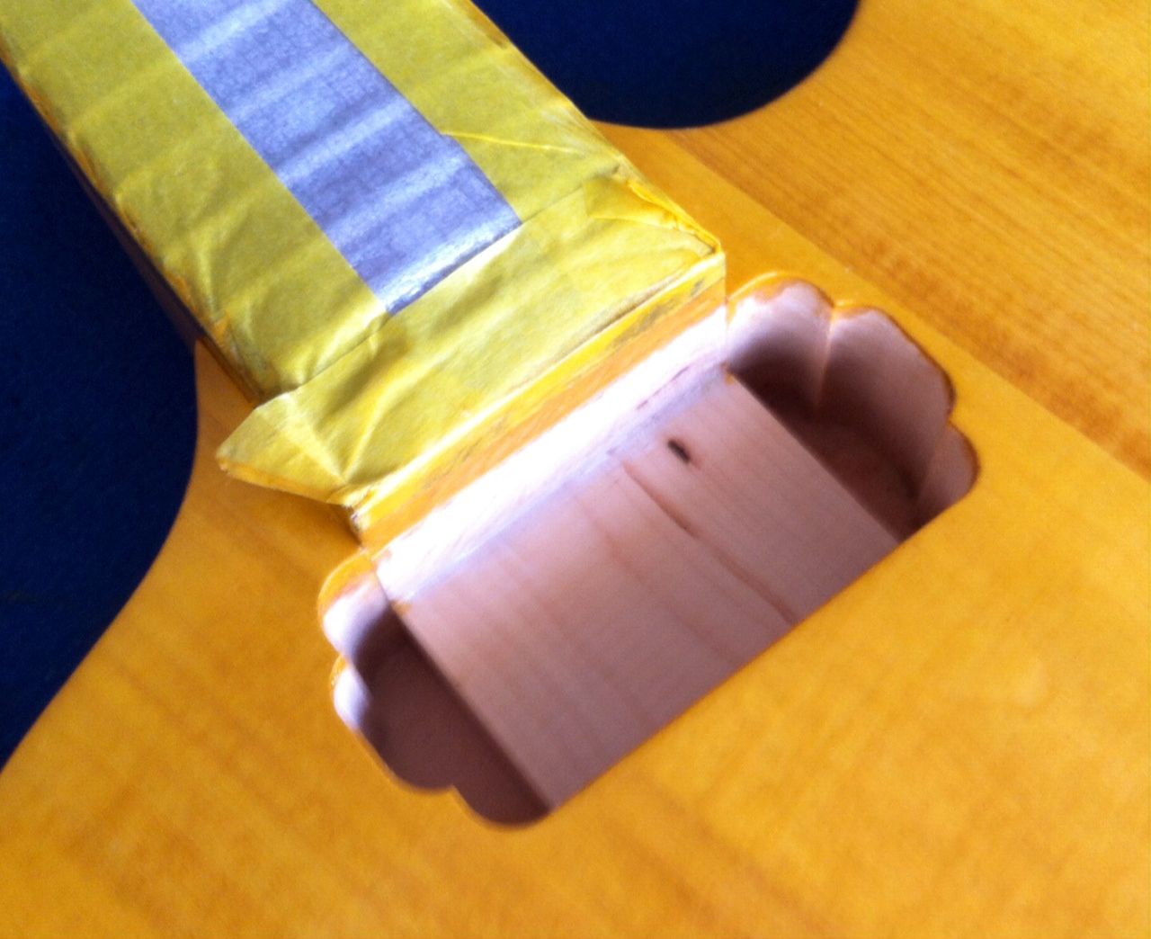

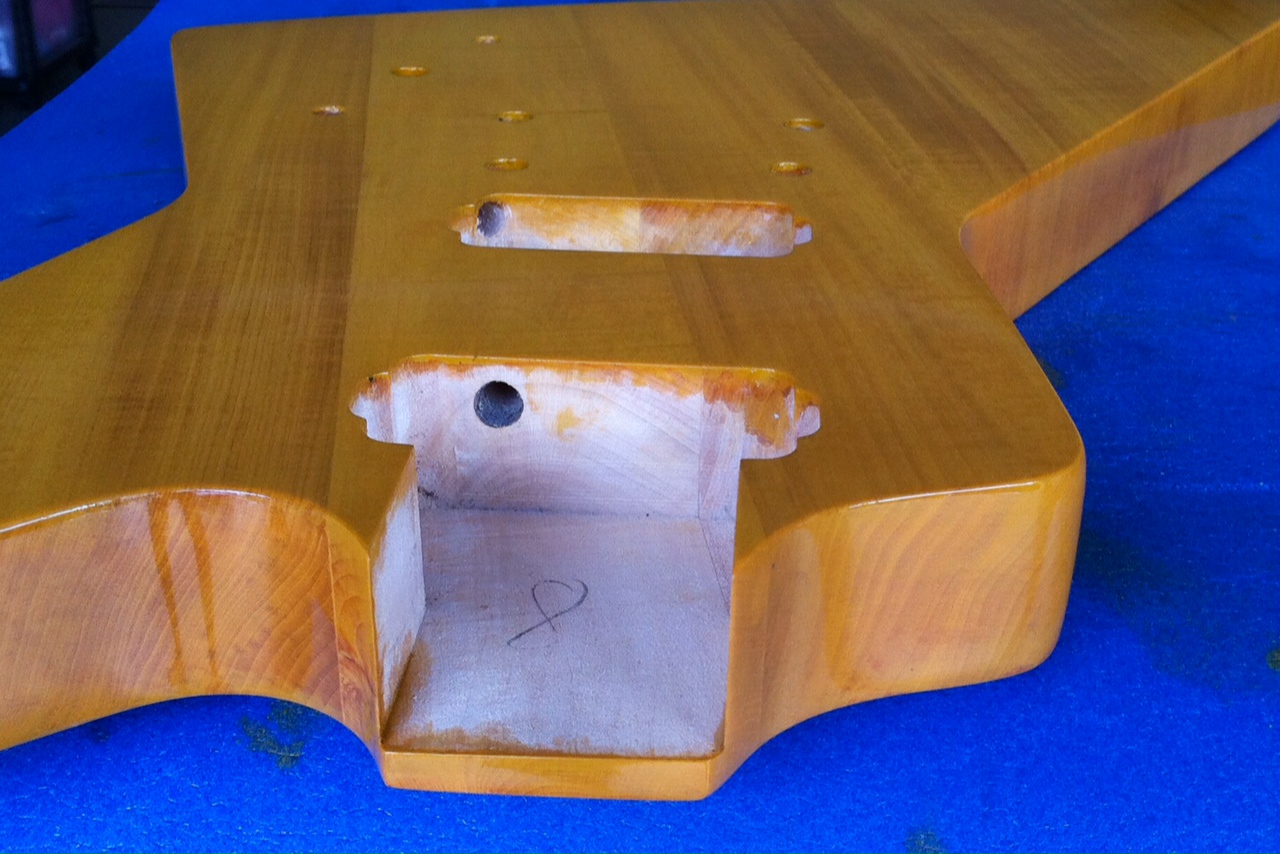

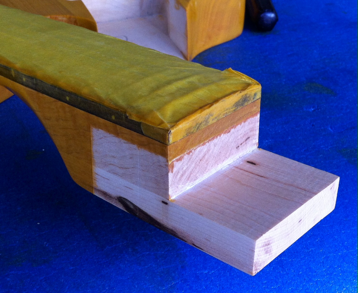

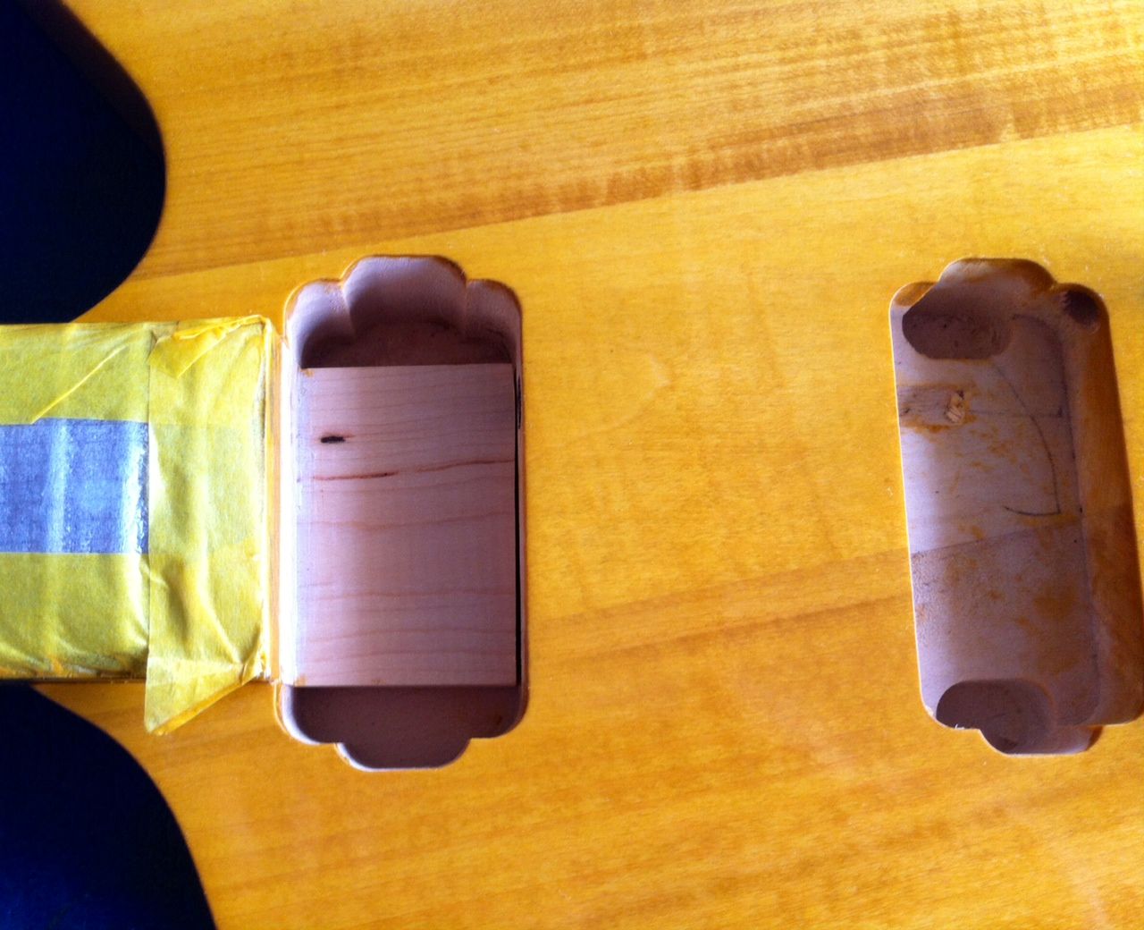

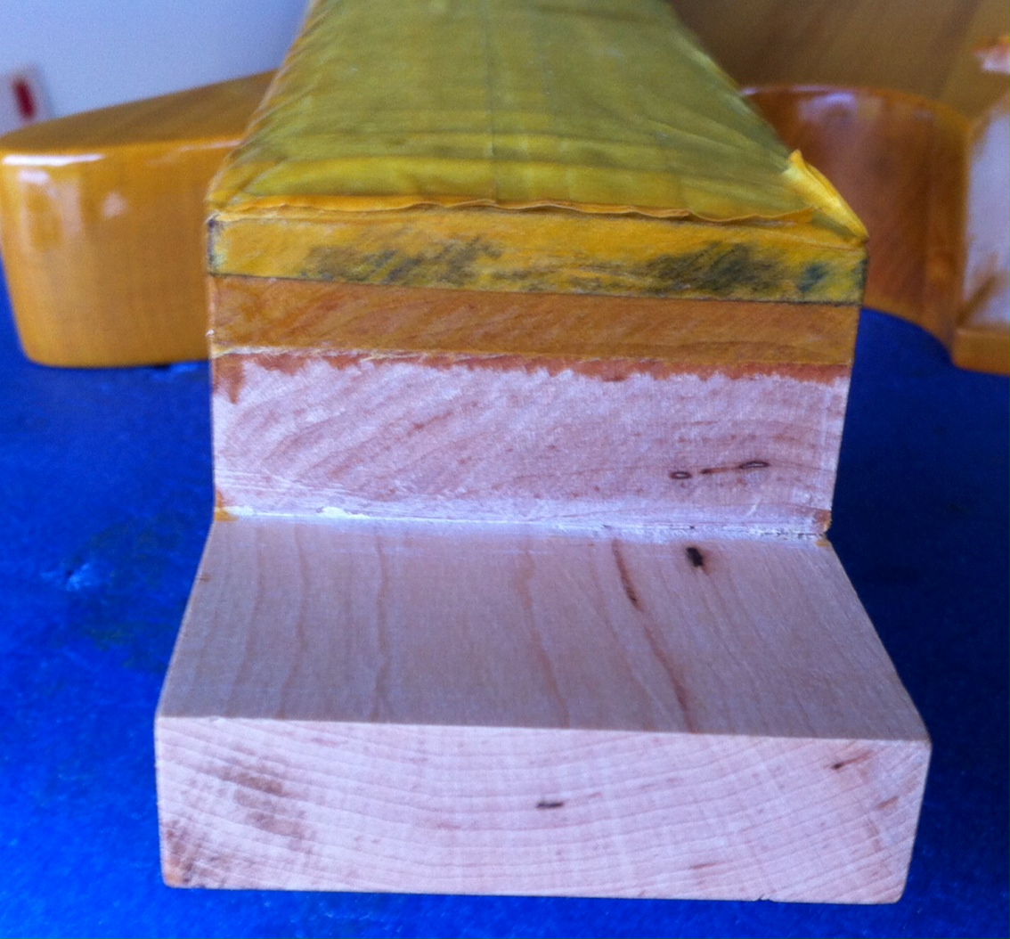

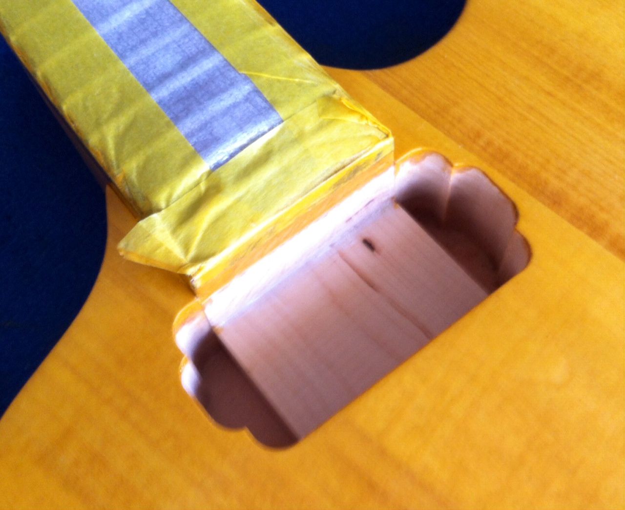

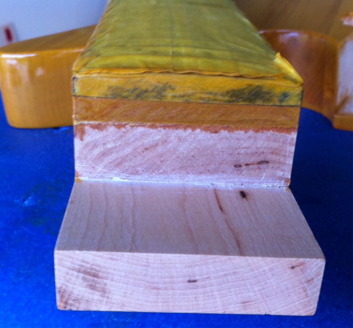

    Removed tape in readiness for attaching necks to their respective bodies and thought I would share pics of the neck ends that go into the pockets before they are permanently fixed. Plenty of shots......EX-1 Neck Pocket
ID:	8861Click image for larger version.
ID:	8862Click image for larger version.
ID:	8863Click image for larger version.
ID:	8864Click image for larger version.
    EX-5 Neck Pocket....
ID:	8866Click image for larger version.
ID:	8867Click image for larger version.
ID:	8868Click image for larger version.

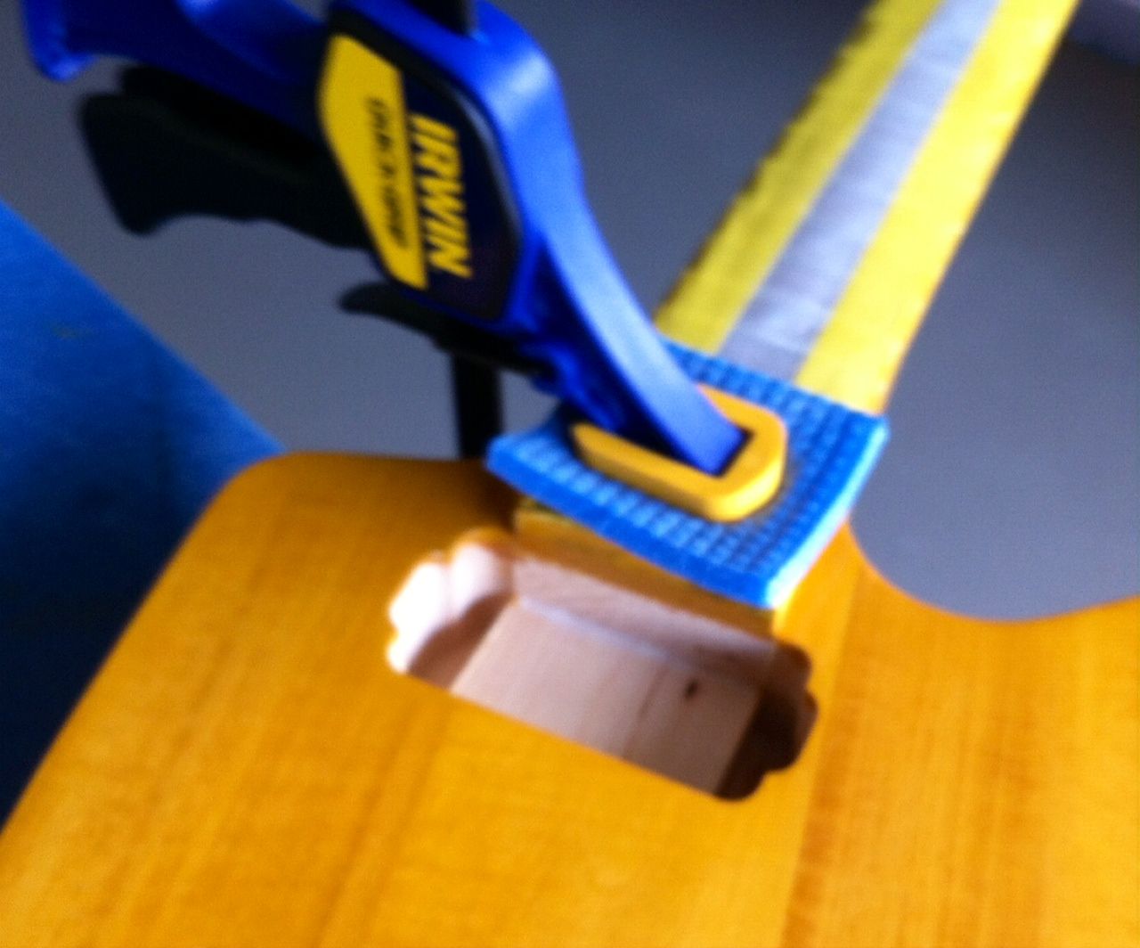

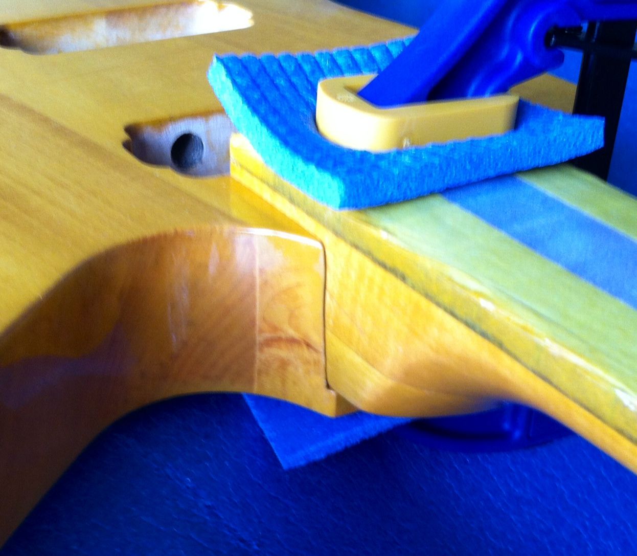

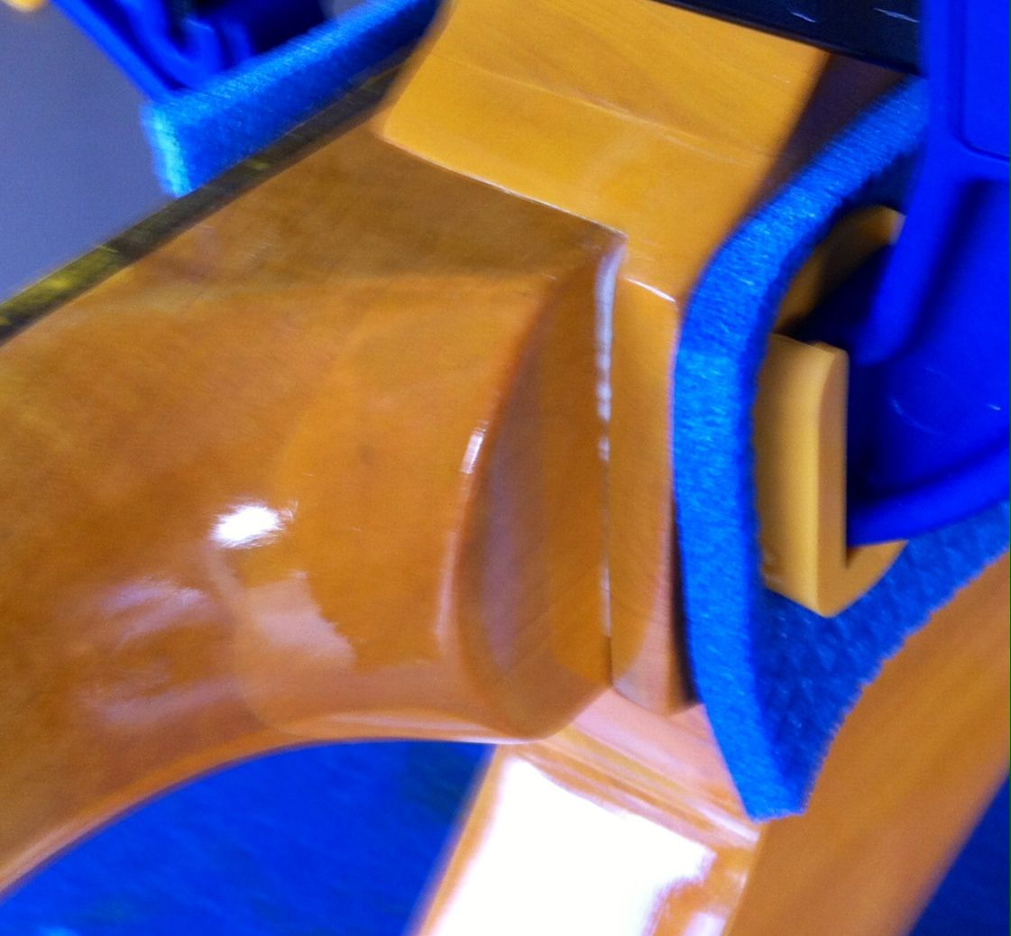

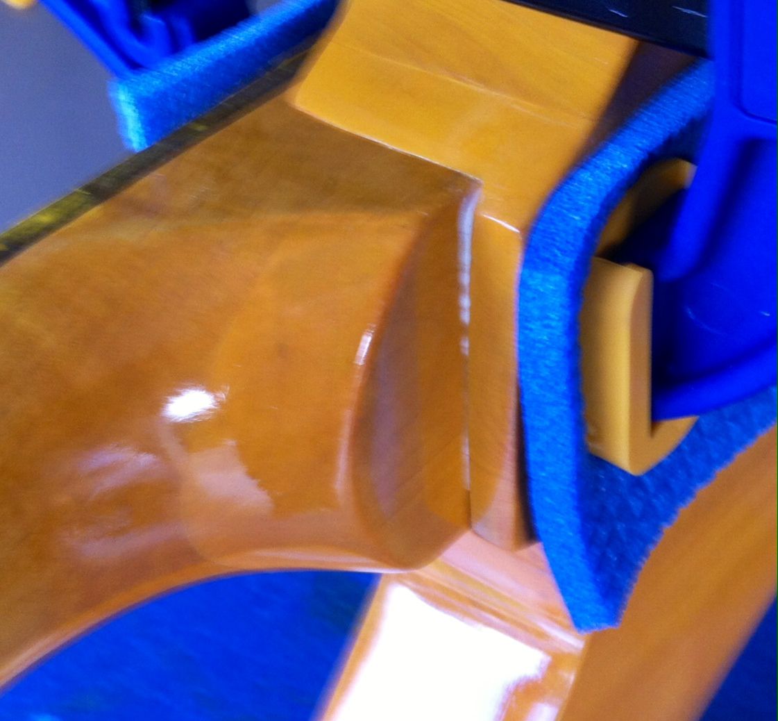

    EX-1 neck glued in....
Name:	photo neck glued in.jpg
ID:	8870Click image for larger version.
Name:	photo neck glued in 2.jpg
ID:	8871Click image for larger version.
Name:	photo neck glued in 3.jpg
ID:	8872Click image for larger version.
Name:	photo neck glued in 4.jpg
ID:	8873Click image for larger version.
Name:	photo neck glued in 5.jpg
