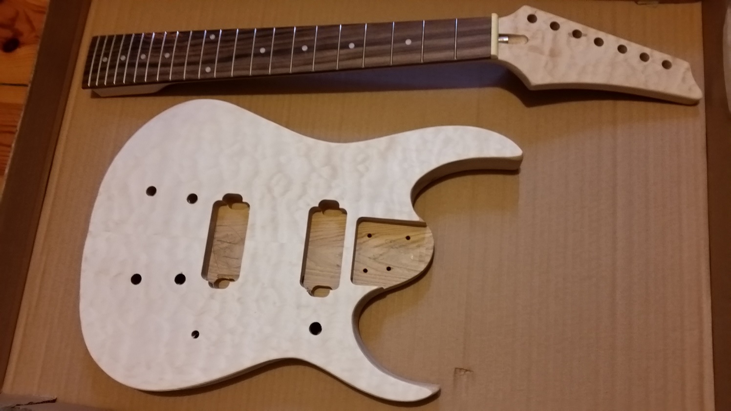

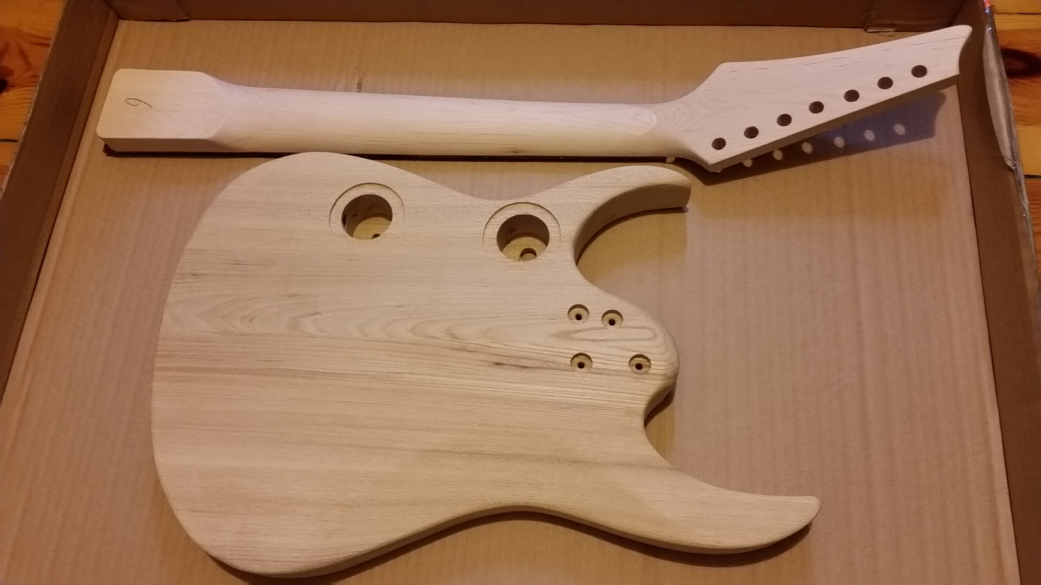

    Picked up this kit back in the August sale, bit of a bargain. When it arrived every thing seemed OK, no major issues.
ID:	7588Click image for larger version.

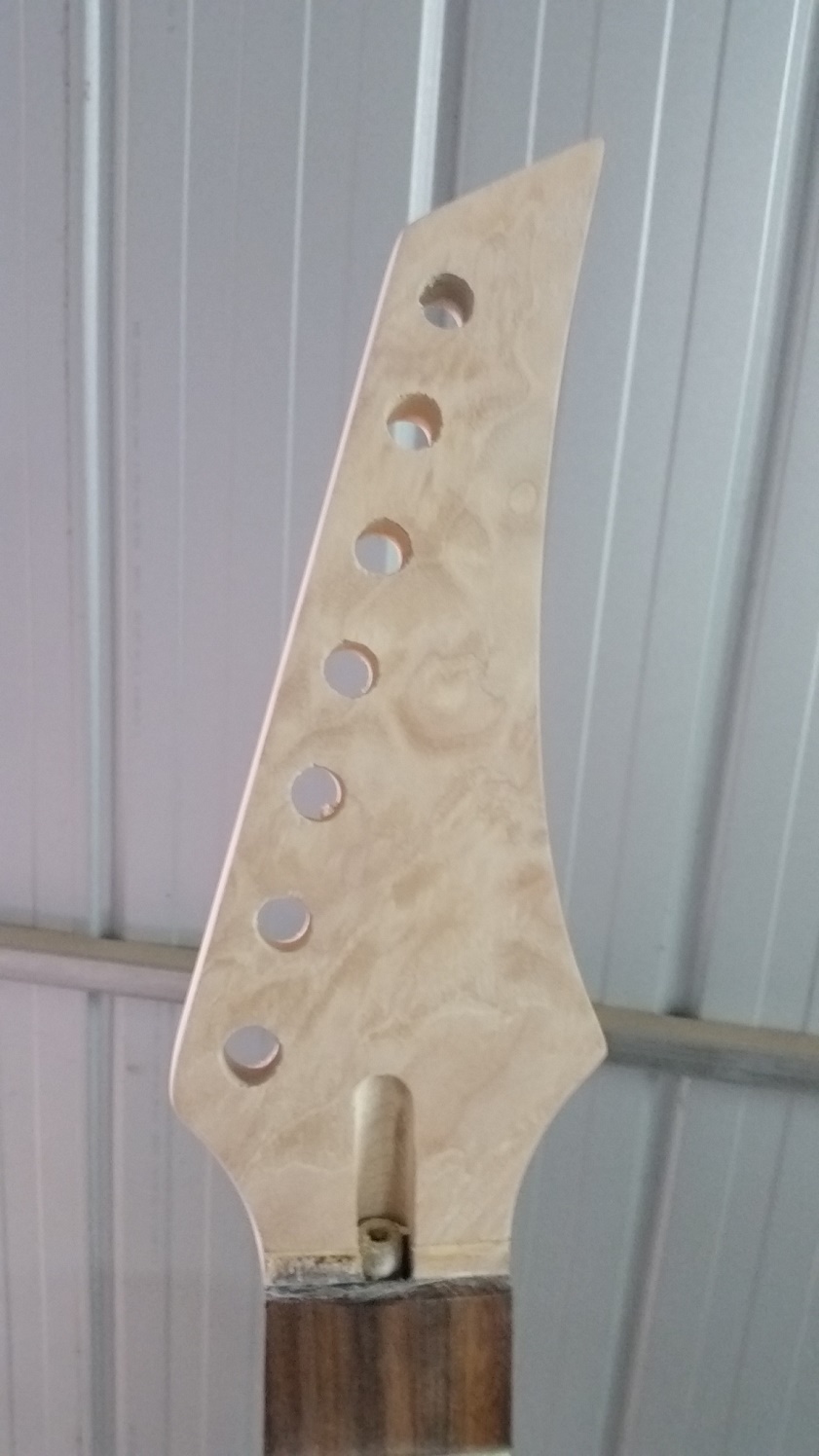

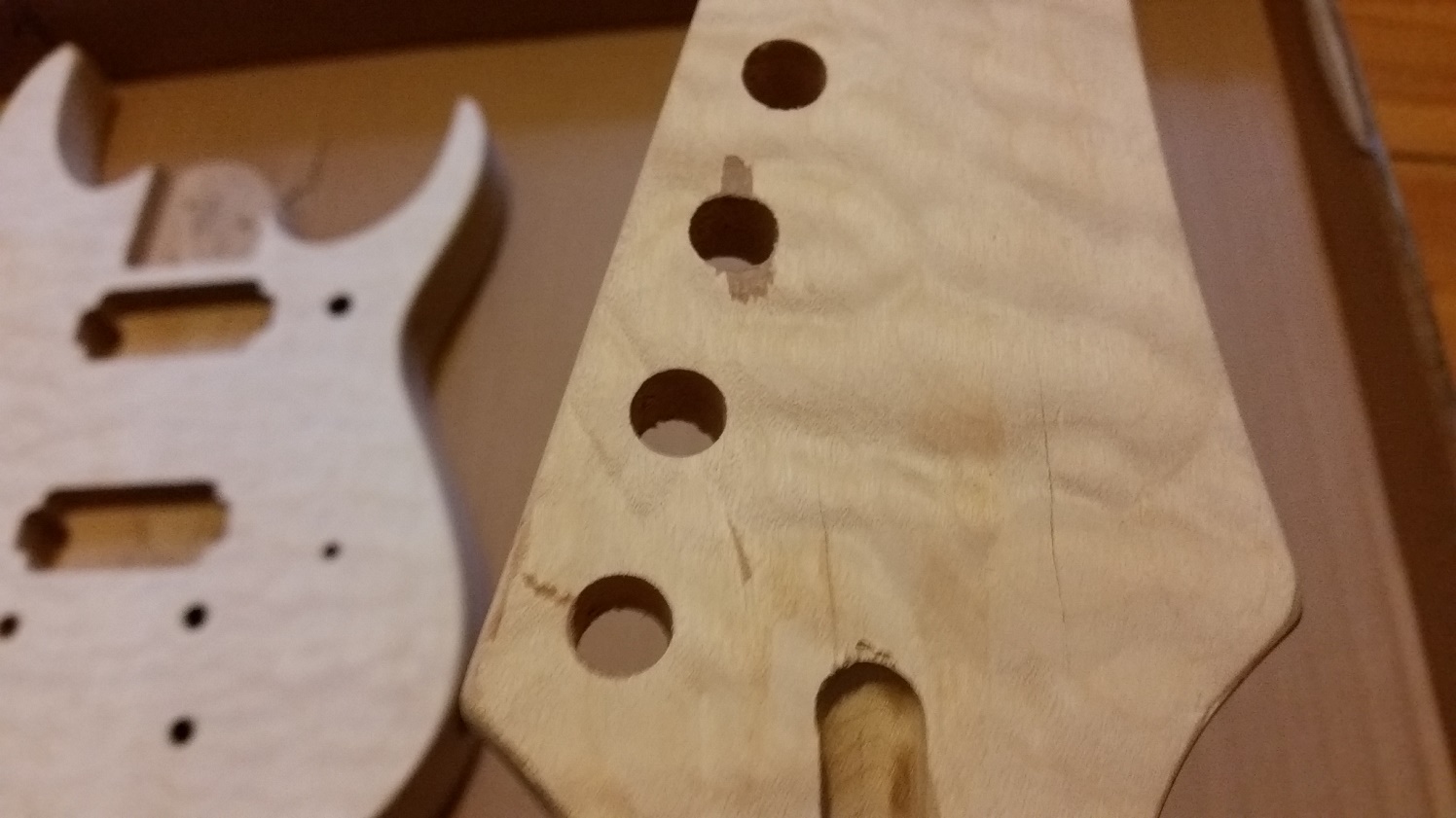

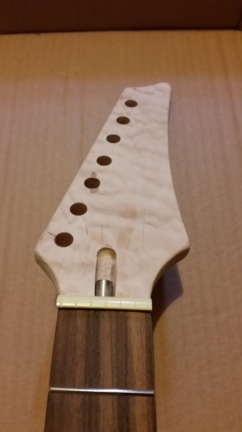

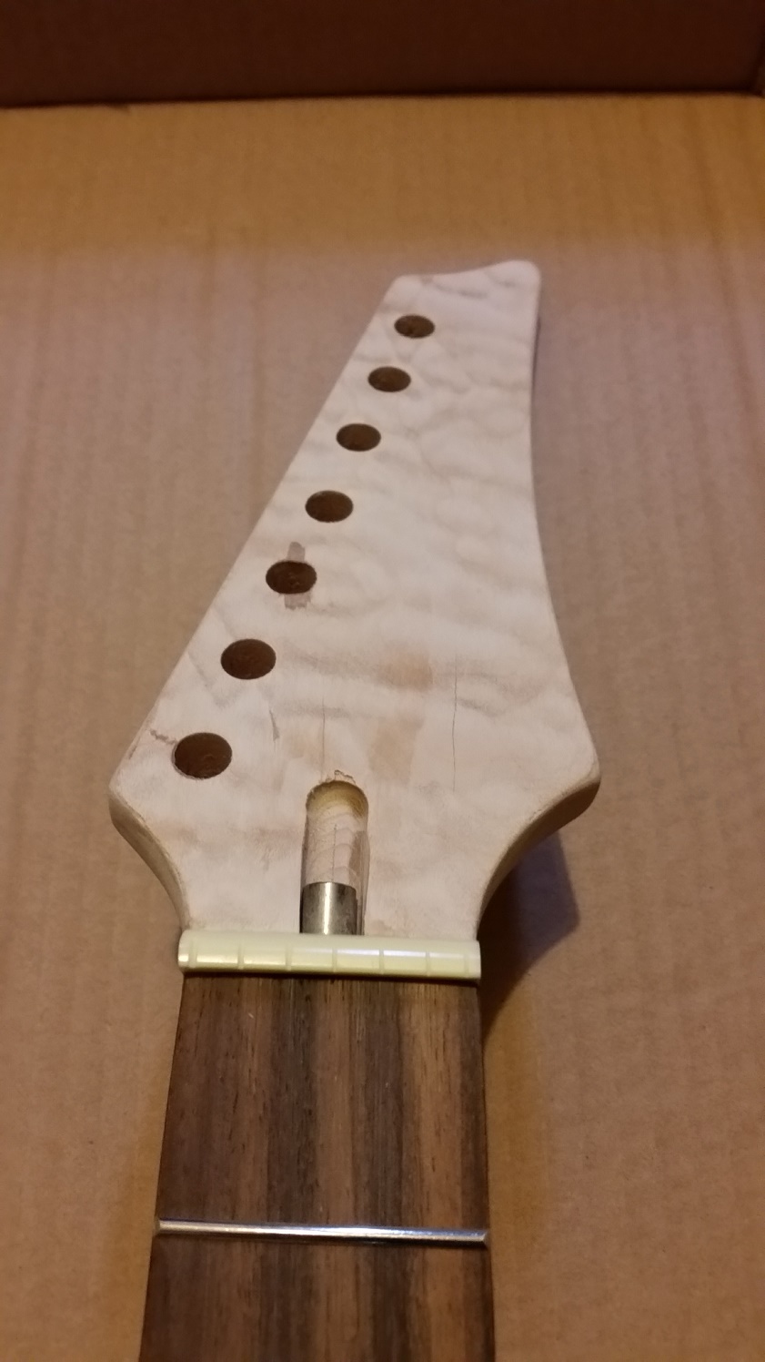

    Main reason I went for it was the quilted veneer. Unfortunately the headstock veneer had been patched up by the factory and was unusable.
ID:	7590Click image for larger version.

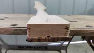

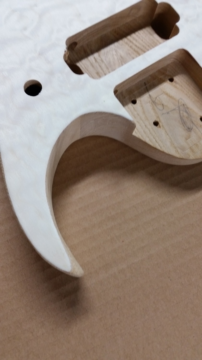

    They used I-don't-know-what to fill the tear out and splits and there was still an almost inch long split to the right of the truss rod rout.
    Also the sanding of the veneer around the edge of the body was a bit uneven
ID:	7592Click image for larger version.
    This was taken care of by carefully sanding the edges of the body with a sanding drum to bring them back to the veneer edge.

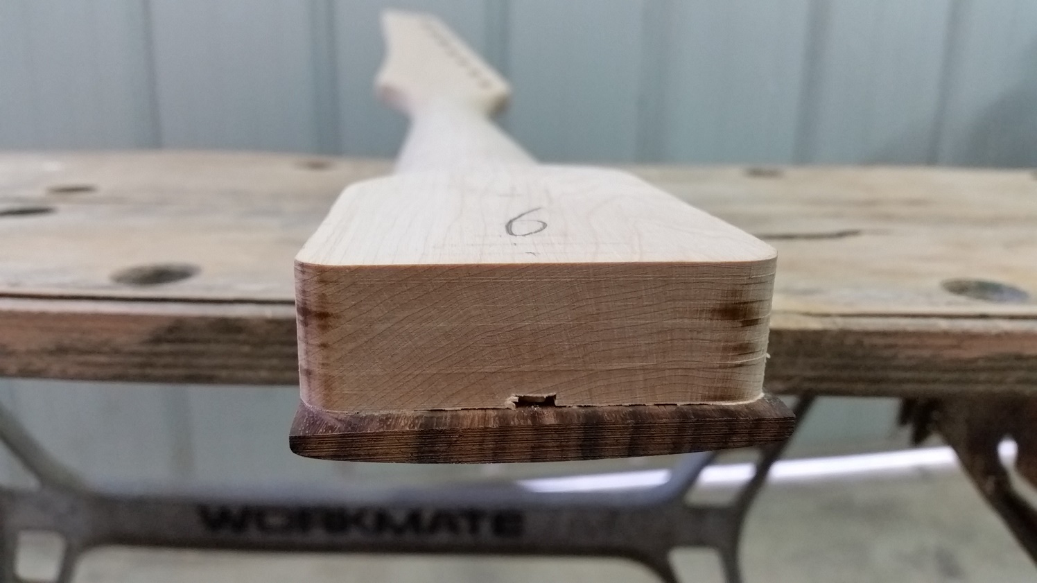

    Looks like the truss rod is trying to escape
    Don't think it will be a problem (please correct me if I'm wrong).

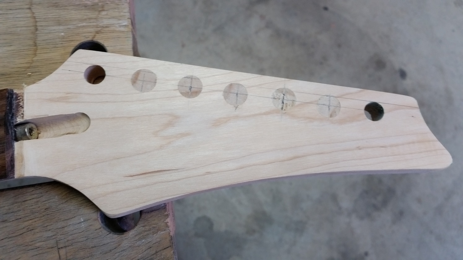

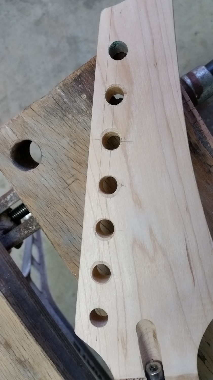

    First step with the headstock was to remove the veneer, came off pretty easy and sanded to tidy up. Thought I might as well straighten up the tuner holes, they weren't quite in a straight line. Dowelled up and redrilled.
ID:	7595Click image for larger version.
    Hi Grant, I almost bought this axe last August but you beat me to it. I ended up getting an ash 7 string Iceman which I've started.
    Some nice looking grain on the quilt top and ash on the back.
    Bummer about the headstock veneer, you will probably have to sand it off and glue another veneer on. The truss rod bolt looks proud, see if you can push it back under the nut.
    Also be careful if its from the same factory as the TL-1Q the quilt veneers are paper thin.
    What are the build plans ?
    EDIT saw your second post, nice work plugging and re-drilling tuner holes, looks much straighter the tuner holes

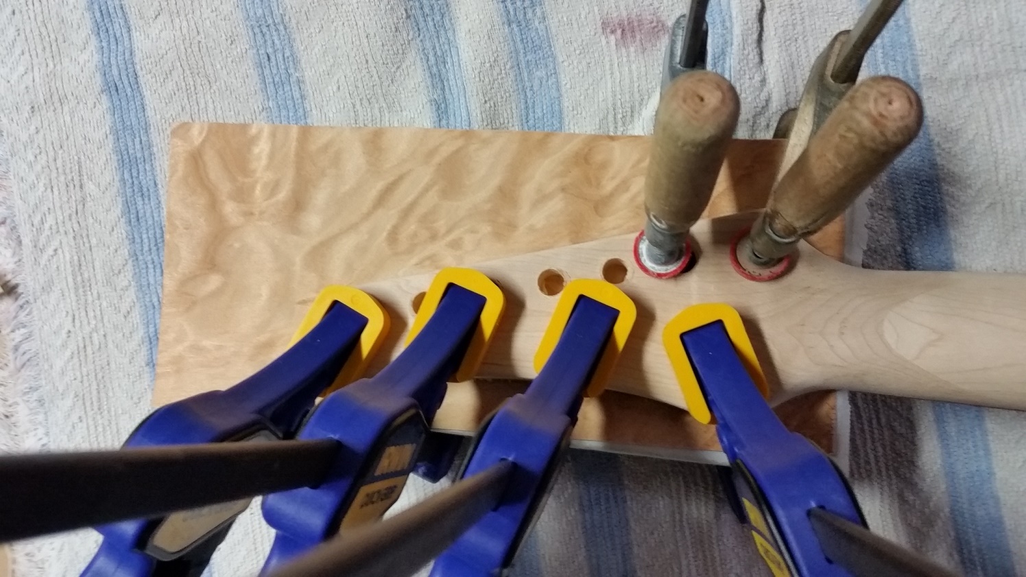

    How many clamps can you fit on a headstock?
    Probably should have cut the new veneer to shape before glueing, but got a bit excited. The reshaped headstock with its new face

    nice fix Grant, where did you buy the quilted maple veneer ?
    Makes it easier to roughly trim the shape of the HS before gluing but you cleaned it up nicely.
    I usually get about 10 clamps on a 6 string HS but when the rough shape is trimmed you will get more than six on
    Hi Wokks, looks like a few people tried to grab this one, must have clicked the mouse a just the right time. Tried to get the 12 string RC but didn't type fast enough.
    That was a tongue-in-cheek question about the clamps, these were all the small clamps I had.
    I bought two quilted maple headstock veneers from guitarAust, about $8 each I think. Got two in case I stuffed one up.

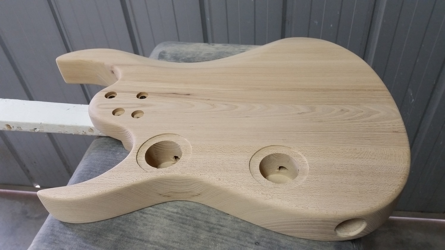

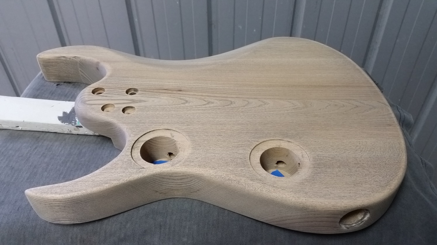

    Body sanded to 320
    Grain filled with ebony Timbermate to exaggerate the grain

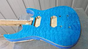

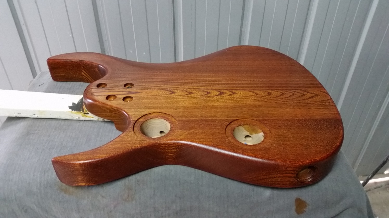

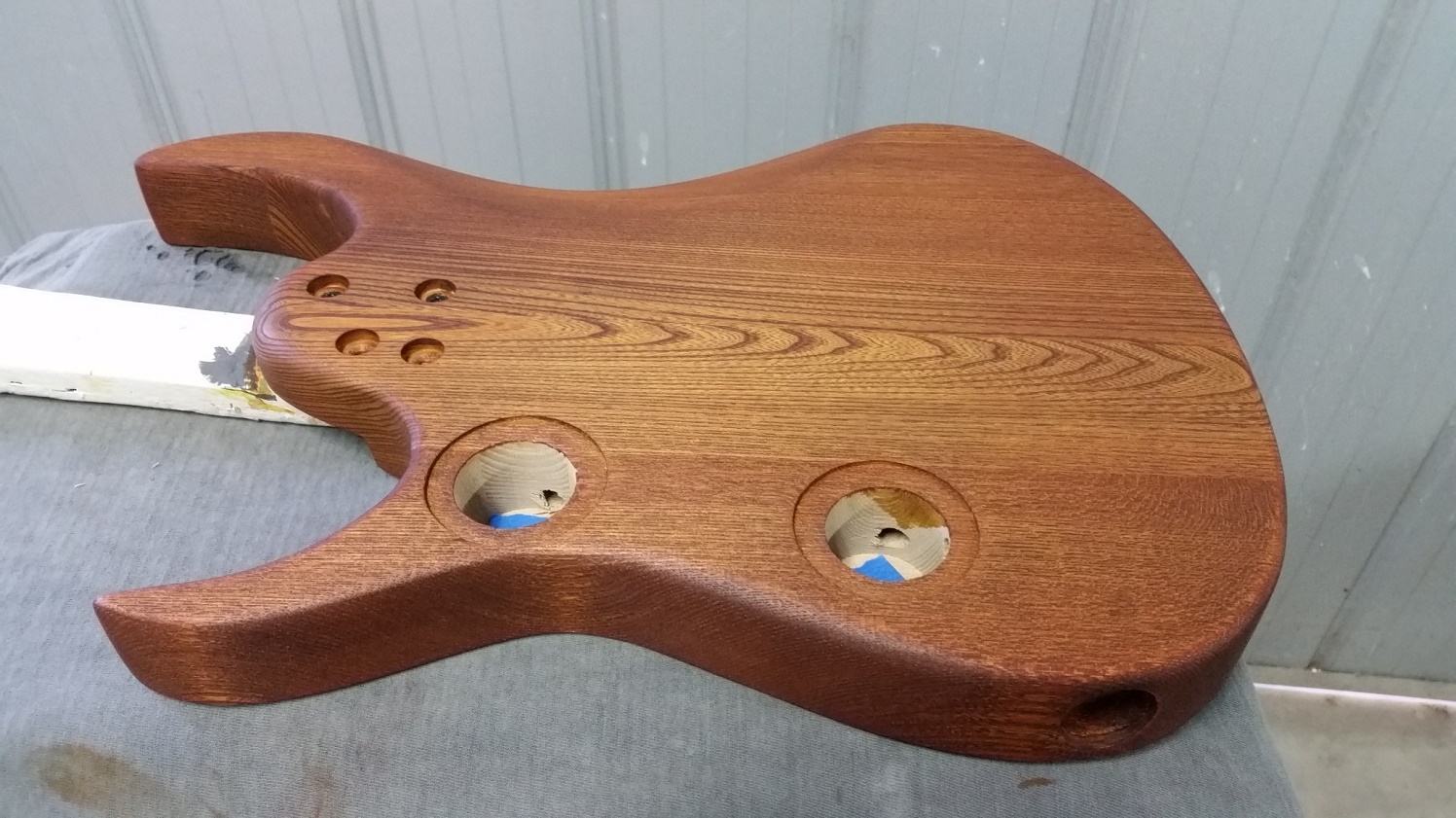

    Then made up a witches brew of colortone stains. Started with vintage amber, added a touch of medium brown, lemon yellow and a drop of cherry red, reduced with a little metho.
    Two coats of sealer
    Had to put more coats on than intended because the grain fill took on a green tinge. A bit darker than planned, but still looks Ok to me.
    wow love the colour Grant, well done. I did the same with my ash IC-7 grain filled with ebony Timbermate and it really brings out the ash grain nicely.

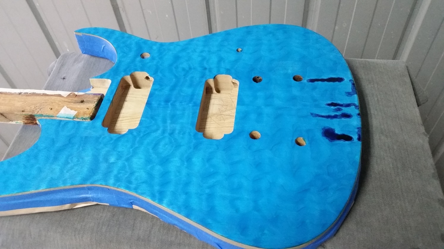

    And now the body veneer.

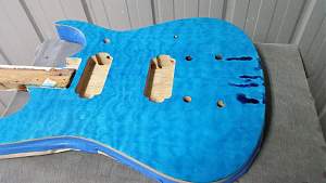

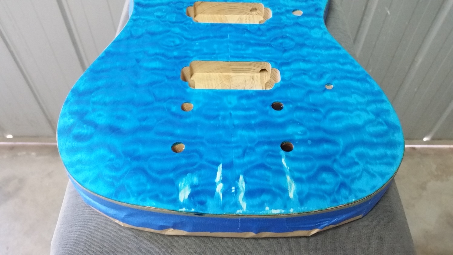

    After reading about how thin they are I was already a bit wary. There were some sanding scratches on the arm cut and some more by the horn on the same side. Very carefully sanded with 400 to remove as much of the scratches as I was willing to.

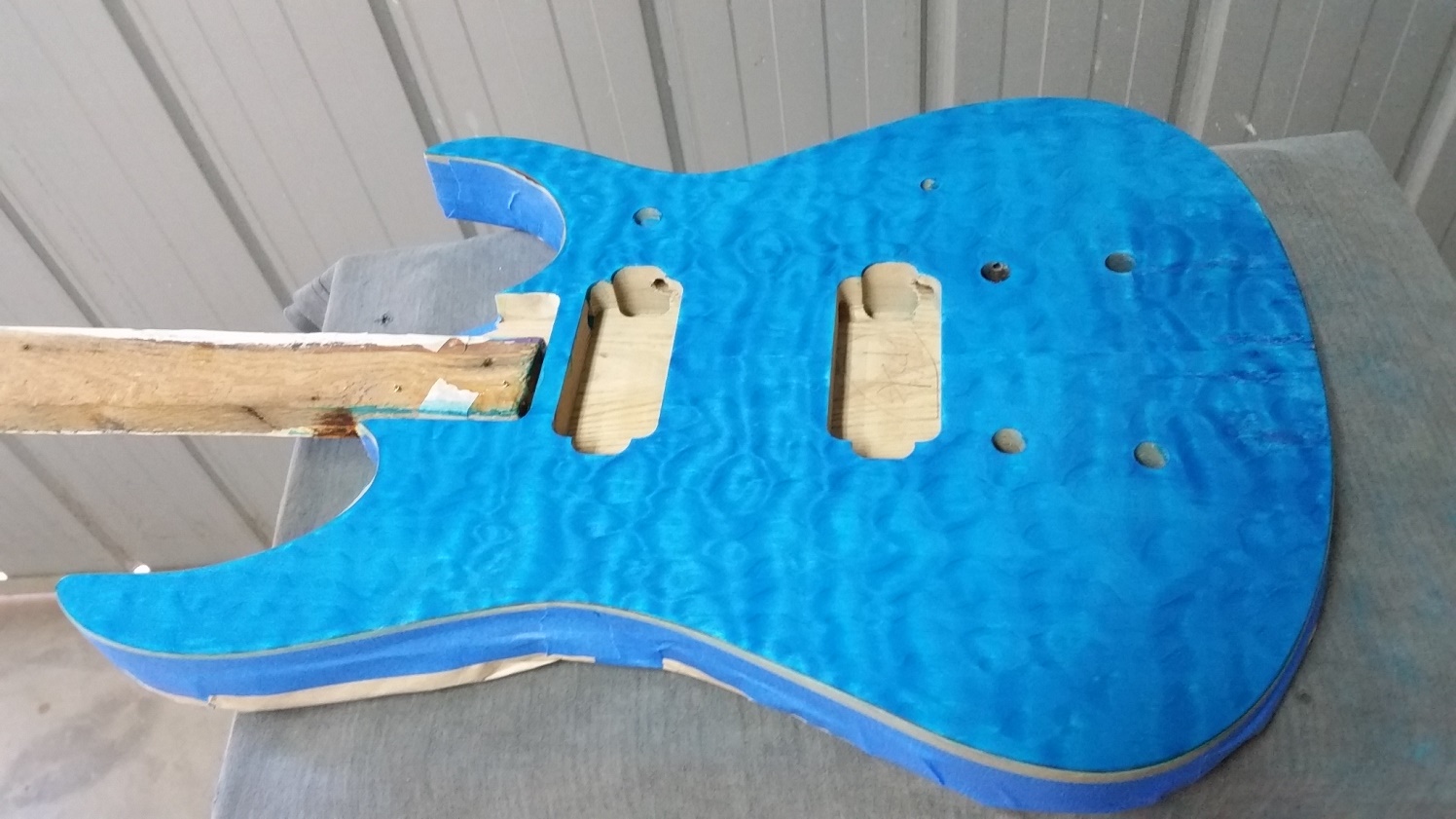

    Don't have all the colortone stain colours, so got hold of the Ubeaut stains for the front. Wanted to pop the grain, diluted the blue with water and put on the first coat
ID:	7603Click image for larger version.

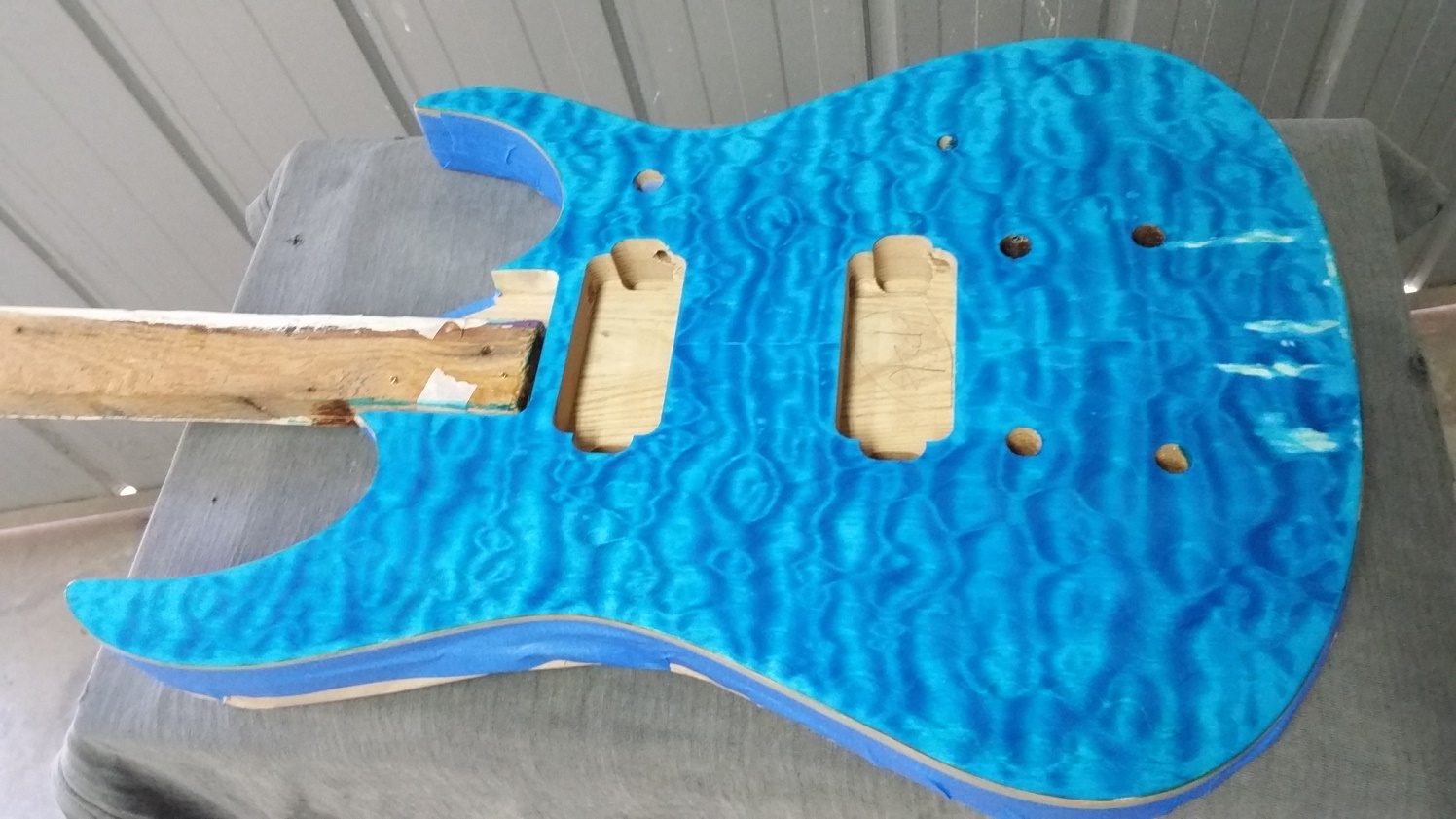

    To say I wasn't impressed would be an understatement. The left-most glue mark was visible on the raw veneer but it looked like part of the quilting, the rest were a complete surprise.
    Unfortunately (fortunatley?) Pabs had a similar problem with his TL and Weirdbits offered a possible solution of pin pricking and restaining with a cotton bud. Tried this, I did it a touch heavy handed, but heading in the right direction.
ID:	7605Click image for larger version.
    The original plan was to try a PRS style fade. Now will have to rethink the colours as the bottom edge may need to be almost solid colour to hide the marks. I'll keep playing with it and see where it ends up.
    love the colour Grant but that's devastating the glue. Can you just go for a darker blue burst around the edge similar blue to the bottom edge ?
    can't beat the look of blue quilted maple, looks like a swimming pool !
