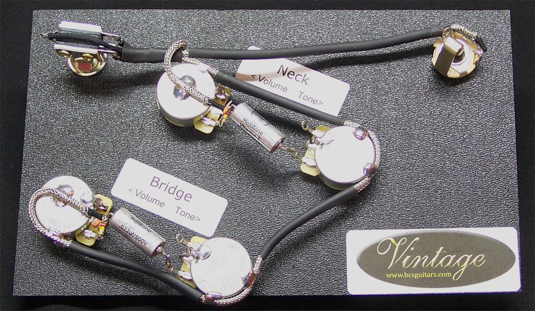

    thanks brendan, , i'm thinking (hoping?) of using a set up similar to this.
    I'm guessing with the braided wire that the braid acts as a ground, which means i don't need to add the extra wires between pots as shown in the pitbull diagram?
    Also i've noticed that rather than connecting the capacitors between the output and ground of the tone pots as in the pitbull diagram these are connected between the volume/tone pots for each pickup. Is there any advantage to this?
