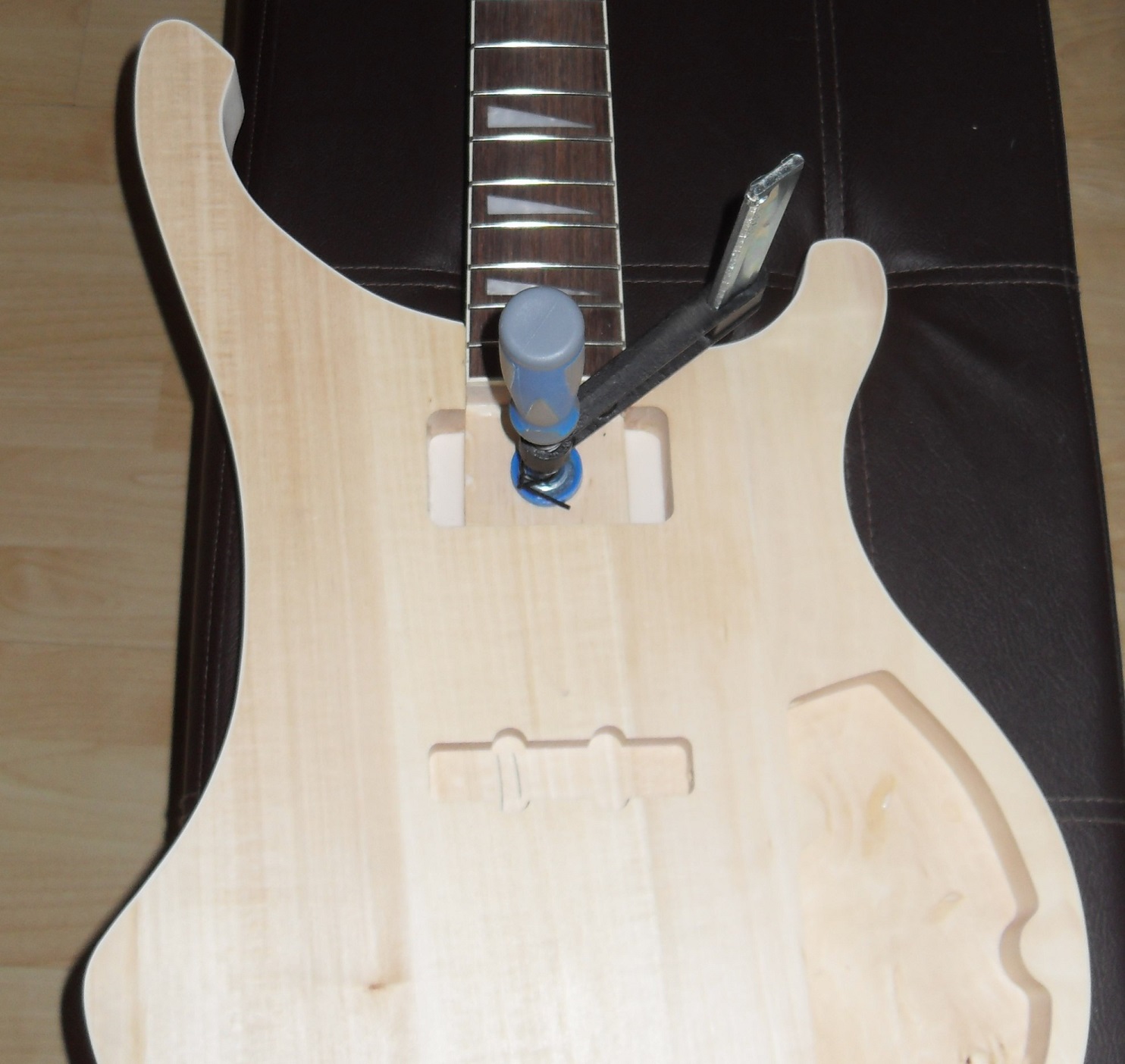

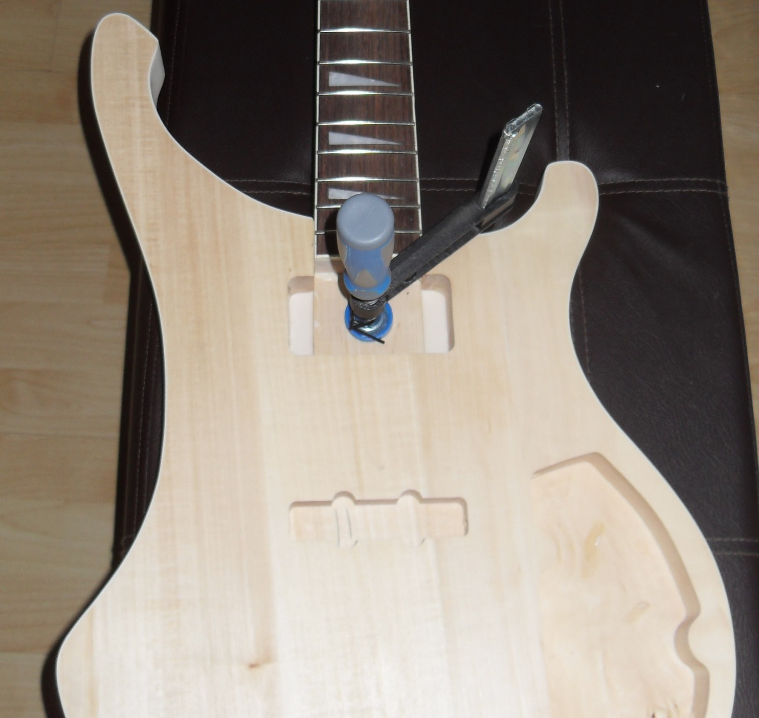

    Update, well spent best part of yesterday sorting out my attic or trying, the wife has used it as a dumping ground, so as it will take another weekend to clear enough space to even see the area i want to build a work bench i have made a start on my guitar by setting the neck, carried out a dry run using a clamp to hold it firm, checked the rake using my metal straight edge. Happy with the look i applied the titebond and reset the clamp checking on the rake again before leaving to cure.

    A few photos
Name:	SDC17932 - Copy.JPG

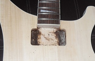

    Photo of neck set, extra glue into the wells either side of the neck for my home made hardwood filler, saw dust from a hardwood this happens to be walnut, mixed with Titebond into a paste and built up allowing each layer to dry, this should give the neck more stability.

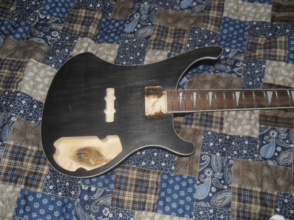

    Photo of last mix of filler, leave it to set hard.
    More supplies arrived, micro fine rubbing papers, masking tape and various wood dyes, still unsure of the colour i want, it looks so good in its natural state but i feel it needs darkening. I am toying with the idea of doing the top black edge into colour burst and same on the face of head stock with a black ebony sides and back, this all of course depends on how well the wood takes colour.

    nice one Paul so you set the neck very early in the build. Have you done any sanding yet ?
    Will be more awkward to work on being one piece but the neck/body transition should be smoother.
    The neck pickup with that putty make sure the neck pickup fits, you may have to drill out a section for the mounting screws
