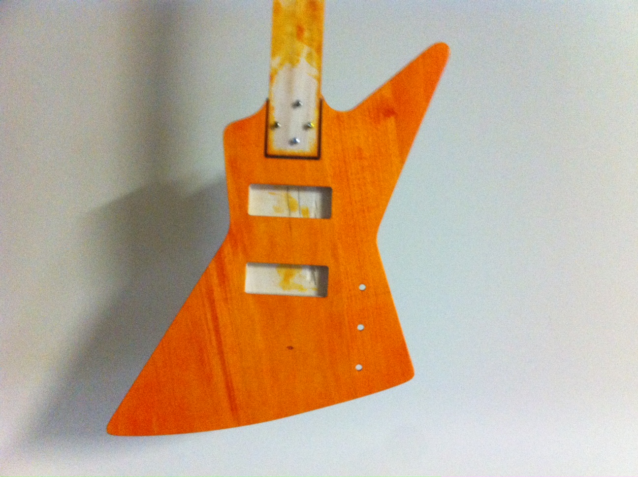

    Hi DB and all other GAS megagods. You may recall I was the one who experimented mixing up various brews of Outback Sunset & Coolangatta Gold with end result shown below being 1 part OS to 3 parts CG. I have done the same mix with intensifier coats and wondered whether top coats contain any tint as the OS one looks ever so slightly darker than the CG one? Just wondering does any of the top coats have a smidge of base coat in them just in case I have any left over and want use on another kit without stuffing things up? Looking forward to your advice, Waz.

    Hey Waz from experience the top coat will darken the colour a little but there shouldn't be any colour or tint the top coats.
    DB will confirm when he reads it

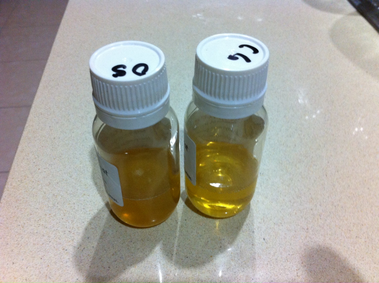

    Thanks Wokka, expect top coat should be same across all stain kits however the OS one is just a bit darker. Will take a photo and post shortly.
    no worries Waz, I notice the top coat colour varies a bit so it may be a slightly different batch (older or newer) maybe why the colour varies a bit. I'd use the lighter colour top coat to be safer

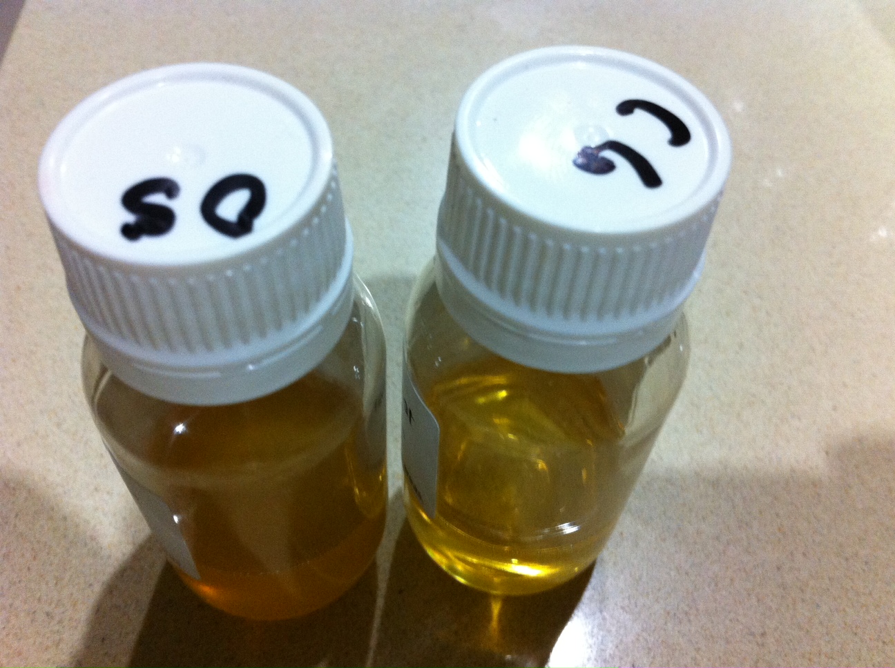

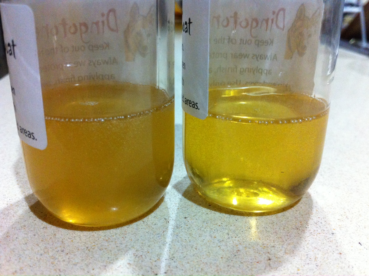

    Here are the photos. OS is the on the left and looked a little cloudy when just picked up. Gave both a shake to mix em up a bit and OS still looks darker. It came with the kit in August and CG arrived separately in September. Another question, does colour vary between batches as I have just received another unopened box of CG for my next build?

    Hey Waz,
    There will be some variations due to different batch of oils I get, however they will dry clear and shouldnt affect the colour too much.
    You can always mix the two finish coats together to get a consistant finish.
