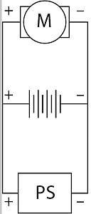

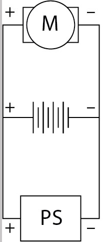

    Hi Moose,
    An electric motor can require a significant albeit brief spike in current to start.
    So the battery is able to deliver this (as it is very short), on the other hand, the power supply may not be able to generate the current fast enough.
    A solution to this is to put a big capacitor across the motor between it and the power supply.
    An easier solution may be to float the battery on the power supply. In other word have the power supply connected in parallel to the battery and motor.
    The power supply is then supplemented at start up by the battery and also charges the battery.
    It is pretty much the same as putting a capacitor across, as batteries and capacitors are similar electrically.
    Col.
    \m/
    Mentor Rabbitz's Avatar
    Apr 2015
    771
    Kinda like this:
