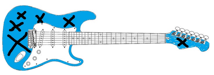

    So the ST-1 kit turned up today ( oh-yeah ) and the daughter says yes I want it that colour but with black crosses on it. Is it difficult to paint a pattern on top of a solid colour, and should I then put a clear coat on top?

    Hi Neil,
    can you please post a rough sketch of the layout your daughter wants ? If the crosses will be large then you should be able to tape it off and paint the crosses or get a stencil made up in vinyl could be an option.
    If the crosses will be small then I think a template/stencil would be the only option

    She would like me to do something like this...

    Moderator dingobass's Avatar
    4,491
    Cut out stencils would be the easiest way
    and yes to a clear over the top

    Hi Neil if you know a signwriter best get them to cut the crosses out of some vinyl or clear contact. Put down your base colour, then put the vinyl over with the crosses cut out. I used this method to get the stars on the Australian flag.
    Otherwise get some contact or adhesive vinyl and a sharp blade and cut the crosses out.
    Good luck let us know how you go !
