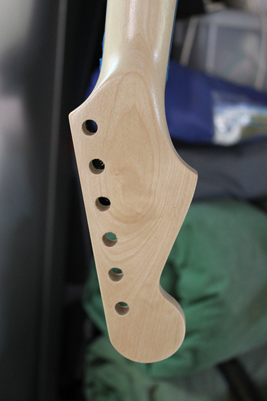

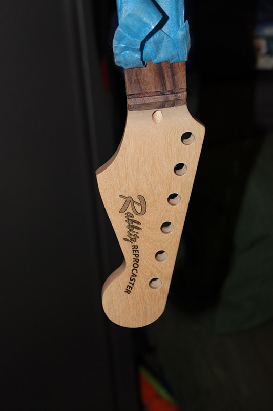

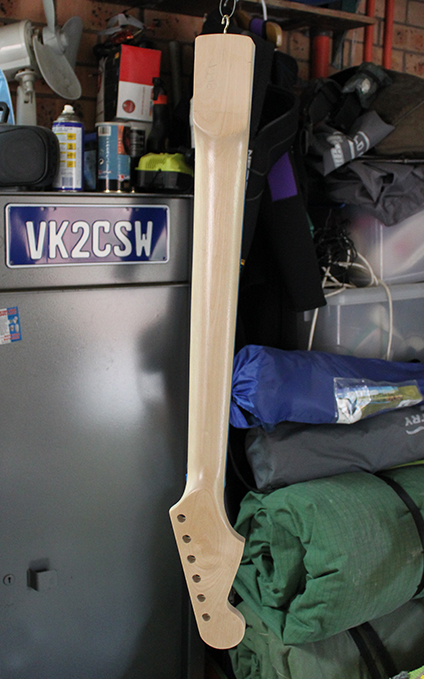

    So the first steps:
    Neck & Headstock
ID:	5945Click image for larger version.

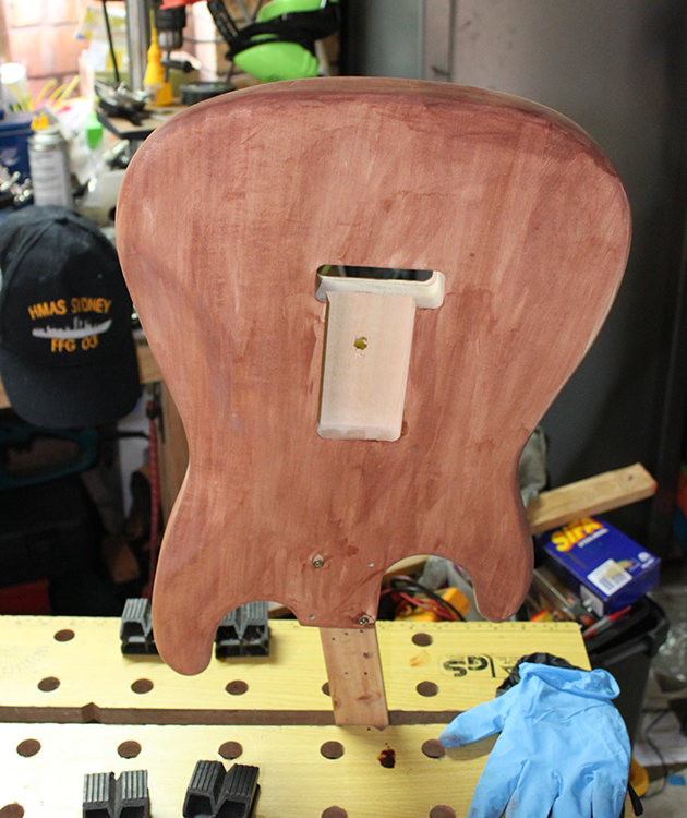

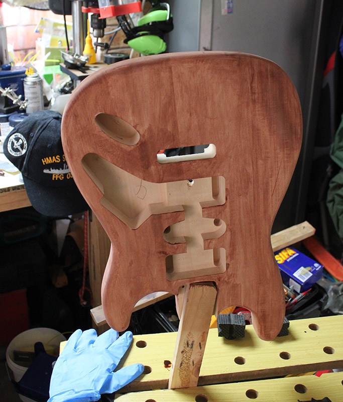

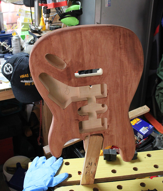

    Body after staining with walnut stain diluted by 10 or 15% with water:
Name:	Front Stained 01.jpg
ID:	5947Click image for larger version.
Name:	Rear Stained 01.jpg

    Mentor Rabbitz's Avatar
    Apr 2015
    774
    I should have said that the neck and headstock is simply hand-rubbed clear Cabothane.
    This is in an effort to let the timber be the timber.

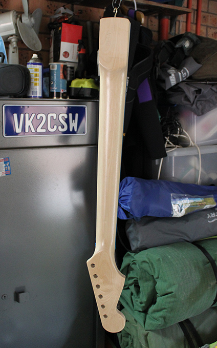

    Apr 2015
    774

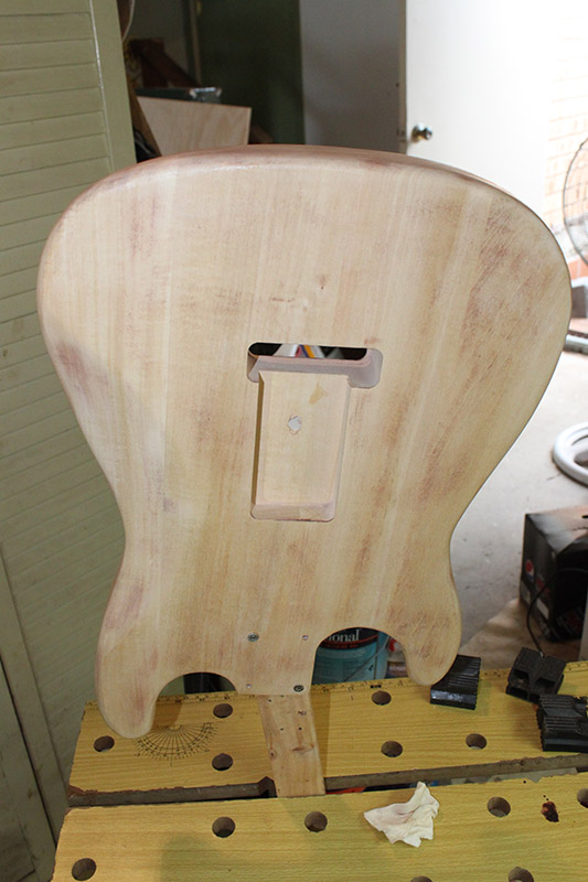

    Ok so the stain is knocked back and it is rubbed down to 400 grit.
    Next step will be a very thin clear coat, followed by three lime wash coats.
    Wish me luck!
Name:	Front Stain Knocked Back 01.jpg
ID:	6126Click image for larger version.
Name:	Back Stain Knocked Back 01.jpg
    Col.
    \m/

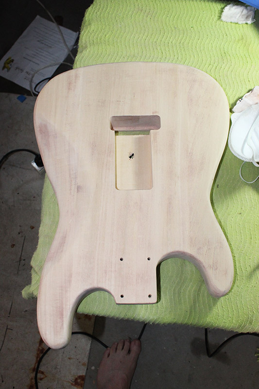

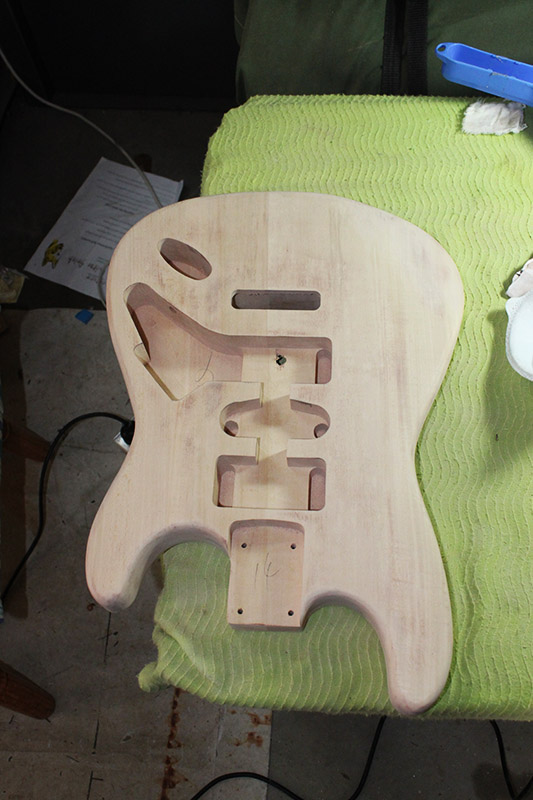

    Apr 2015
    774
    Hi Pabs,
    I will be using an F&W limewash & varnish combination.
    The reason I decided on the clear coat is to seal the stain. While I was experimenting I found the limewash/varnish would soften and lift the stain onto the brush and rag. Which means it was all a bit messy. So I am trying to put a bit of a clear barrier between them.
    Here are couple of shots after the clear coat:
Name:	Front after sealer clear coat 01.jpg
ID:	6128Click image for larger version.
Name:	Back after sealer clear coat 01.jpg
    Looking OK so far...

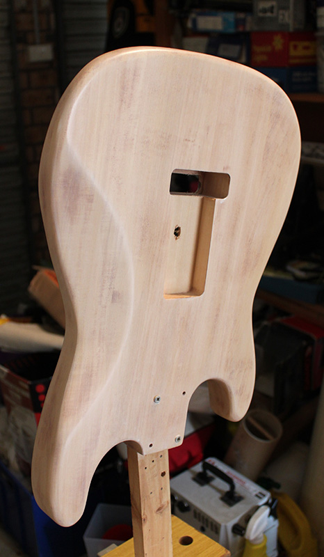

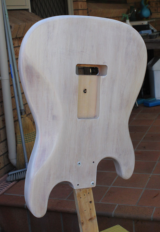

    Apr 2015
    774
Name:	A bit lighter01.jpg
    I think it is whitening up.
    I think
    About 7 liming coats.
