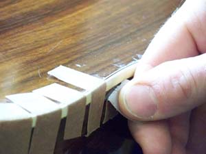

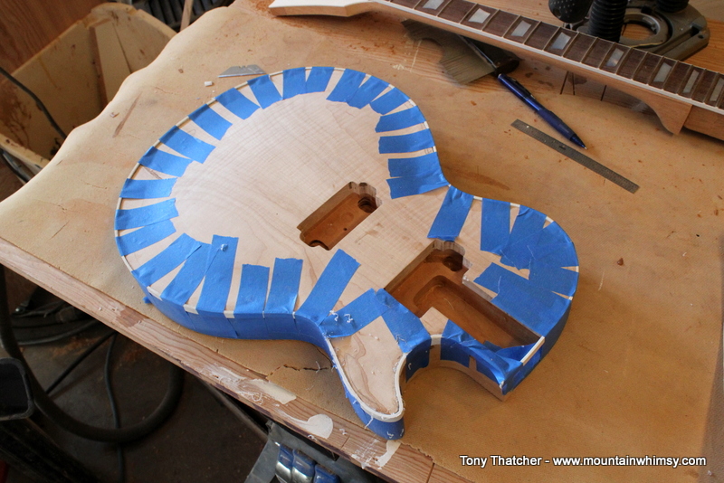

    Not if you have the proper equipment, namely a router and appropriate sized straight edge router bit and bearings. Otherwise you are going to have to try heating the glue to get it off as Wokka has suggested.
    Quote Originally Posted by Crusader View Post
    How to get the original off,
    As above!
    What glue to use to attach the new one,
    Tarzan Grip is best. Plus you need some adhesive tape. You need to 'stretch' the tape across the newly positioned binding as you work. This keeps it in place. Let it dry for three days before removing the tape. You MUST pull the edge of the tape 'back on itself' so that you dont rip the fibres of the body...
    Pull it off before or after painting,
    ABSOLUTELY has to be done BEFORE.....
    Put the new one on before or after painting,
    ....must be before....
    Is it hard to change it on the fret board as well?
    Not if you have the right tools, if not, be patient, dont rush, may be a bit more clean up to do on the guitar.
    And would it look weird on the headstock?
    Not if you do it properly!
