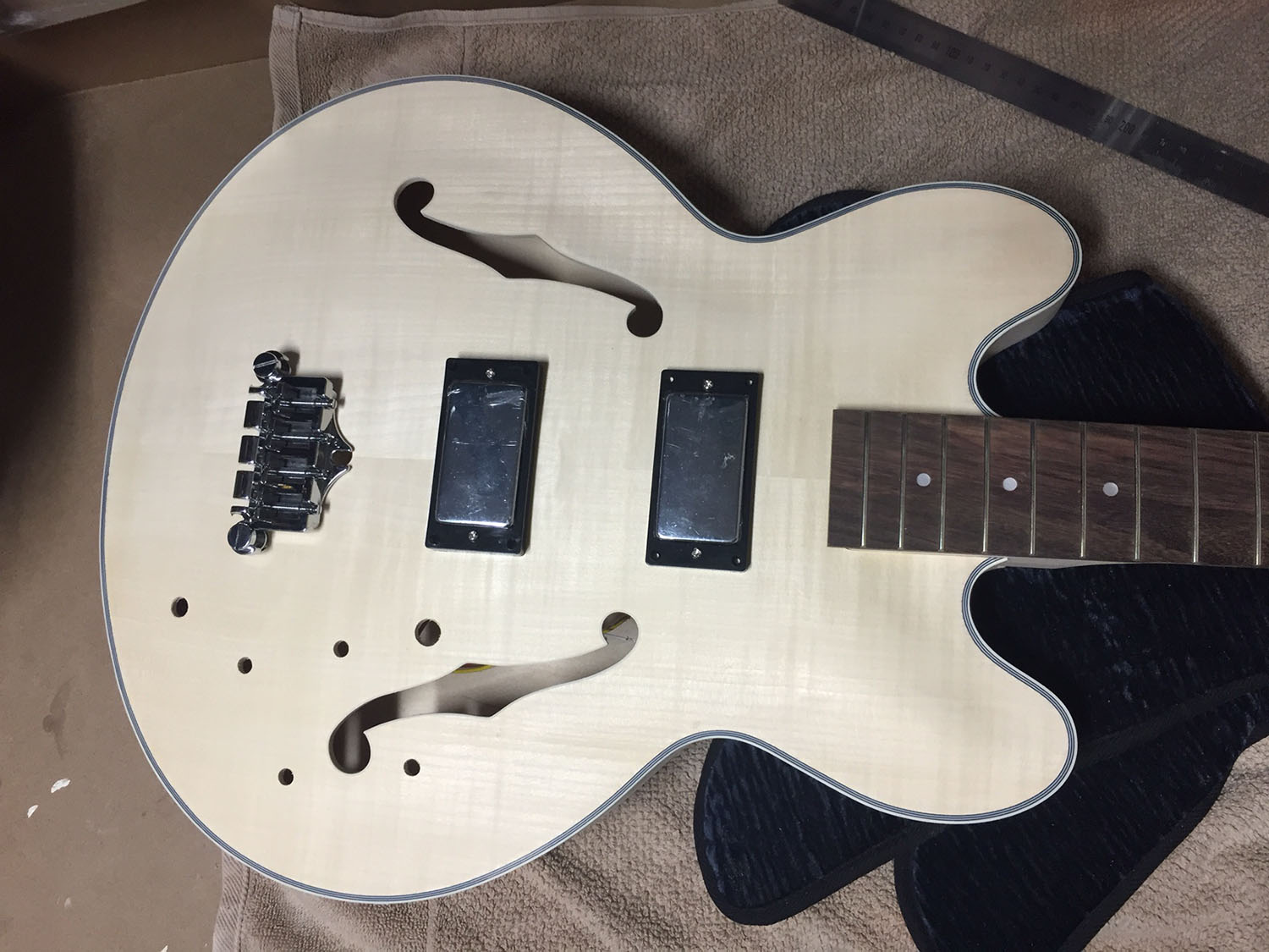

    Here's the mock build photo. Everything seems pretty bang on. Neck is a super tight fit but I figure thats not a bad thing for a glue on neck.

    nice looking kit Damo, look forward to seeing some stain on it

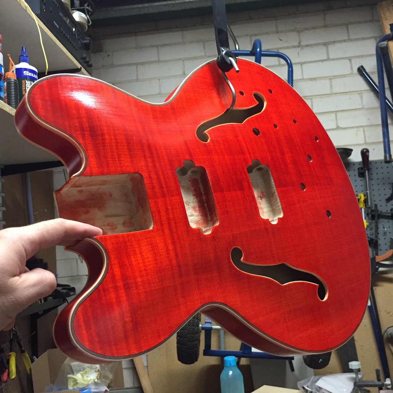

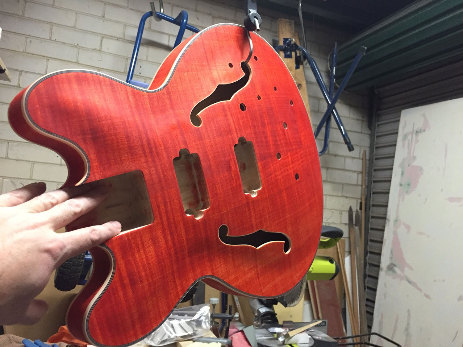

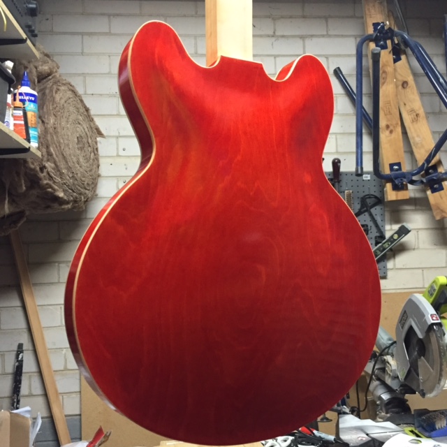

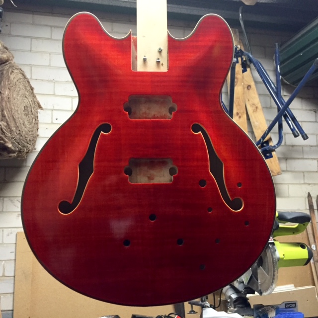

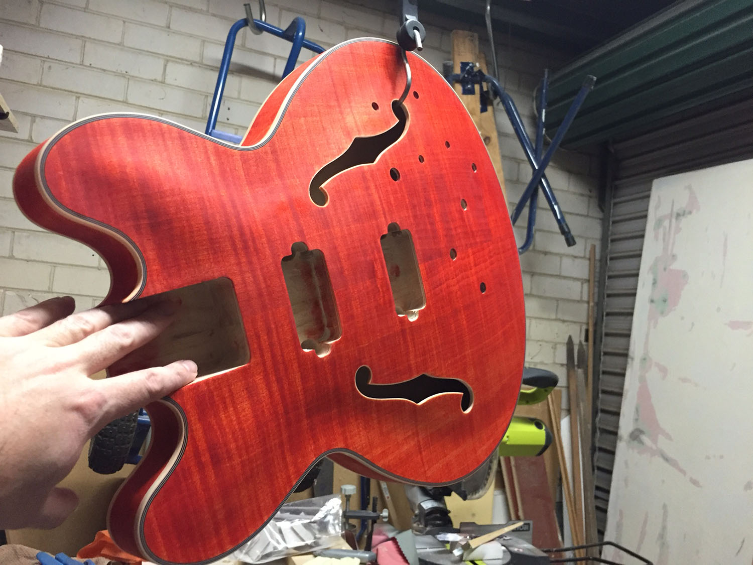

    After 4 x 2hour sanding sessions I was feeling pretty confident to lay down the stain (Dingotone Uluru Red).
    Really happy with the results..

    Great job. That is looking pretty good!

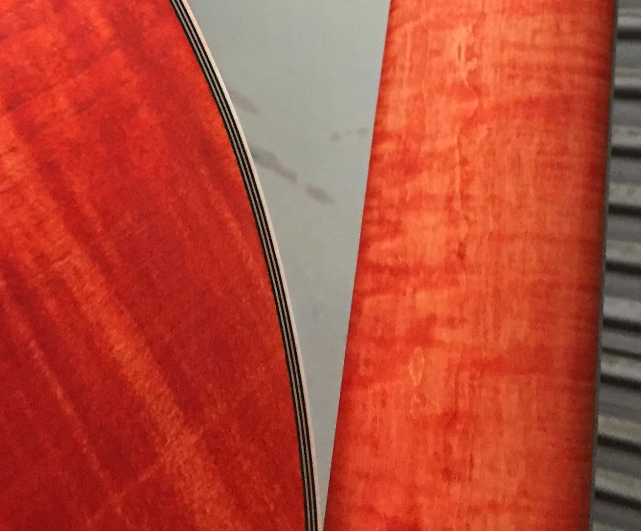

    WOW Damo that looks excellent. Did you tape off the binding looks nice and clean ?

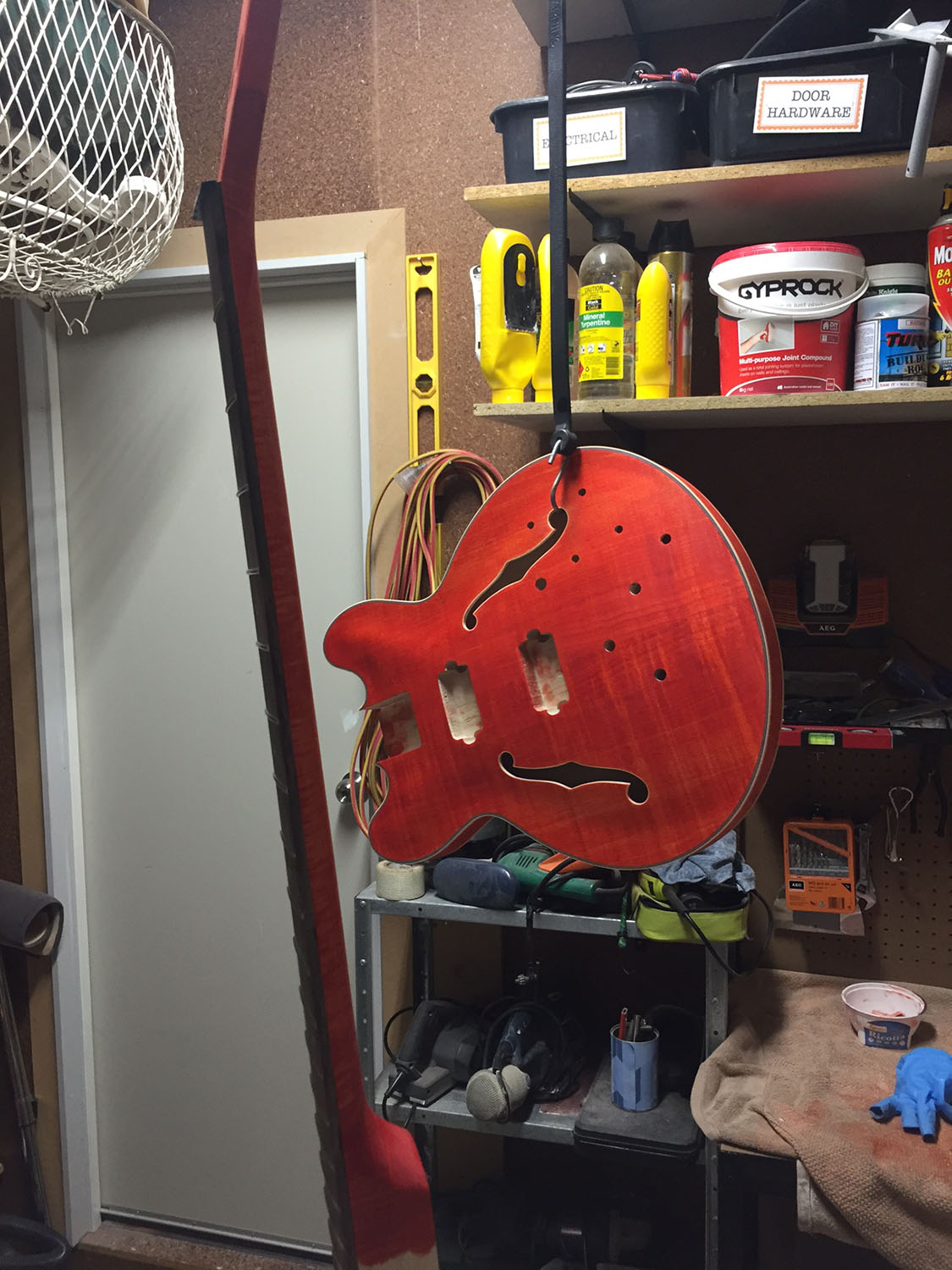

    Love your hanging method
    Thanks Gavin!
    Thanks Wokka!
    No mate I didn't tape off the binding.. I firstly gave it a going over with 400 wet dry (I saw someone had done that in another build and thought it a good idea) then I went around it again (very carefully) after the stain with some super fine steel wool (I also saw that in another post).
    well done Damo, cleaning up binding can be a difficult fidly job.
