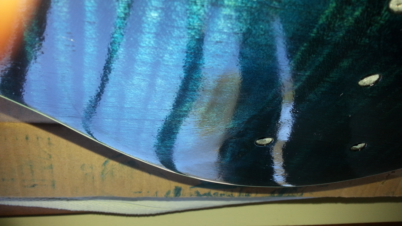

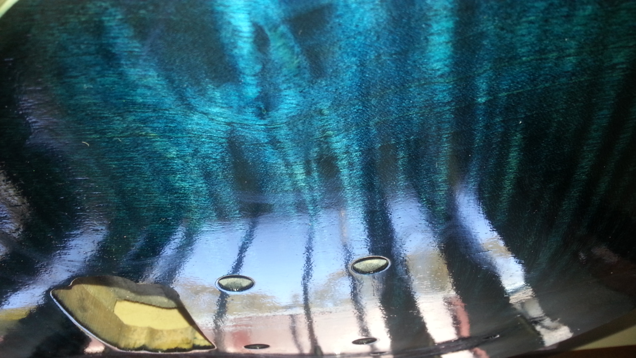

    Hey everyone thanks for checking out my thread
    im wondering how to avoid streaks with my finish
    ill coat with tru-oil lightly rubbing in circles
    let dry
    Scuff with 0000 wool
    wipe with cloth
    then repeat
    but im getting streak lines from wiping the oil on
    is it because im not using enough oil and the dries parts if my chucks clothe
    is slightly wiping off the oil leaving streaks?
    Or will buffing it after it curing will remove them
    its hard to photo but I have a cpl

    The first pic you can see the streak just on the left right above the pickup cavity

    Ok, my solution is to thin out the TO after applying the neat stuff in the desired quantity. I thin out with white spirit, 50/50 or 25/75 TO/spirit

    WhiteRabbitz it might help to use a fine cotton rag, what are you using chux wipes to rag on the TO ?
    The smoother the rag the better the finish you will get, or get some lint free cloths.
    I tend to run the rag one end of the guitar to the other in 1 motion and hold it up to the light to see if there are any runs or streaks.
    It takes a bit of practice. As Andrew says the last 2 coats can be thinned down a bit should give you a flatter finish.

    Hey Rabbitz, pretty much what Andrew and Woks said. When I have built up the level of TO I want I will thin out the TO with White Spirit for the last 3 coats. I will usually sand down (very lightly) with 2000 grit between these coats.
    If you still haven't got the finish you want you may have to cut it back. I use Brasso then a good quality auto finishing/swirl remover that has no silicon.
    Use the Brasso at your own discretion, I have no idea how it reacts with TO over time but I have done several guitar now with Brasso and they come up a treat and are not showing any adverse reaction to the stuff.
