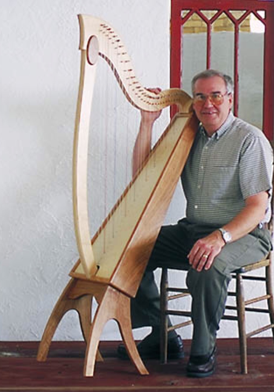

    This is what I am hoping for at the end of the project. Apparently can be assembled in a day!
    I have the option of the low feet or tall feet as in the two pics below. Pic on the right is on the front cover of the instructions sent by Musicmakers.

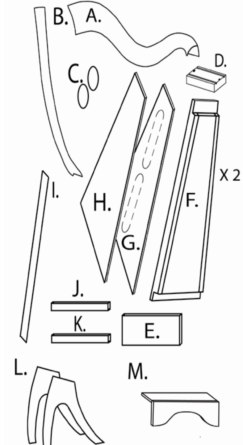

    And some idea of the plans...the actual plans sent are full size with all the measurements etc. Going to see if I can get some acrylic perspex and get templates cut from this or I'll cut them myself.

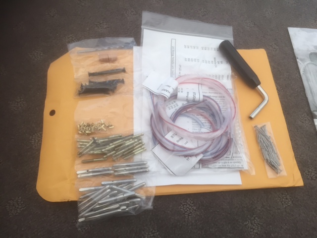

    The envelopes contained some goodies that will be used to finish the build, namley some screws, ferrules, gut strings, tuners and tuning spanner amongst other items.

    One instrument I've not seen up close. Is the part that is against the guys shoulder the sound box?
    If so, do harp makers argue about sound board timber as much as luthiers???????????
    Also the parts marked C on the drawing, it that where to logo goes?
    A serious question, though - Are A and B cut or bent to shape? That might be a challenge.
    Yes, pretty much the point where the Harp Neck and the soundbox are connected.
    Quote Originally Posted by Rabbitz View Post
    As DB says - Yes they do! Interestingly Sitka Spruce is commonly used.
    Yes indeed!
    They are cut to shape but it is recommended that a laminate is made or acquired using the laminate to provide additional strength to the neck as there will be over 700lb of tension and a one piece neck will be prone to snapping into two pieces!
