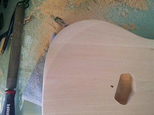

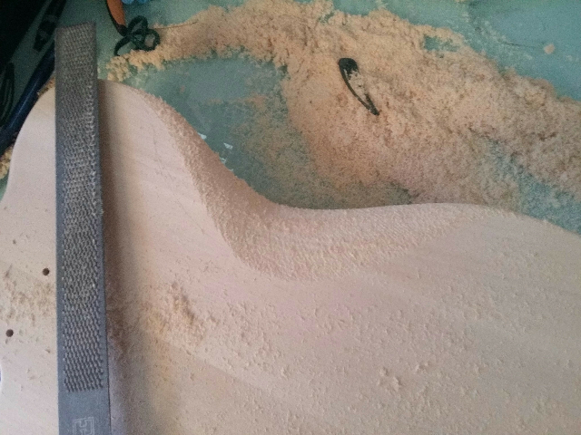

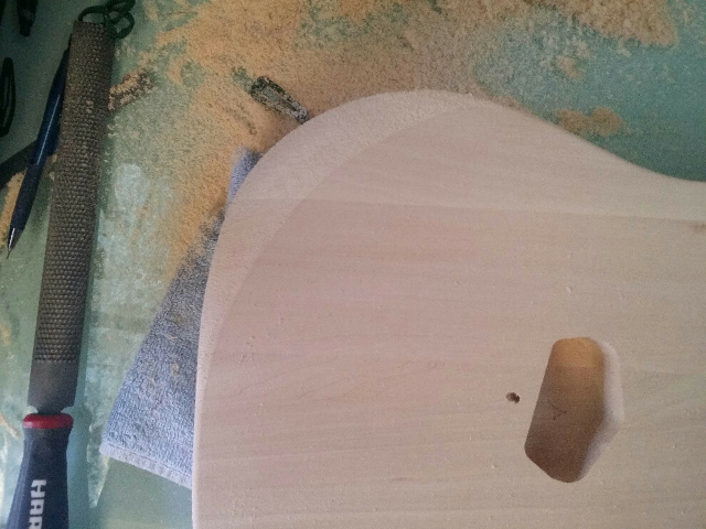

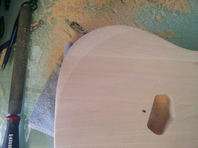

    And body carves which are a work in progress..

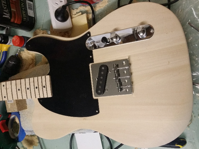

    Yep, just the bridge pickup. So the 3 x way control will be volume & tone, volume & no tone and no volume/tone (output direct to output jack). Finish will be the Behlen nitro lacquer spray cans...

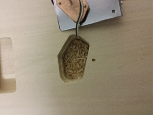

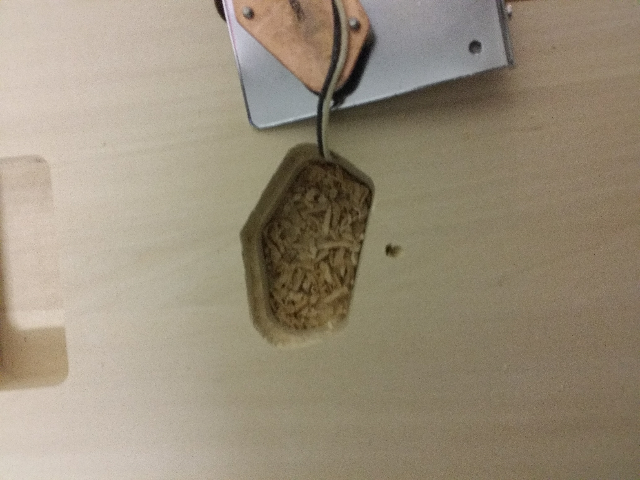

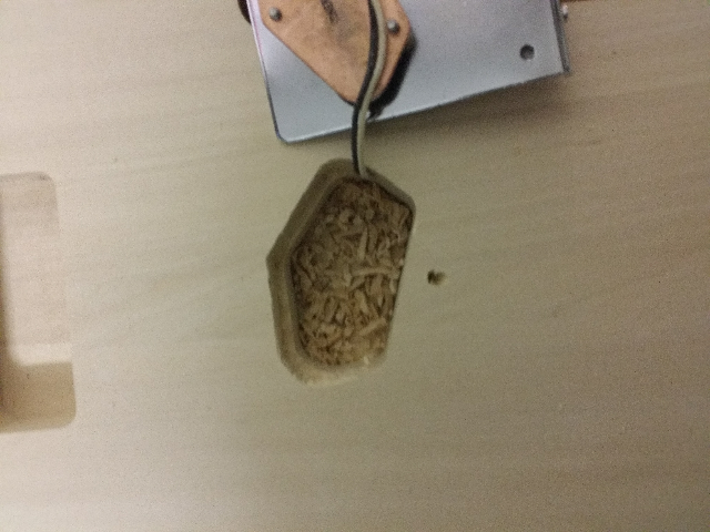

    Quick update. Body carving complete. Carved out pup cavity with chisel so the Tonerider pup fits and I can move the bridge north a bit. Tweaked the Esquire pickguard so it fits. Angle looks a bit funny in this photo - it fits ok in the cutout and not too close to the side. Drilled neck screws, bridge next, then time for sanding..

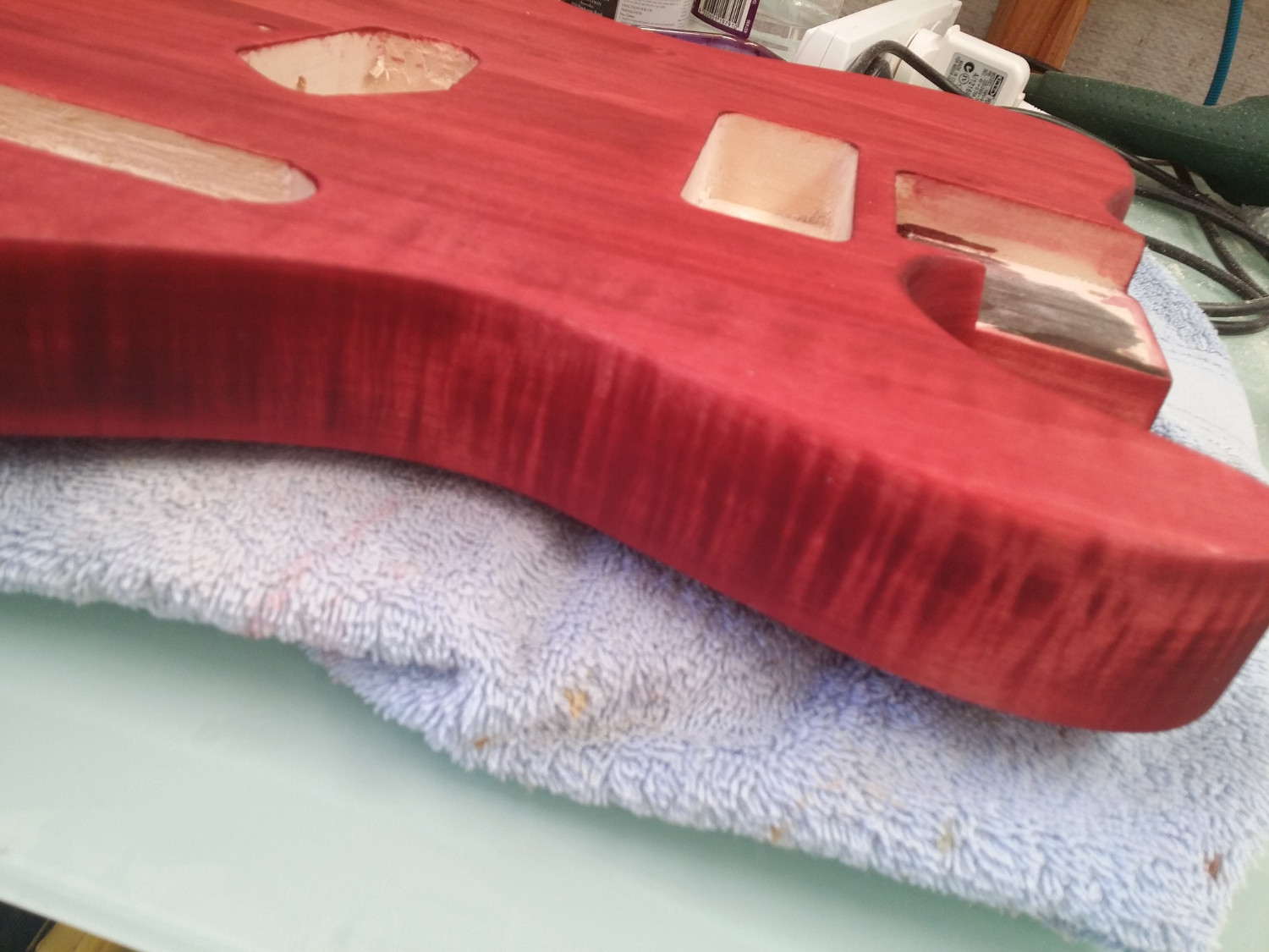

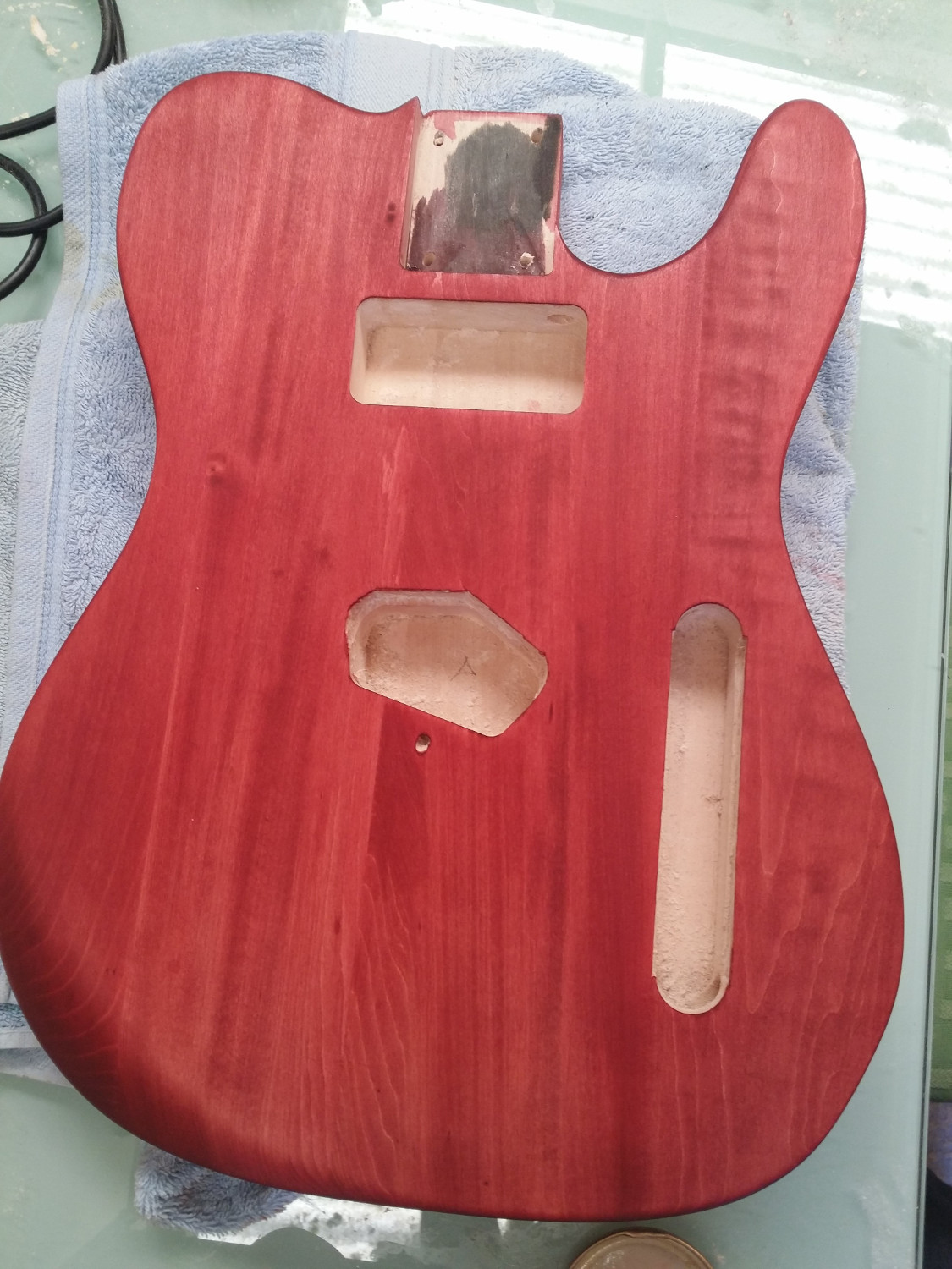

    Body finish plan has changed (and sure to change again) now planning to use FW tint (mahogany) diluted (100ml Metho w/2 teaspoons dye). Comes up nice and deep red.

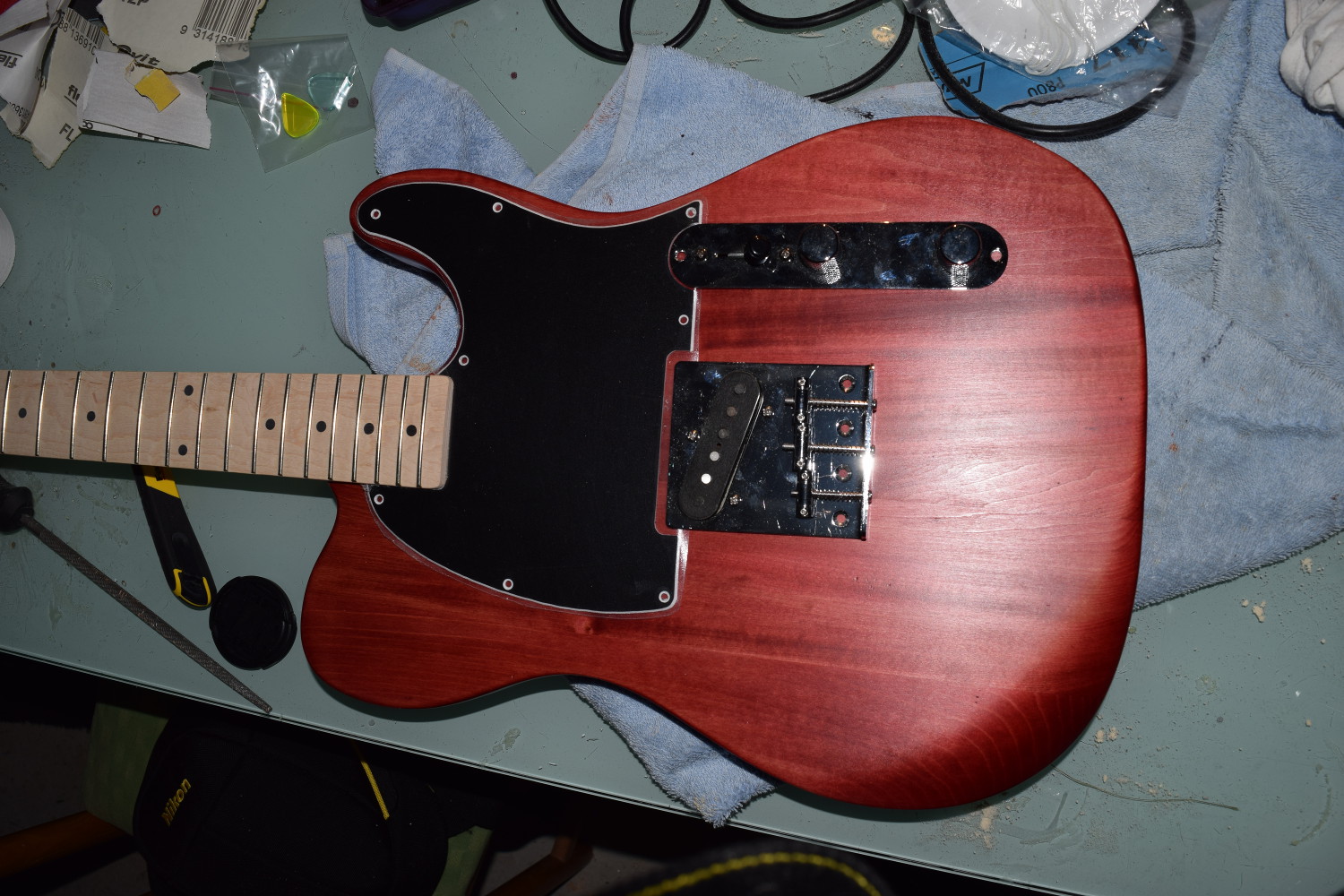

    Good stuff Ponch looking great. The stain plans should be a nice deep red. Can't wait to see the stain coat
    Deep red with black pickguard. Not my first choice, I tend to like black pickguard with lighter colours only. But I'm very willing for you to prove me wrong.
    haha Fretty you are a hard man to please. Just think of Angus Young's cherry red SG's with black pickguard
    I know, it's just personal taste. I'm sure Andrew's guitar will look great.
    all good Fretty I know everyone's personal taste is different.
    Looks like we're doing a nice thread jack on this diary haha
    Oh looks like I've been thread jacked lol. Good point Fretty on the color scheme, something I need to consider....
