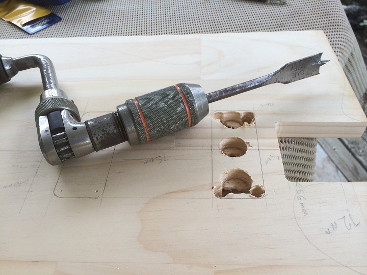

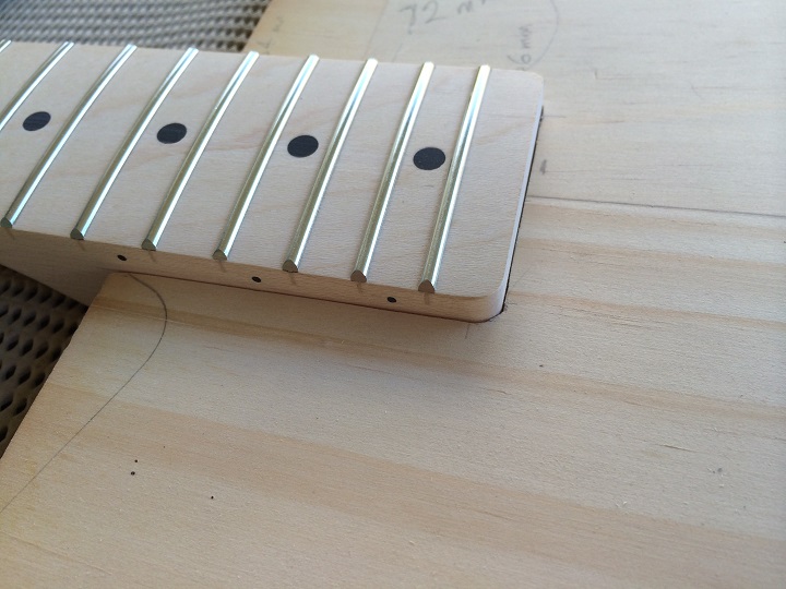

    Pic 1. Before cutting out the body shape I thought I had better cut a neck pocket. Cutting well inside the lines. (You can always take more away but it’s a lot harder to put some back). Just to clarify, the neck pocket and pup route “floors” will be the middle ply layer.
    Pic 2. Neck pocket finished, nice snug fit.
    Pic 3. Starting the P90 cavity. For the small drilling jobs I used an "egg beater" drill for the larger holes I used the brace and a spade bit.
