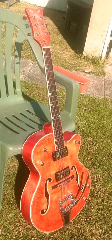

I have been really happy with the entire process, not just the kit, but also the usability and beauty of the Dingotone finish. Not to mention the addictive aroma! I used Dingotone Uluru over the GR1-SF kit. This was my first build, and my first use of a finishing product such as Dingotone.
My own workmanship, I expect, is to blame, and as I prep for my next project I would like some advice to avoid a couple of outcomes.
1. The finish on the instrument is slightly tacky, even now after one month. Is this normal? I've only ever had poly or nitro instruments before, and this fels very differet. Nothing is sticking to it. Does it need a polish of some kind? The finish still feels slightly soft and can be easily picked off with a fingernail.
2. The finish appears to have micro flaws in it, such as dull spots around joins, and seems to have either tiny flecks of dust or random fine hairs in it. How do I go about avoiding these issues in the future.
