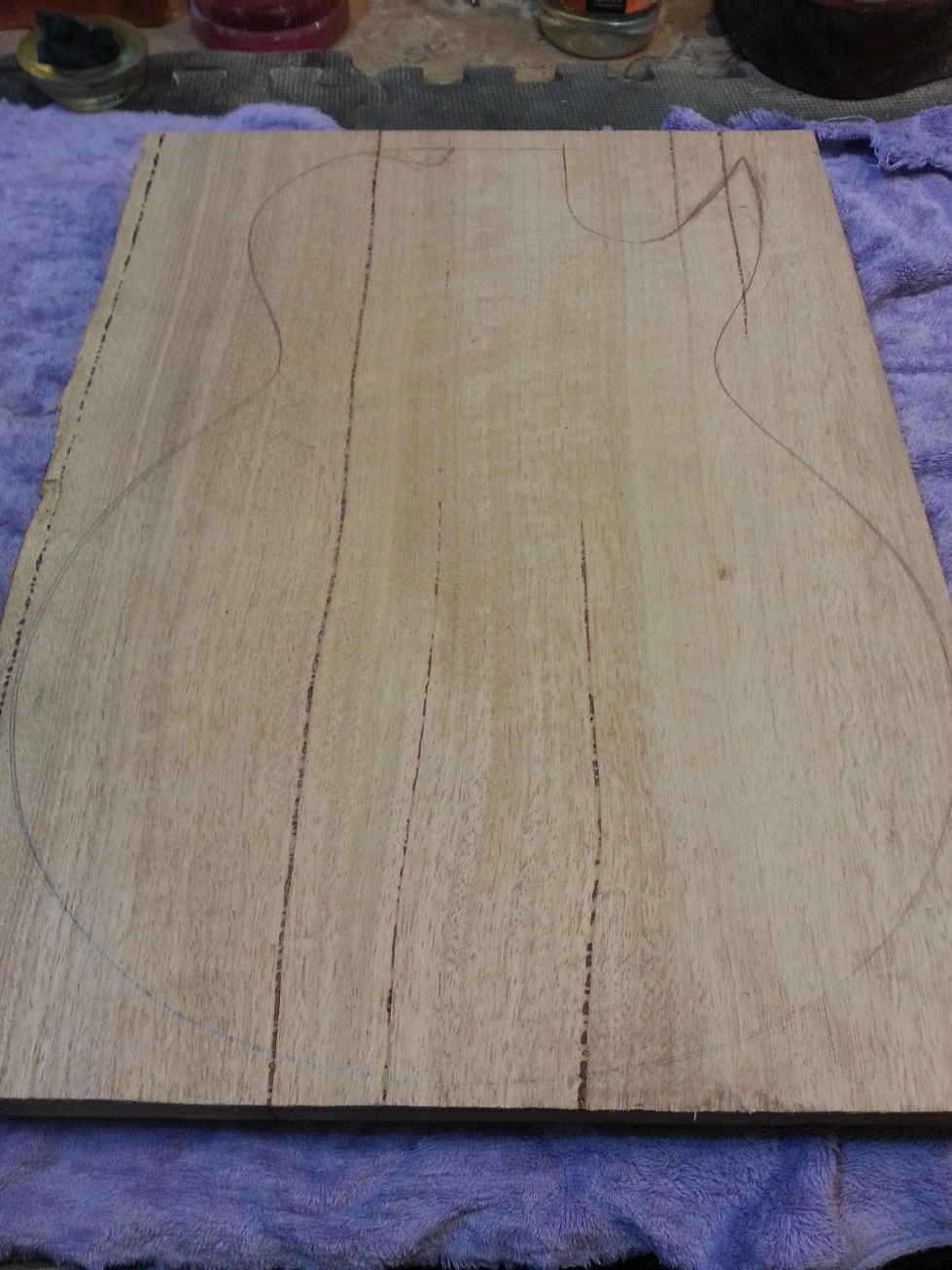

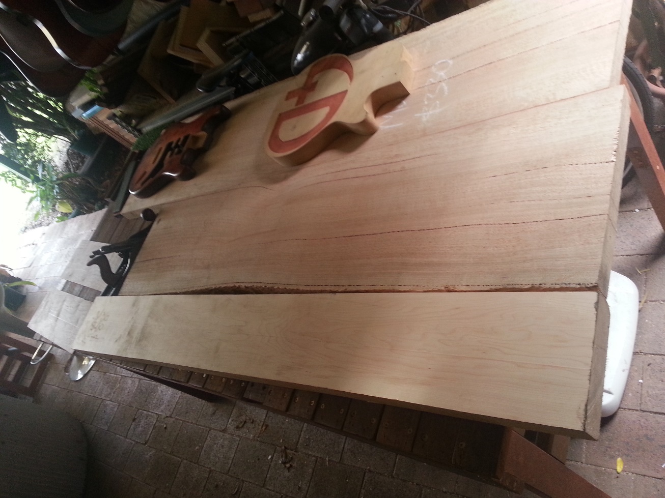

    went to the Perth wood show yesterday and scored some nice timber. Scored a 3.1m long marri slab 42mm thick (two wider chunks in 1st pic) and a nice rock maple chunk (left in pic) will make 4 necks.
    So excited little camper had to start a new scratchy as I've just finished the last one.

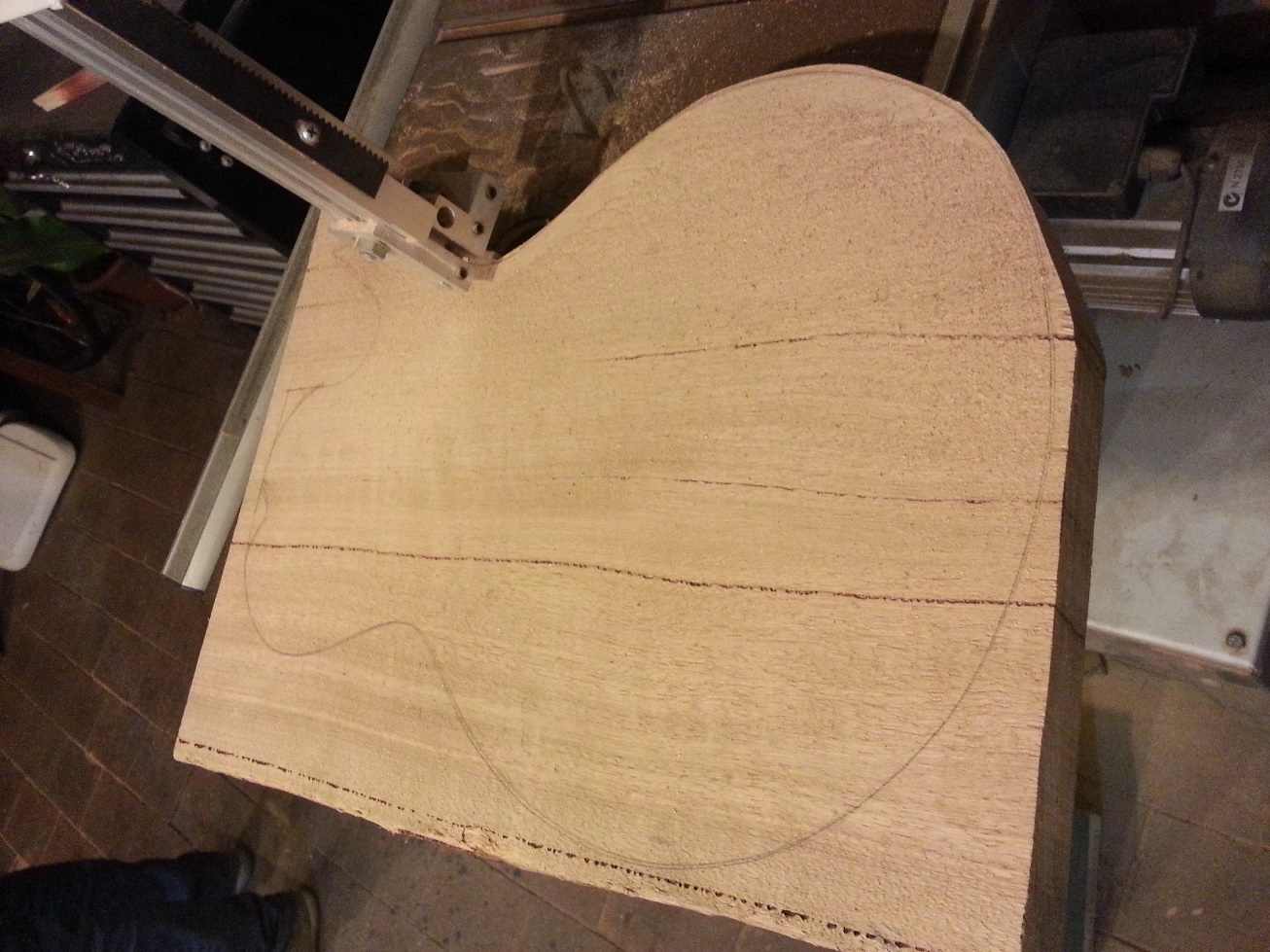

    Never built a LP shape so wanted it a bit different put a small tele-ish dip above the neck and made the horn longer. Still need to do some sanding and reshaping. Got the neck and pup cavities routed and a rough sand. Will probably attempt an arch top as it weighs a heap. Should get the control and switch cavities routed this arvo
    So 1st pic is the timber stash and 2nd the blank and 3rd on the bandosaurus

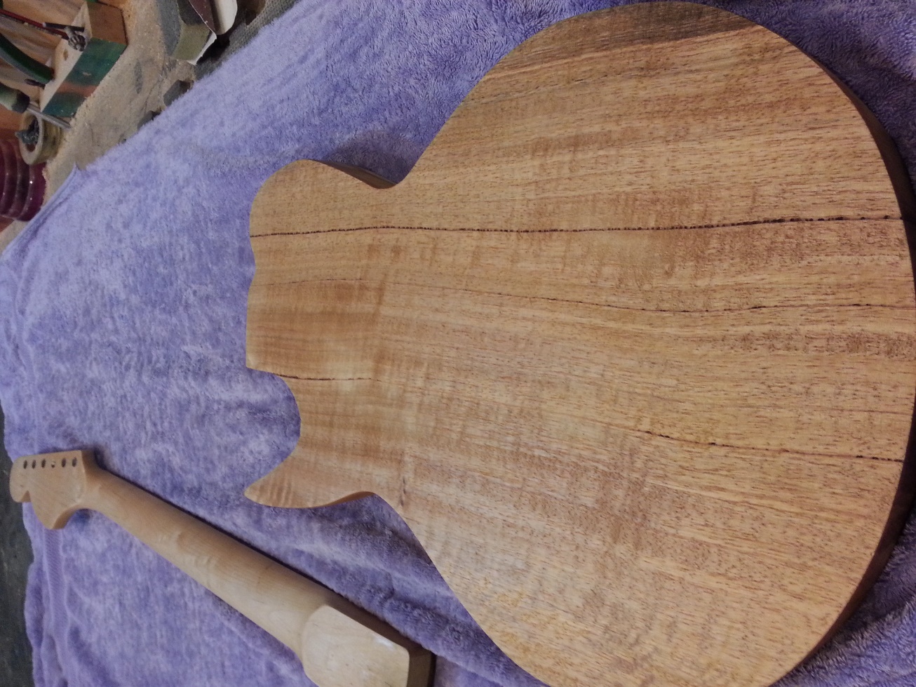

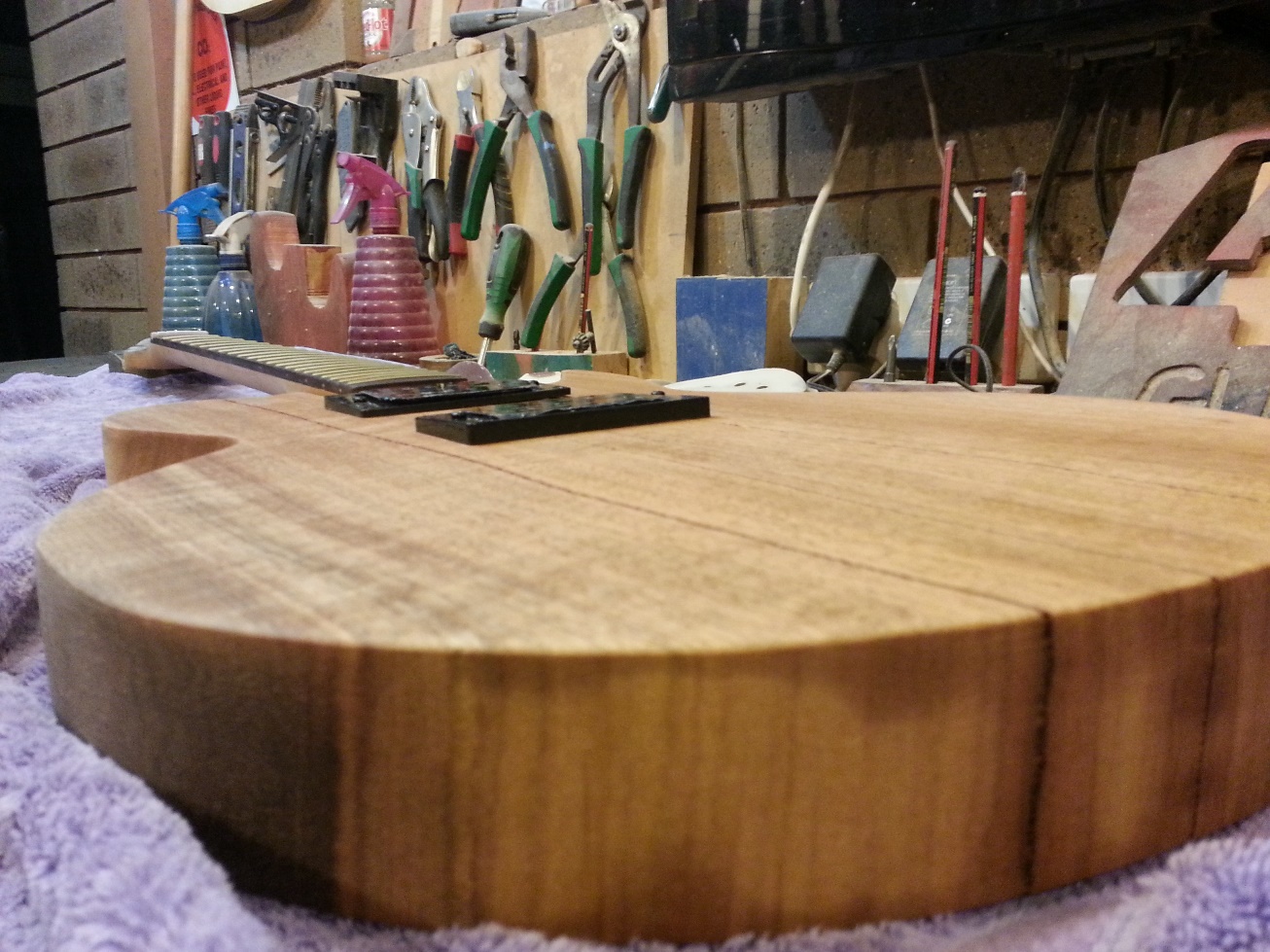

    here's the end of the day progress lastnight mock build so far.
    Off now to do some work on it now and watch the Dockers belt the Saints

    I sent some pics to DB and he thinks its quarter sawn so that's good news.
    Slab will make 7 bodies. I will store the rest for myself and Wayne to build in about 12 months.
    But had to start and build one now !

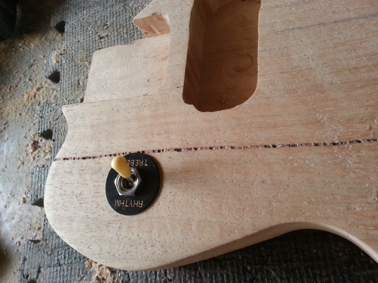

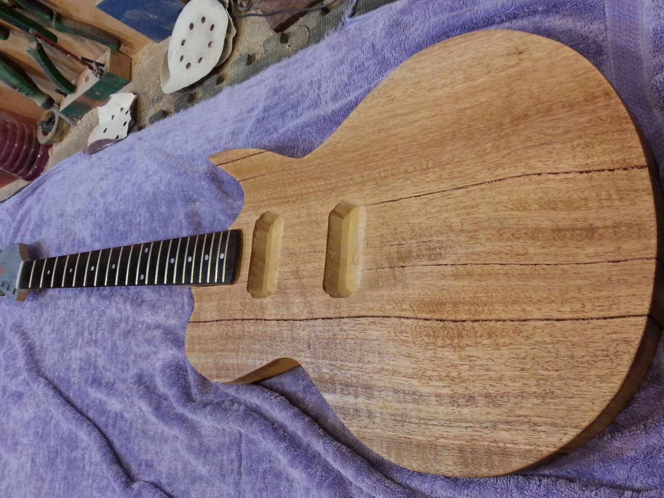

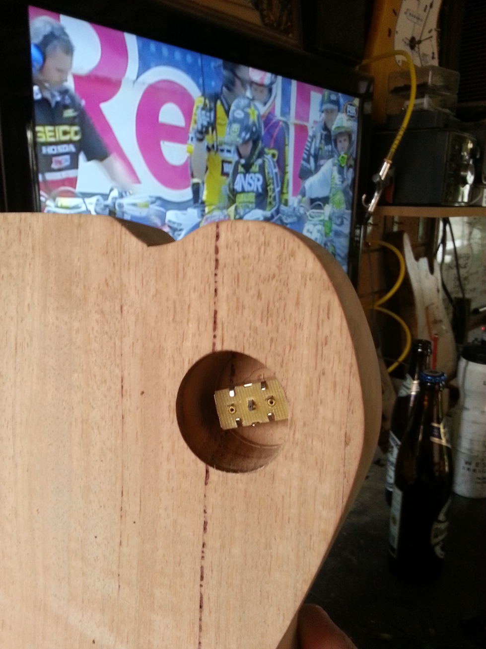

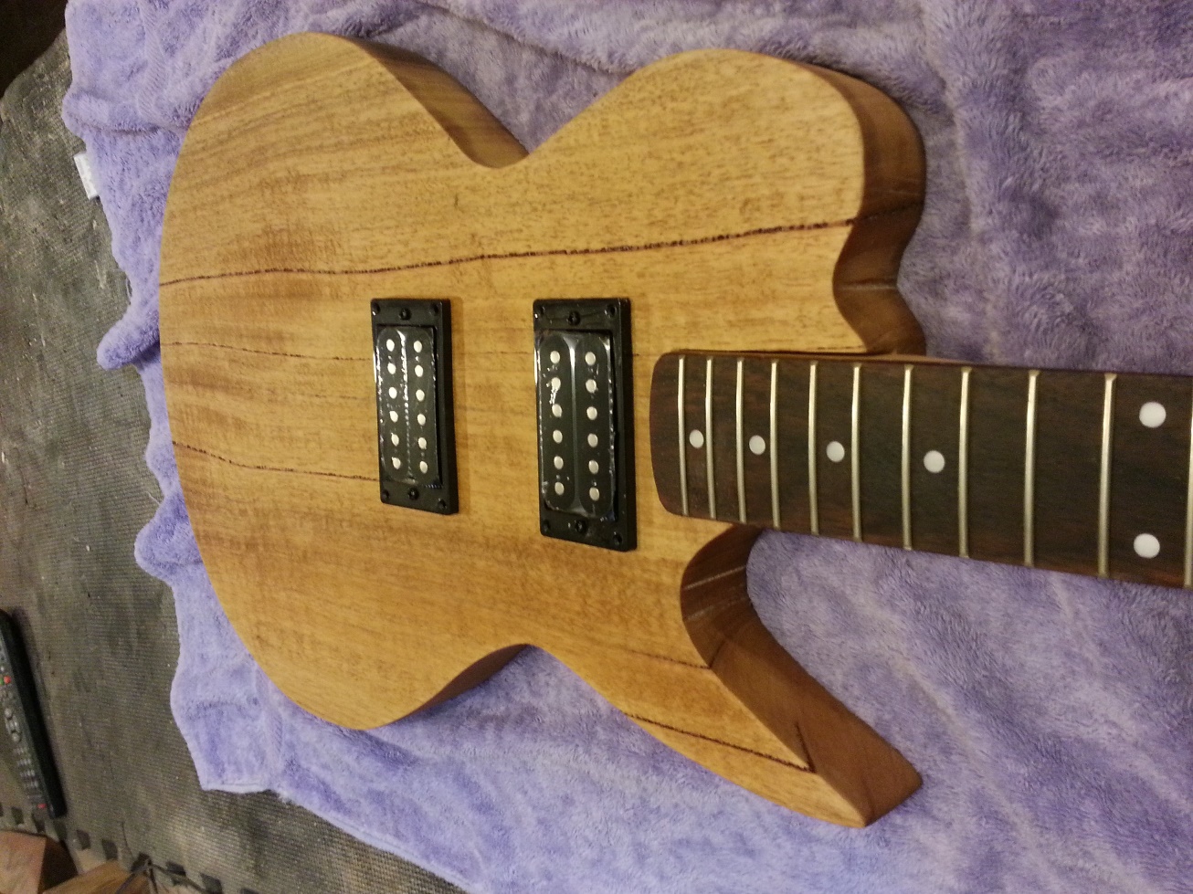

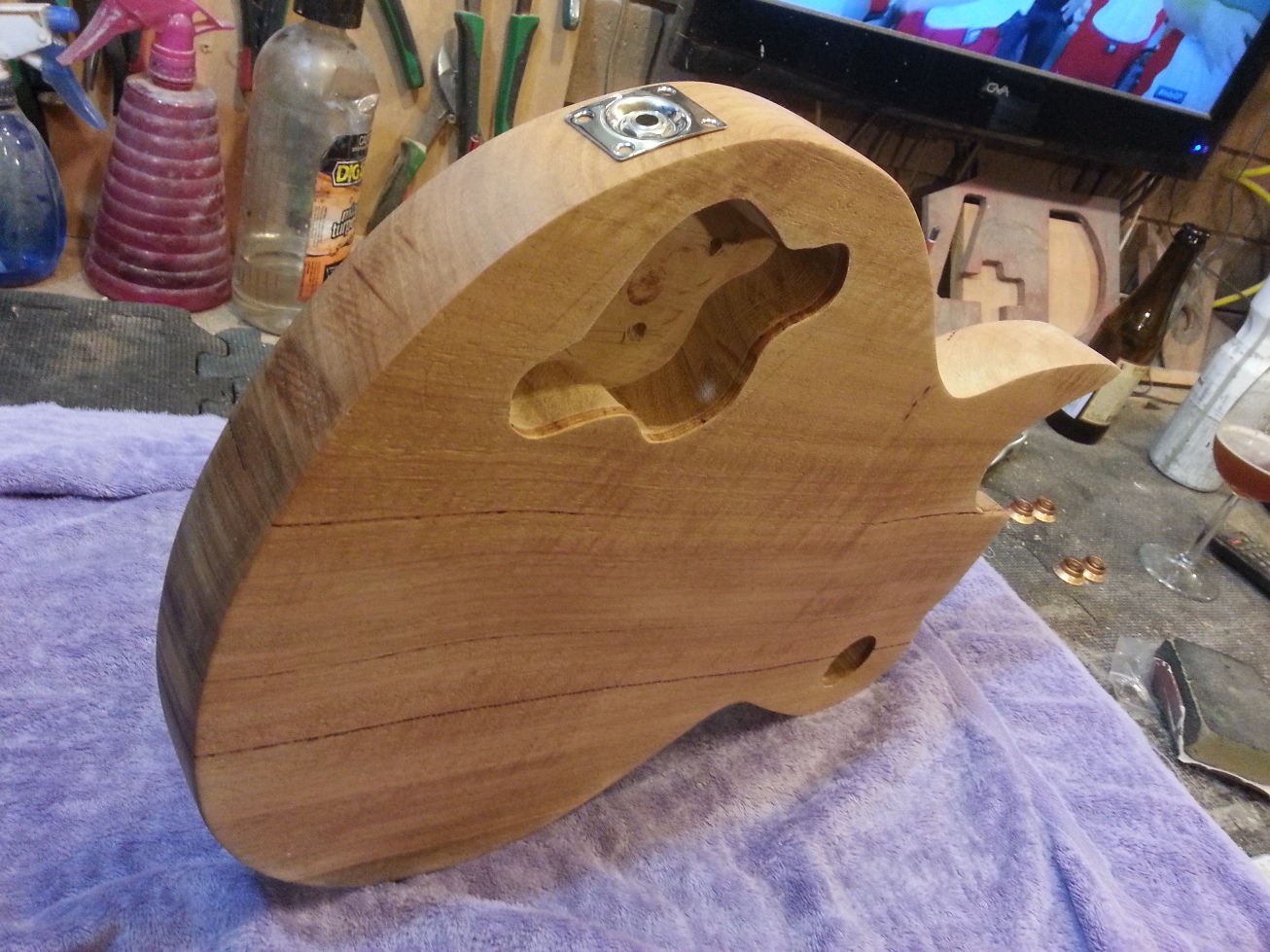

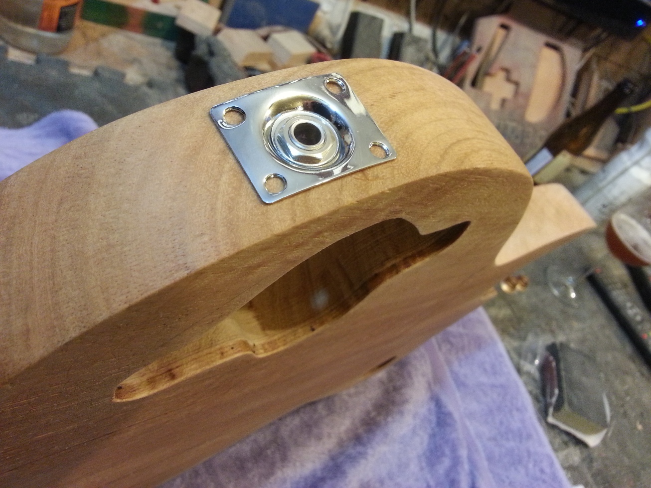

    got the switch and control cavity routed yesterday. Also output jack hole drilled. Had to make a template for the control cavity.
    Next step is to recess the cavities for the covers
ID:	4528   Click image for larger version.
ID:	4529   Click image for larger version.

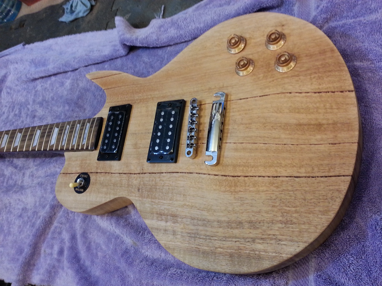

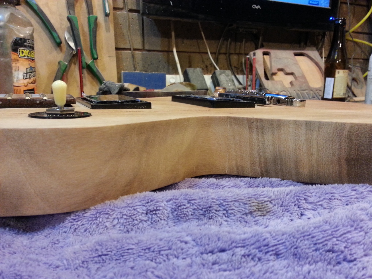

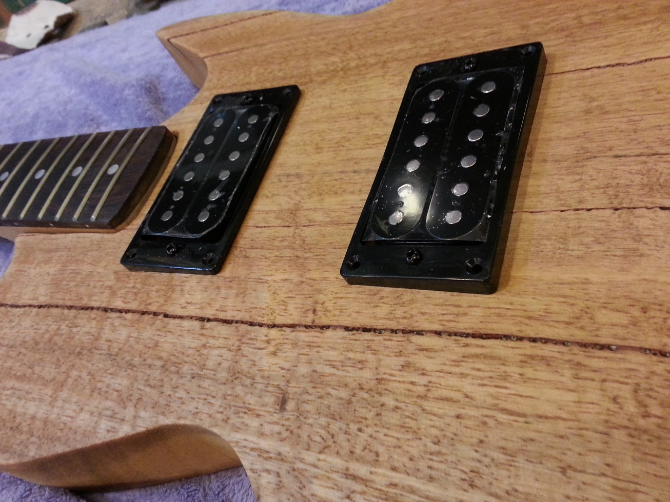

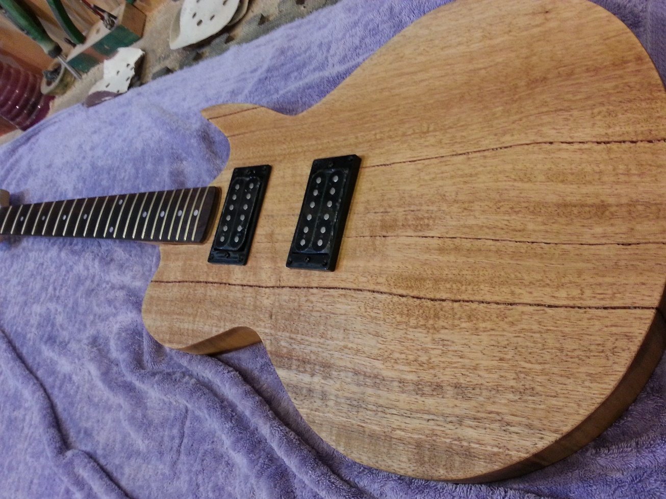

    more pics and a mock build
ID:	4531   Click image for larger version.
ID:	4532   Click image for larger version.
