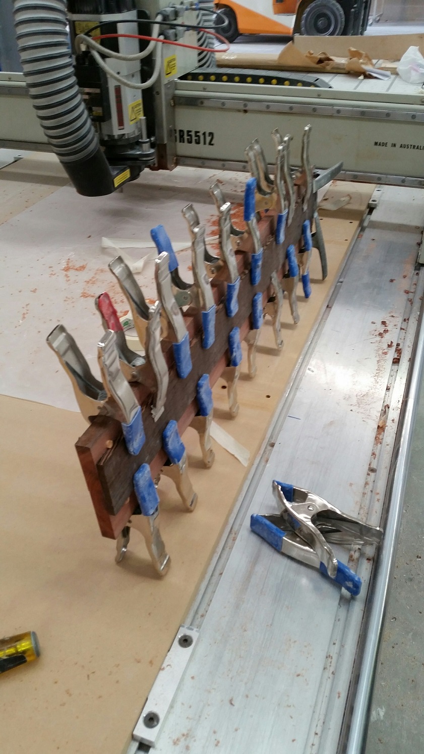

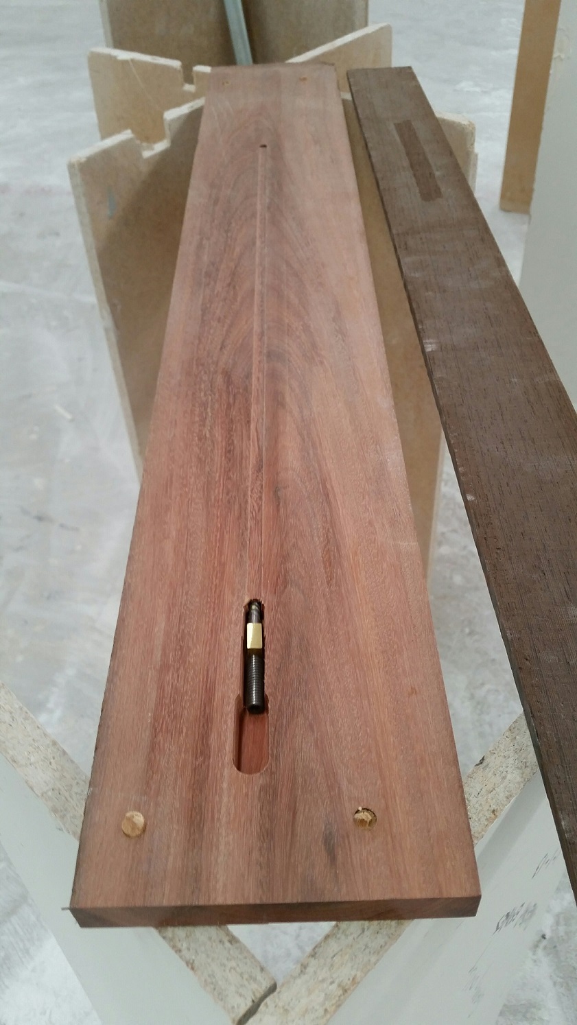

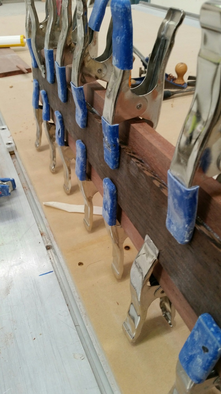

    Hi Bry can you please post a pic of the wenge fingerboard ? would love to see if it's got some nice grain. Plenty of red stains you could use if you are colouring it to a theme
    It's covered in clamps at the moment while the epoxy dries. I took one before I stuck it on though. See below

    Also can anyone identify that hardwood?
    any idea where the hardwood came from Bry ?
    looks like the wenge will be too dark to stain.
    Neck could be a jarrah but more than likely something else.
    What state you live in ?
    Im in NSW. The wood came from a guy in our factory whos dad had it under his workbench in wollongong for 40 years or so.
    Any ideas what I can do to the fretboard? Or am I stuck and just have to leave it? I read Lemon oil is good?
    ok the hardwood is probably not jarrah is more a south west of WA grown timber. Hard to say someone from East coast may have more idea of locally grown hardwoods.
    The fretboard will look great in its natural colour so most fretboard oils will do the trick
