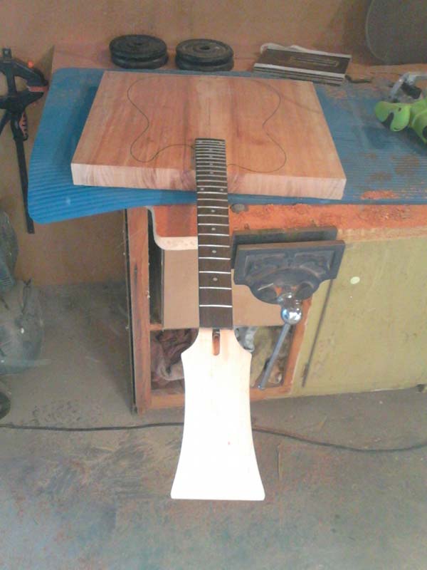

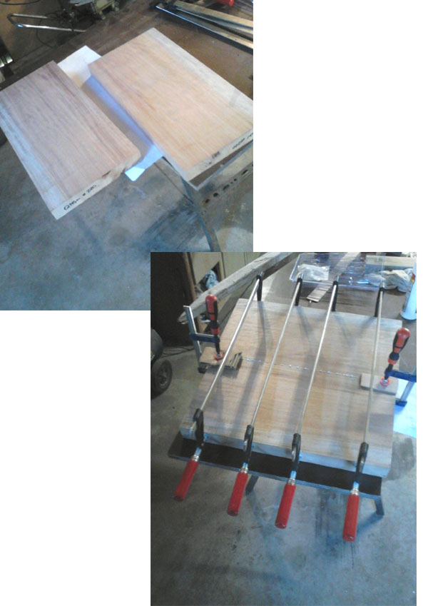

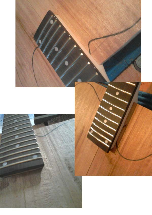

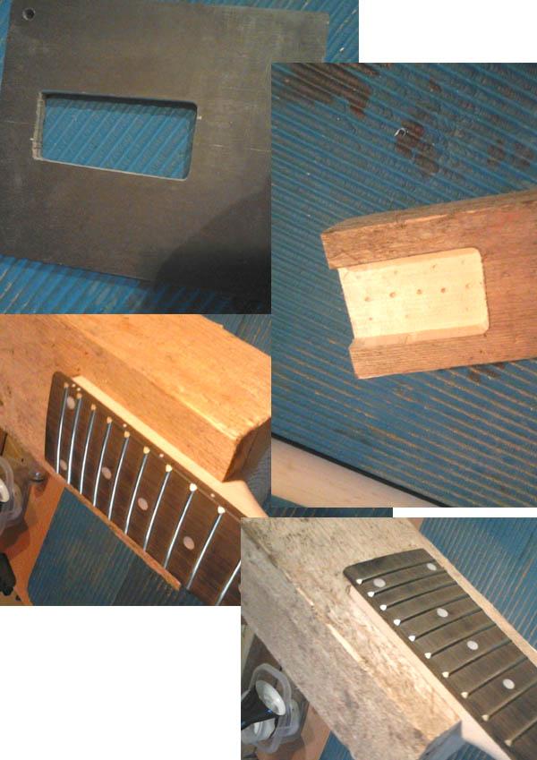

    Body glued and clamped.
    Apart from glue everywhere the neck's in pretty good shape, best part is at least the tuner holes will be in the right place.
    Made up a template for the neck pocket and had a practice run on some scrap, fits like a glove.

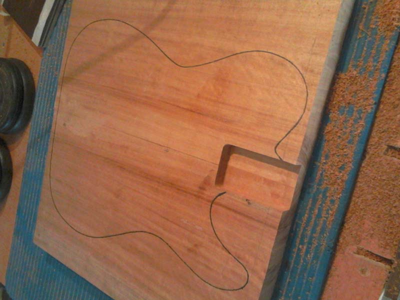

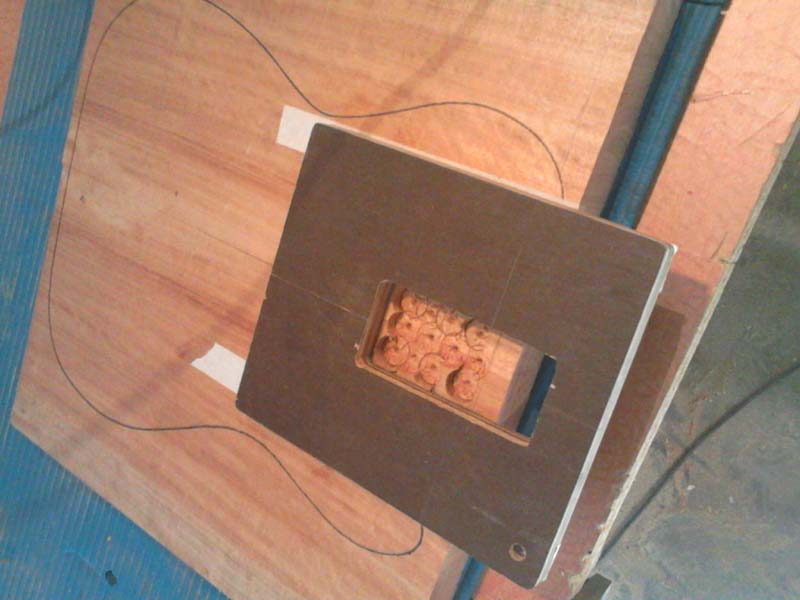

    Positioned the template and held down using the masking tape/super glue trick.
    Routed the pocket without incident.

    nice one Barge, so how hard is the silkwood to cut ?

    And a really nice fit, I can relax now.
    Being part of the maple family, it's pretty hard and brittle but luckily I got away without any chipping.
    nice one, so how thick is the blank 40 or 45mm ?
    not sure what width you need for an archtop.

    From memory it was 43mm, so should be heaps for a nice carve on top, I'll make it work one way or another.
