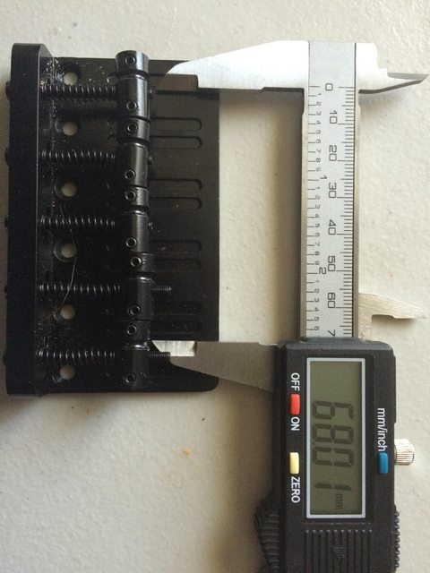

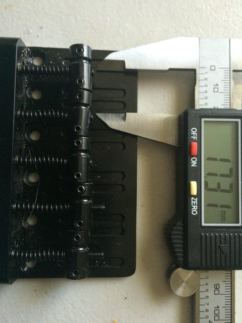

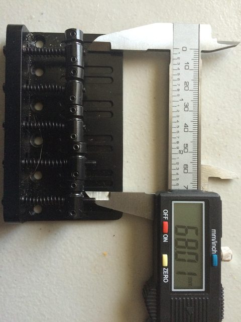

    Here's the bridge supplied in my IB-5 kit.
    Measured up as 68 mm total spacing with 17mm string width. (68/4 = 17 so that agrees at least).

    This link shows the basic specs for a Warwick bass- given that they're usually adjustable to the player's taste.
    http://www.warwickbass.com/en/Framus...-Question.html
    Standard Warwick 5string basses have a start spacing of 16.5mm, so you should find the IB-5 spacing very familiar.
