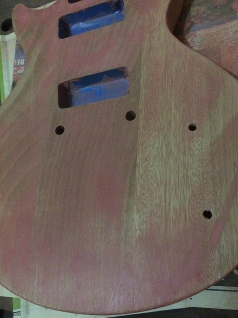

    So I got the body back from being routed yesterday.
    I don't have a proper router, so I had this done.
    The original bridge pickup route has been enlarged to take a soapbar P90 instead of the provided dogear.
    A neck pickup route has been added.
    I have a set of Orpheus '58 style P90 pickups made by local David Paul that I'll be installing.
    - Sam
    IB-6S - done.
    nice one Sam. A Neck pickup will make this a unique Jr build and give you heaps more sounds.
    Has the person thats done the routing drilled a hole from neck to bridge pup ? You will need a really long drill bit to do this if he hasn't. You might have to enlarge the hole from bridge pup cavity to control cavity to fit the extra wires. Are the pickups just a hot and earth wire or 4 wires (splittable) ?
    Also you will need a switch so you may have to ditch the tone pot or make the cavity bigger for a switch?
    Looking at the distance between the 2 holes you may fit a switch between them

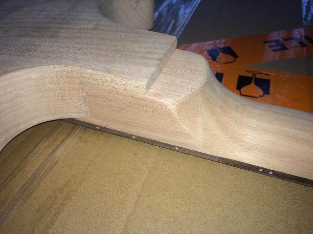

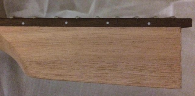

    I was inspecting this closer when I noticed this - no idea why I didn't notice when I originally unpacked it.
    When the neck is in the pocket, and flush against the back, there is gap at the end.
    This can't be pushed further into the pocket. The heel of the neck is angled - presumably to angle the neck back and lower the action. However, the pocket is at 90 degrees, this leaves a gap.
    Should that be shaped so that it fits snug, or shimmed?
    It seems that the glue would only be contacting wood to wood on three sides.
