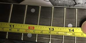

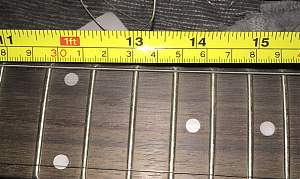

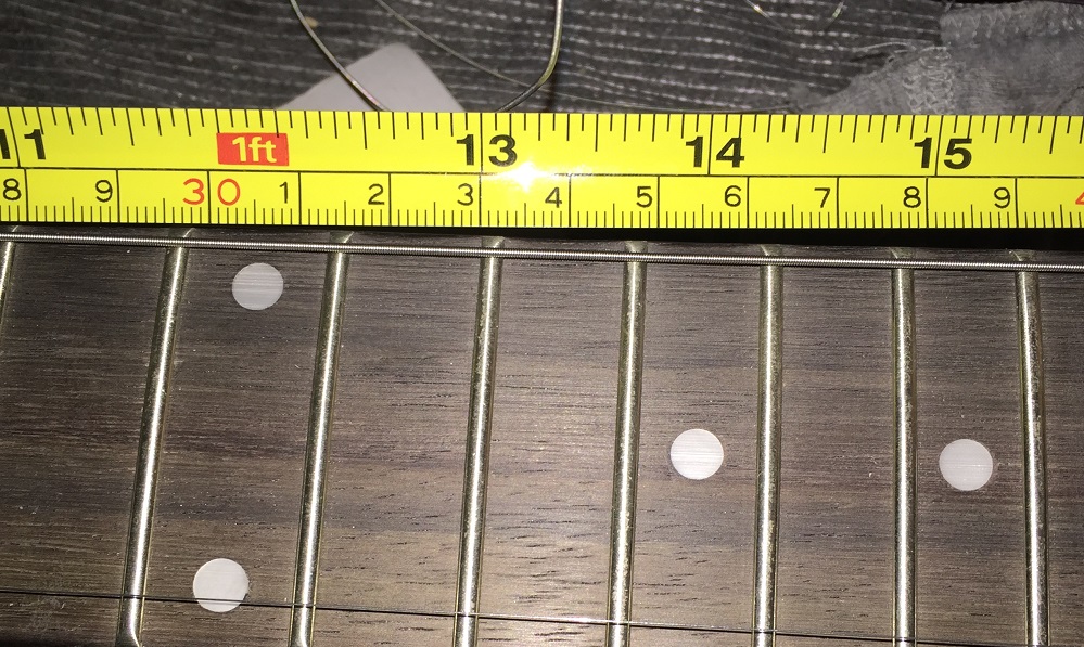

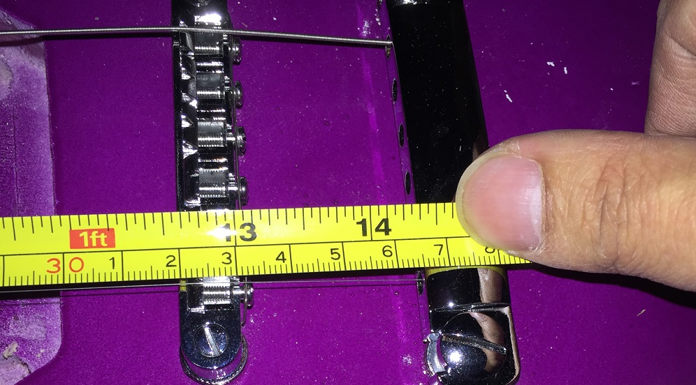

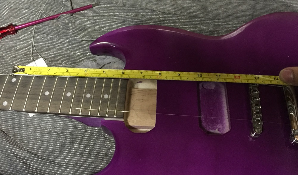

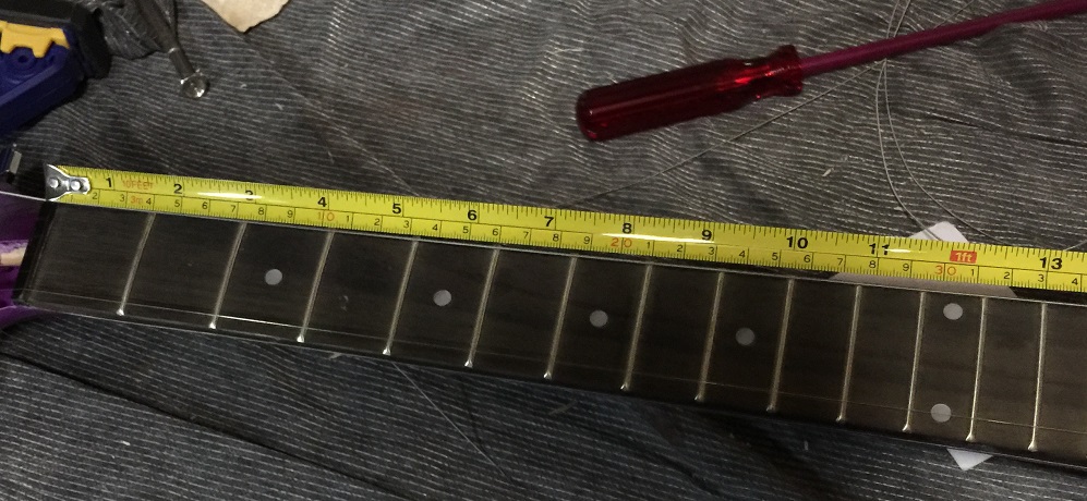

    Was mocking up the guitar so I could begin glueing the neck. I'm not sure if these measurements seems right to you.
    The Nut to 12th Fret is around the 305 mm mark
    12th Fret to saddle pushed all the way forward gives me around 322mm.
    Does this seem correct?
    *PS: Strings are inverted due to being left handed guitar.
    Nut to 12th Fret

    12th Fret to Saddle Forward

    Devon you need to measure to centre of 12th fret not the fret marker. You should find nut to 12th fret about 313mm. Now check Centre of 12th fret to bridge will be less than 322mm. Probably will measure about 315mm which is spot on for low E string as long as saddles have movement so Centre them and measure.
    Purple finish looking great
    ohhhh to the actual fret wire.
    Yeah 313mm from the nut.
    312mm ish to the forward saddle.
    That's an awesome tolerance.
    Thanks Woks.
