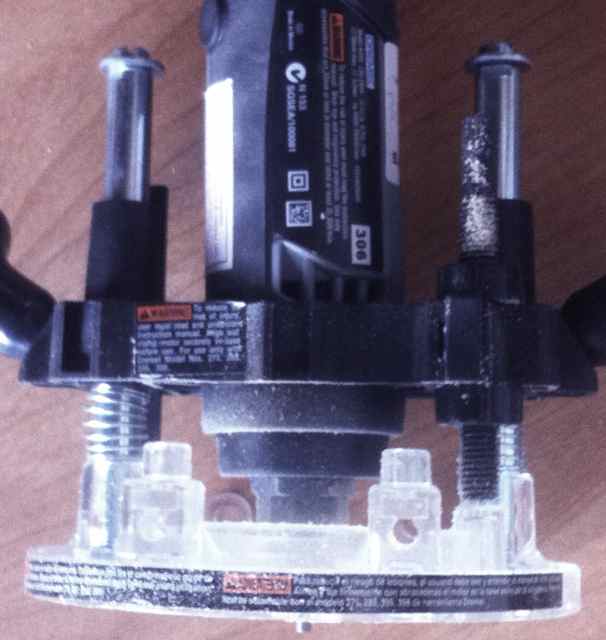

    I was using one of the new dremel tools that has an automatic locking system, which failed to lock the bit in tightly enough. It took a long time (3 months!) to get Bunnings to concede that the fault was with the tool and finally give me a refund. I subsequently bought an older dremel that has a manual locking system and went about cutting the binding channel again.

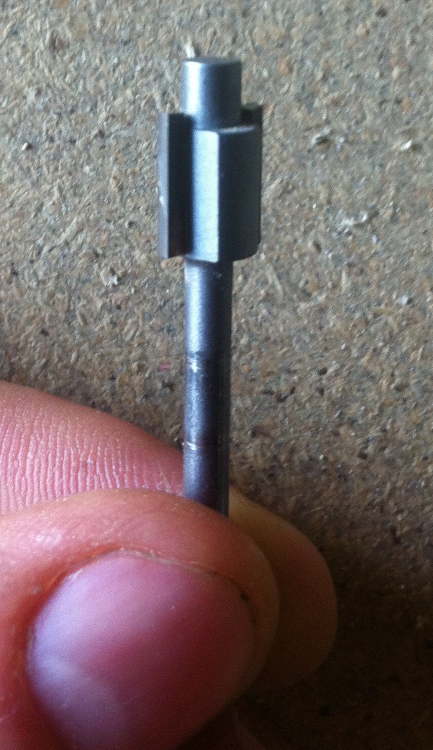

    I used the stew mac dremel routing bit along with the dremel router attachment, which worked really well. It cut cleanly and didn't leave any burn marks as some of the stew mac reviews suggested.

    The tool I used for the binding

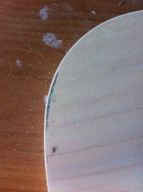

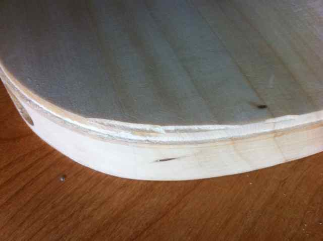

    The gouge from the slipped router bit!

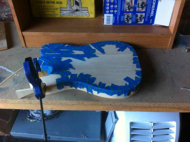

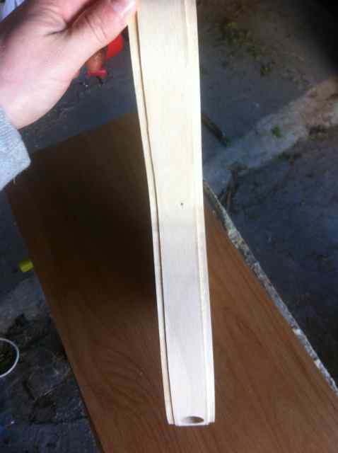

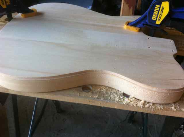

    The routing process
Name:	routing binding channel.jpg
ID:	3875   Click image for larger version.
Name:	routing binding channel 2.jpg
ID:	3876   Click image for larger version.
    wow nice gouge, hope you managed a workaround ?

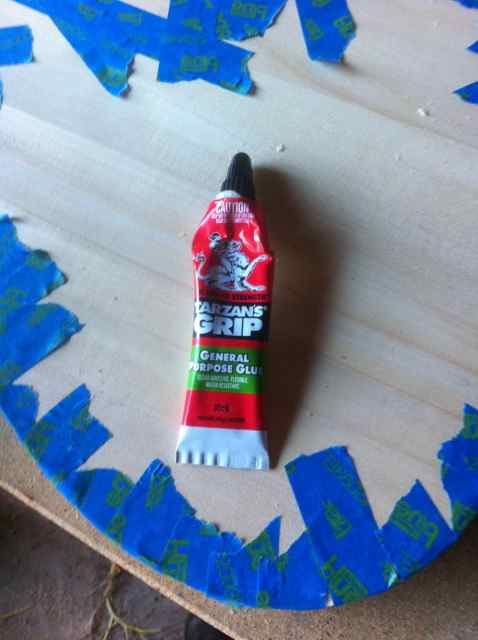

    The gouge patch up. I initially filled the gouge with unmixed timbermate, which looked good but it didn't seem very durable so I filled it with titebond glue and sawdust, which looks pretty messy in this photo but it is perfectly flat, smooth and flush with the binding.
Name:	gouge patch up.jpg
    so you're putting solid paint on top, sides and back anyway so the colour change won't matter on the repaired gouge area

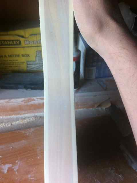

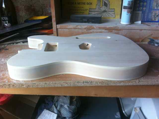

    Here is the finished binding. I'm really happy with how it has turned out. It took bloody ages to get it how I wanted it, but it was certainly worthwhile. I think i sanded a little too much (is there such a thing?!) in some bits, which left the binding slightly thinner in some areas. Not particularly noticeable though.
Name:	finished binding 1.jpg
ID:	3879   Click image for larger version.
Name:	finished binding 2.jpg

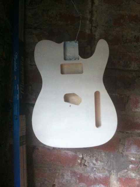

    I applied a layer of thinned timbermate to the body and once that had dried i commenced sanding this down to 1200 grit.
