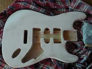

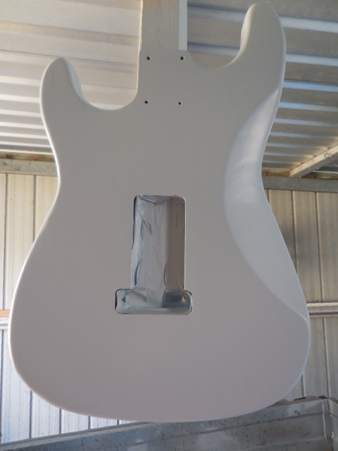

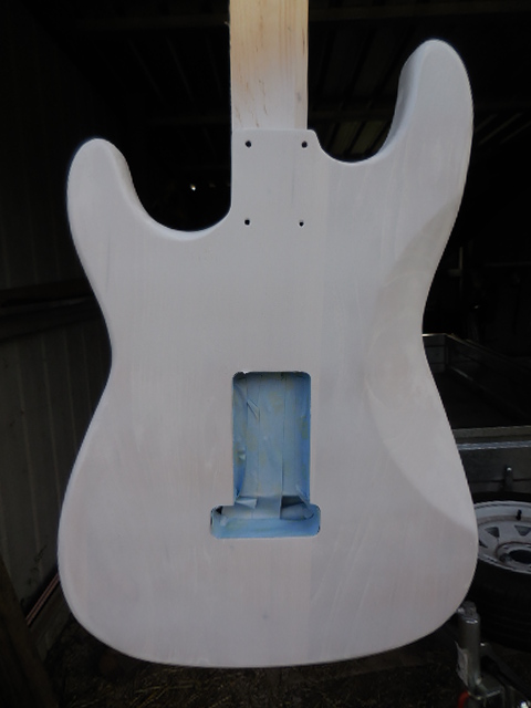

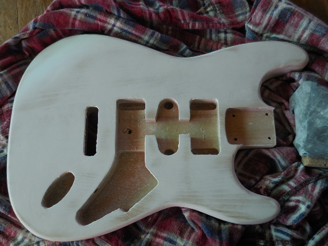

Name:	Finished sanding Timbermate.JPG

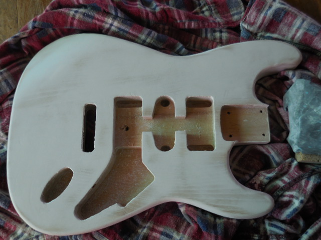

Name:	backside 2 coat of primer.JPG
    So here are some progress shots of both the front and back. I know I started out wanting a solid white, but then, the aged look sort of grew on me. I guess we'll see how it all turns out. While I'm doing this I'm also wiring up the pickups. I will post some shots of that too.
    nDR01d
    looking good, is it more of an antique white?
    Member nDR01d's Avatar
    May 2015
    Near Warwick/Toowoomba, Qld.
    131
    So far. Although you could also say it's semi-antiqued with the way it looks atm. The wood grain showing through in places is growing on me. The timbermate and duplicolor primer are "white". I have a custom Colour Spec can from supercheap auto that is "Winter White" which is as close to "Olympic White" as I could get.
    nDR01d

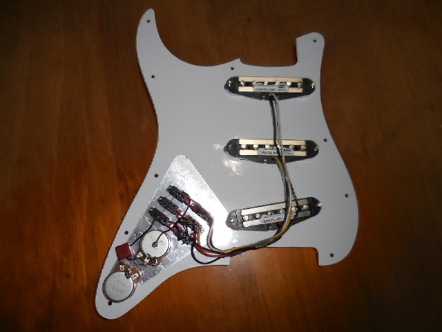

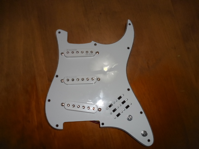

ID:	4031Click image for larger version.
    Here isthe pickguard I've gone with. It's a Brian May set up (in/out phase etc). Plus I also have the Entwistle Neodymium pickups. Lord, I hope I wired that up correctly. It took me 2 days. I'm not that great at soldering. I probably should have started off with something more straightforward. But hey, I've always been more of a fan of being thrown in the deep end first.
