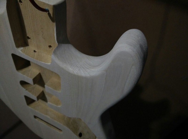

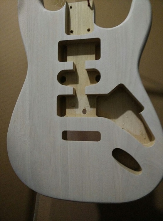

    Hey guys,
    finished this awhile ago.
    Body: Ash strat
    Neck: Used an old neck lying around
    Inlays: Upgraded to abalone dots
    Wood stain: White acrylic paint - we diluted it slightly with water (they only cost $2.50!, but results were amazing!)
    Here's how it looked like after sanding the body down and staining it with many coats of the white paint.
ID:	3617   Click image for larger version.

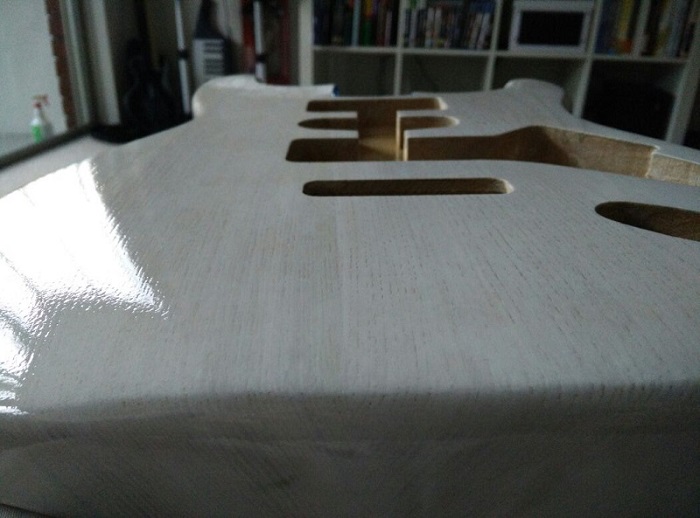

    Olympic White Strat (cont.)
    And here's what it looked like after spraying numerous coats of acrylic lacquer.

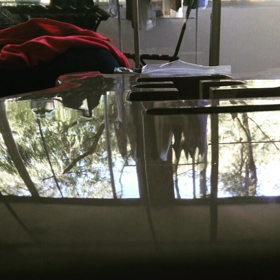

    And... it looked really gorgeous after wet sanding with 1200, 1500 and 2000 grit
    and buffing it up with MeGuiar's 105 and 205.
    Just look at the reflection of the tree outside our balcony!

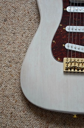

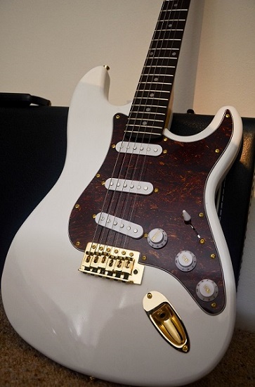

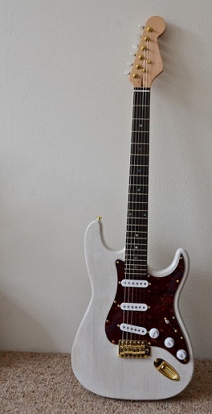

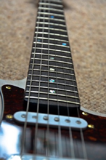

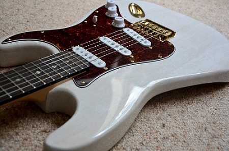

    And here's the final look!
ID:	3621   Click image for larger version.
ID:	3622   Click image for larger version.
ID:	3623   Click image for larger version.
ID:	3624   Click image for larger version.

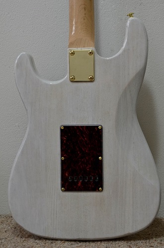

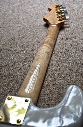

    More photos
ID:	3626   Click image for larger version.
ID:	3627   Click image for larger version.

    It's so shiny. Looks factory made. Got any pics of the neck in less light? Looks like a nice figure. Great work
    Nice one. Good amount of grain showing through from body and like the abalone markers. Great finish
    finish is superb, and looks real classy with the tort pick guard and gold bits
    Amazing job Simon! Any chance of a sound demo? Fantastic build. The white acrylic paint is a real surprise!
    Jan 2013
    3,162
    Nice job Simon! Now sound demo ASAP!!!!
