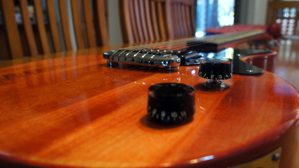

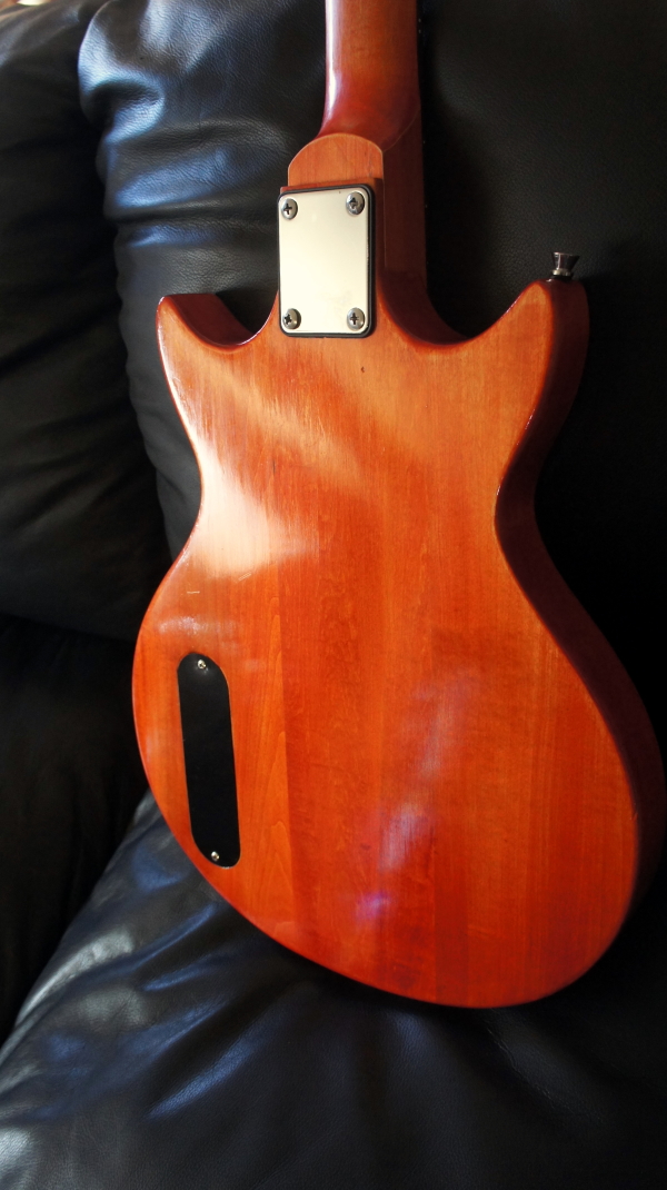

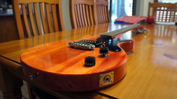

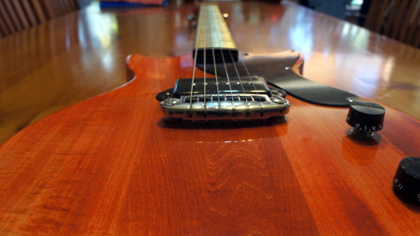

    Here is my entry in the months competition, my Sonoro Junior Supreme.
    It is the JR-1DC with a few mods. They are Gotoh locking tuners, Bare Knuckles "Supermassive" P90 PUP, Graphtech Resomax Wraparound bridge and a custom "Cocked Wah" wiring harness with Mojo Dijon caps (22uf &47uf), switchable by a push/pull volume pot. Stained with Wudtone Carmine Gypsy on the back and a combination of Carmine Gypsy and Hot Auburn on the front. Finished with 6 coats of Tru-Oil on the neck, and a combination of Tru-Oil and Feast Watson Wipe-On Poly on the Body (about 10 coats I think).
    I will post a link to a facebook video of my son Patrick playing along with "If You Want Blood" by AC/DC. Enjoy!
    more to come...
    Glossy as. I've never managed to get a proper gloss.

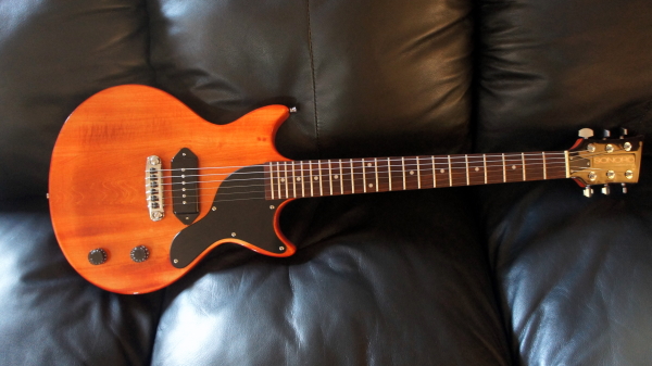

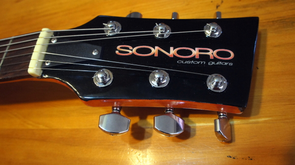

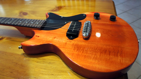

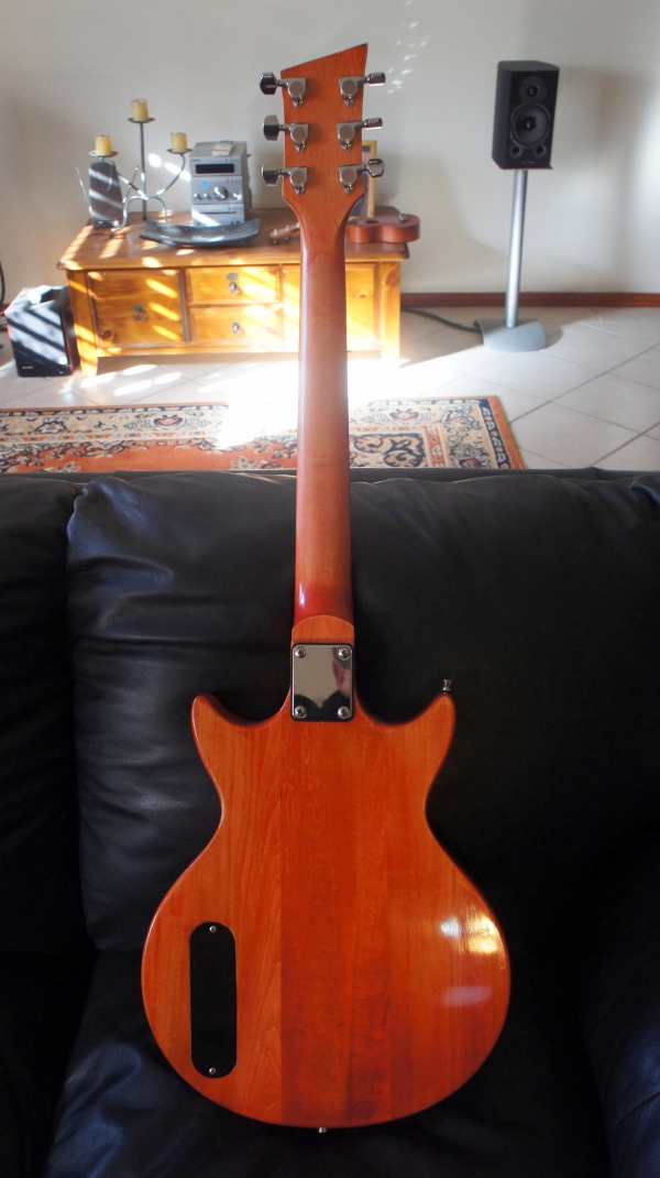

    more Sonoro photos...
    edit: I almost forgot the full frontal shot
    and the video, I tried to embed but couldn't so heres the link:
    https://www.facebook.com/duddings/vi...1/?pnref=story

    Great start to July GOTM. I love these LP Jnr kits and you've produced an excellent axe from one. Love the demo. Sounds awesome
    Jan 2013
    3,162
    Nice job Simon, looks (and sounds) fantastic!

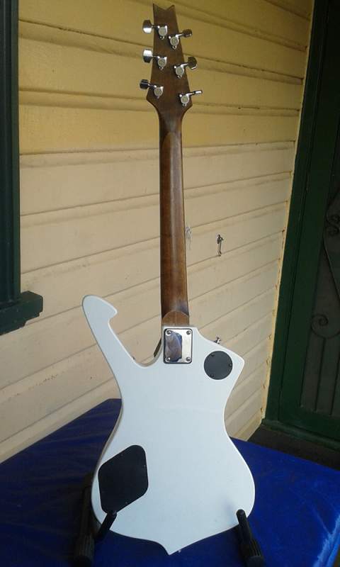

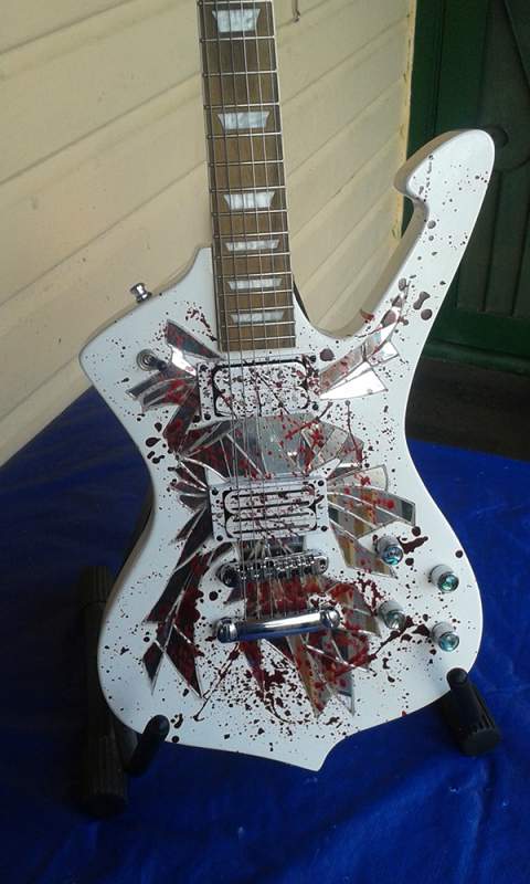

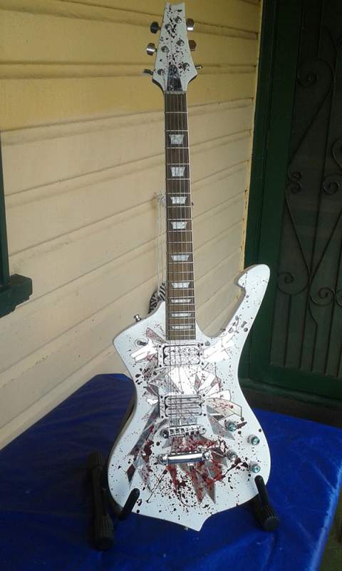

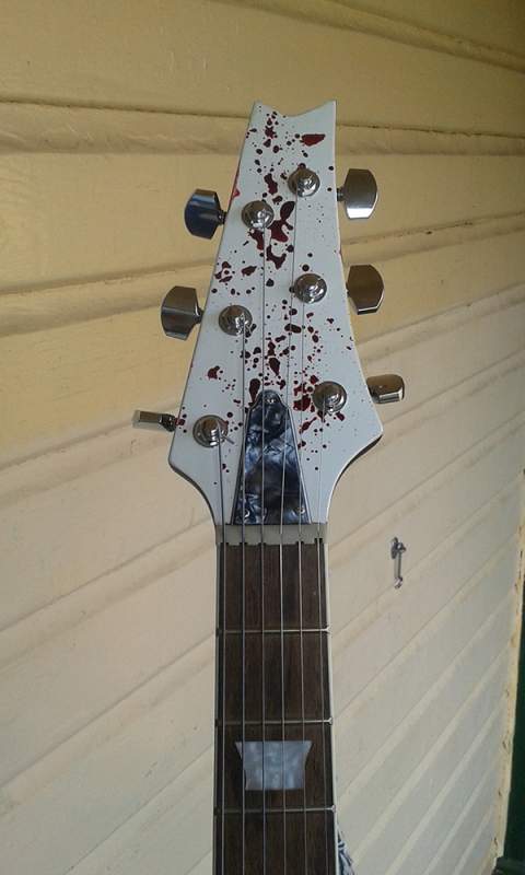

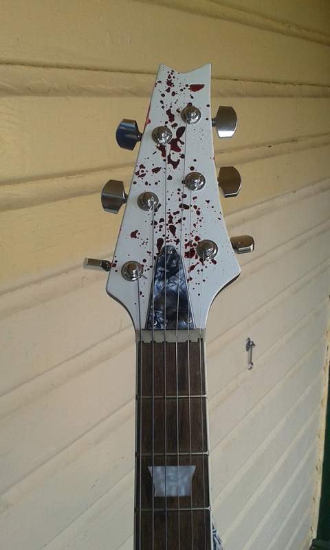

    Here is my entry to the guitar of the month.It is the iceman kit.The upgrades include Gotoh locking tuners,An Earvana nut (not sure it was worth the $40,and Kent Armstrong pickups.As with all my guitars I replace the bridge with a roller unit.The tone pots are pots which I've modified into No-load Pots usinf youtube videos.The last Tru-oil I bought came as a set wth some walnut stain and Conditioner so I used the stain and the Tru-oil on the neck.With the white body it reminds me of a marzipan wedding cake.
    The body I decided to do a variation of the cracked mirror Paul Stanley Iceman.As I cut intricate glass shapes every day it was no problem cutting the mirror.I drew the guitar top to scale,worked out the design,allowing islands of timber where the pickup ring screws go and around the bridge post holes.I photo copied the desigh and cut out the paper templates of the mirror pieces.I chiselled out recesses for all the mirror and got the guys who spray polyurethne kitchen doors to spray the body white.I then inlaid all the mirror,and used No-more gaps to fill inbetween the glass pieces.All the glass has been edge ground so despite the faux blood,you can't cut yourself.I love Dexter and his blood splatter posters.Also it is 5 years since I slashed by artery in my wrist so using Dexter's posters and my memory,I mixed some Clear Red and Rust Brown Tamiya paint to make the faux-blood which I splattered judiciously over the guitar.Abalone topped chrome knobs finished the build.
    The electrics were a nightmare on this guitar .When I tested it the Tone knobs were not working,the volumes only worked from about 85% on.I pulled every thing apart and wired each pickup to an output jack and tones seperately.They worked fine,but when I hooked everything back up to the switch,the same problem as before.I knew the switch was to blame.I used wire-braided vintage cable on the switch to jack.As I always use conductive paint to shield all cavities,it seems that somewhere the braid was causing a short.After I changed the braid out for regular insulated cable everything worked out fine.

    Photos received from TomL, his Dexter inspired IC-1:

    Wow Tom that looks really cool and very original mods there.
    How does it sound and play ?
    One of the judges DB really loves Icemans (haha not) but if I was scoring it would get high marks for detail and difficulty of the glass inlays !
