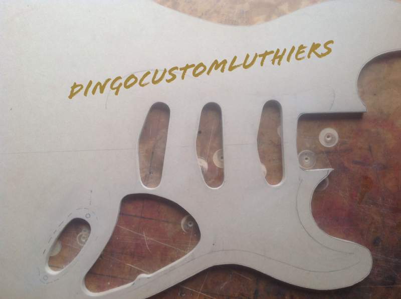

    'A good template gives good results, a great template gives great results'...
    Templates are your best friend, the end result rests on the accuracy of your templates.
    To date, I have used plywood for my templates but now I use MDF.
    I draw my design directly on the board, having established centrelines etc..
    Then drill holes for jigsaw access and then cut the pup, control cavities first.

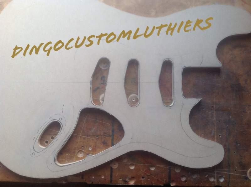

    A better pic...
    Next job is to tidy it up...

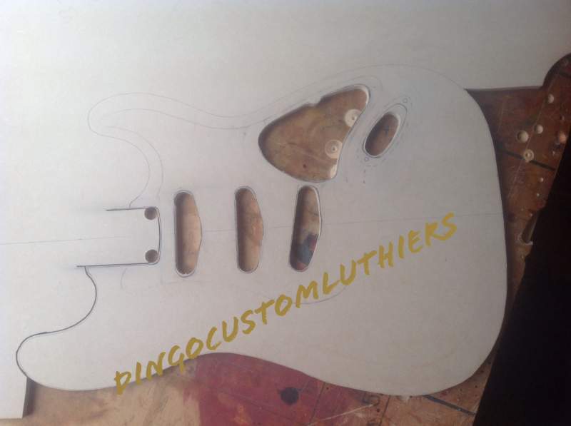

    Ok, here it is with cavity routs cleaned up on the bobbin sander.
    Next step is to supa goo the edgdes before final cleanup..
    Great DB - thanks so much for this thread. Supergooing the edges is a genius move! Currently I am in the position that I have never made a template that hasn't been ruined the first time i got the router on to it. I'm learning very slowly. Any pointers on using your templates without stuffing them with the router would be greatly appreciated .
    @ Gav easy bro, just make sure all the edges of the templates have been super glued, make sure 100% of the bearing on the router bit is in contact with the edge of the template.
    Worth checking regularly too. I've seen a body blank ruined because the clamp on the router height adjustment wasn't tight and the router tore a big chunk out of the blank
  8. Liked by: dingobass
    Yep. Guilty of that one too, Woks..
    There are still a few things to do yet.
    Clamp to body that was pre shaped by hand.
    Rout outside profile.
    Make a copy, with neck heel shape.
    Supagoo this template...
    These guys are my master templates, I will have copies for use in the Man Cave..
    Is this because the MDF gives a better edge finish than the ply? what thickness of MDF, 1/2" or thinner?
    Moderator dingobass's Avatar
    4,491
    Hey Franken, main reason is MDF once sealed is far more stable than ply.
