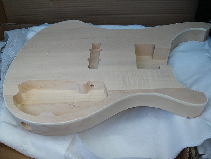

    I received my RC-4 kit a few days back and started the build today with sanding the body. Don't worry guys - you will get pictures when I get the chance to add them...

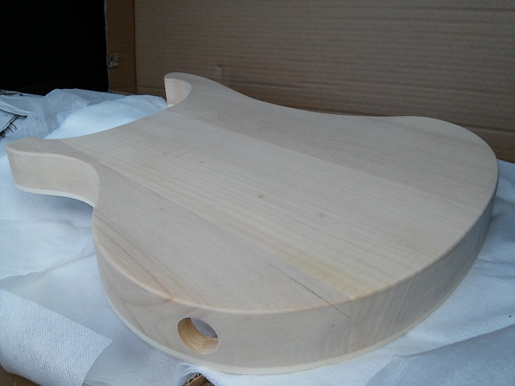

    Sanded it with 180 and 240 grit for about 3 hours. The reason for huge anount of sanding was that a part of the body seemed to have a bit of unwanted saw marks (looked mostly like the surface of maple tops). Maybe caused by different quality planks glued on the body - maybe? Anyway - after I stuffed my lungs with saw dust and found out that I could not get these marks totally removed without thinning the whole bodyblank - I decided to let these marks stay for now, because I think they will add to my vision of "the cole" color theme.
    Oh - about the color... I decided to go with black and red. Had a vision of doing it like this:
    First a coat of black on the top. Then sanding it away fronm the center gradually and maybe adding a bit on the outlines for a little burst effect - still leaving some in the center to pop the grains. Then putting the red on the black. Same on the top of the headstock. The sides and back would be black - except maybe the part with of the back where the sawmarks are... there I just might use a bit of red on darker black to highlight the "unwanted". Din't know yet what will be the decision. The back of the neck would be black too.

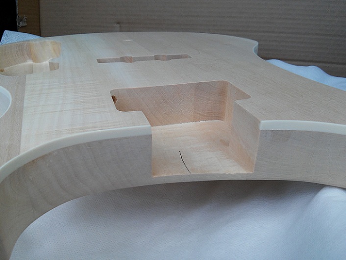

    A few pics
    A few pics of the body after sanding. Not the best light but shows what I was talking about.

    Hi Arzi, looking good and worth the time sanding will pay off. Basswood can have some strange grain, sure the lines aren't grain and not machine marks ? Pretty hard to see from the pics.
    Colour theme sounds great !
    Yeah, if you are talking about the markings below the neck pickup rout, that looks like flaming. A pity it will be hidden by the pickguard.

    Hi
    Yes it looks like flaming and it's almost covered by the pickguard eventually. The surface was quite uneven on top of it and my mind was set on a consistent looking grain at first. Then I thought if you can't hide it - highlight it. Might just give it more personal look and I'm beginning to like the idea.
