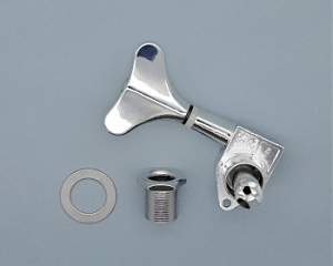

    Slight redirect of this existing thread, if anyone can help advise.
    Will these PBG modern tuners fit to a JB-4 headstock without filling or modifying the existing machine holes? As opposed to the vintage tuner that comes stock.
    http://www.pitbullguitars.com/shop/s...rome-left-1pc/

    Hey Cade, unfortunately no, they won't fit. The holes for vintage tuners are 18mm where as the modern sealed style need 12mm (I think) holes.
    Yeah, Pabs is correct.
    Just checked my EX-5 as it has those smaller style ones and they look to be about 12mm whereas the J Bass with traditional clover leafs has bushings that are most likely covering up around 18mm holes.
    Only solution is to plug with dowel and then apply a solid colour on headstock face to hide the mods.
    Traditional Fender large hole size is 11/16", which is around 17.3mm.
