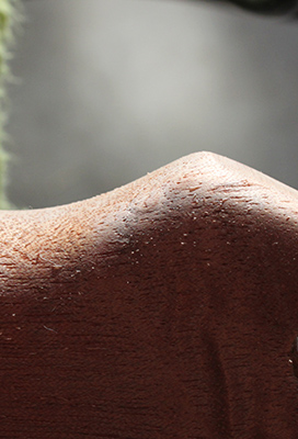

    After much sanding, I was de-dusting with a brush and whack.
Name:	Headstock dent 01.jpg

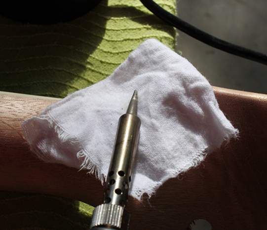

    So time for the old gun smiths trick:
    A bit of wet Four by Two (or flannelette) and heat it with a soldering iron. The heat forces moisture into the timber re-expanding the cells.
Name:	Headstock dent 02.jpg
    To end up with:

    Must remember this one!
    That's a magic trick! One for my hints and tips notebook. Thanks for sharing.
    great save
    Jan 2013
    3,162
    One of my favourite tricks in the book!
    Mentor Rabbitz's Avatar
    Apr 2015
    774
    Yeah, I can't claim it for my own.
    A club armourer showed me that trick when I dinged my Dad's target rifle. I must have been 14 or 15 at the time. The soldering iron wasn't quite so modern for that repair...
