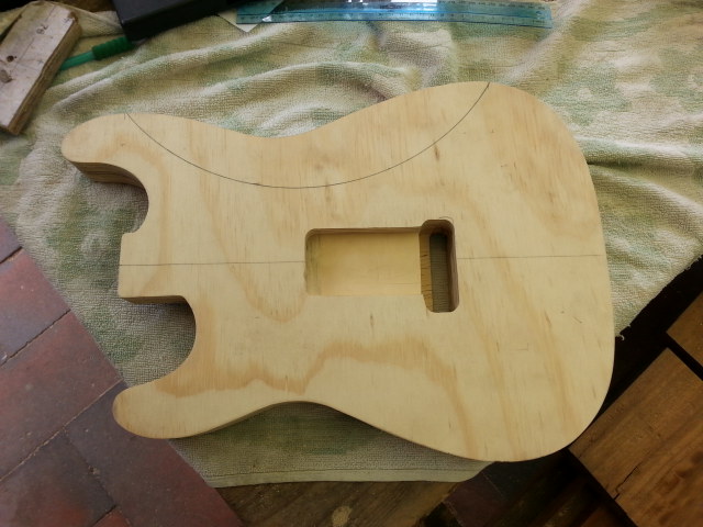

    Current update. I decided to use some free ply as my first guitar body and work out any problems before attacking my good spotted gum.
    I will get 3 necks out of my neck slab so will go with spotted gum for the first neck. I have cut out and glued 3sheets of ply ( 17mm+17mm free + 12mm from Bunnings ) together and routed all cavities and the edges and given it a trial prime to show up all my mistakes. Yikes...
    The free ply used for the front chipped out while using the jigsaw but the back top quality stuff looks great. No more free ply...
    So far so good.

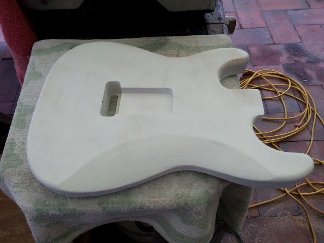

    Here are my latest pics..
    Have shaped the back and front and primed. You can really see the chips out of the free ply now. Oh well. Some spakfilla will hide that.
    Routered the front of the neck and drilled and trial fitted the tuners. Will have a go at blending in the head to neck later today.
    Also giving the whole body a coating of spakfilla to fill grain and holes and chips so should look a lot smoother tomorrow.
    Actually starting to look like a guitar.
