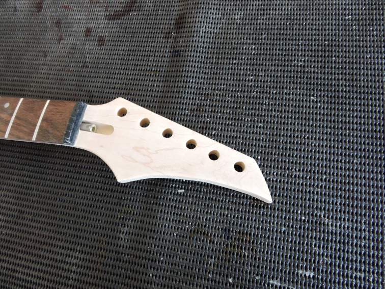

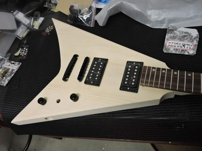

    Building a V for for Cousins son for his Birthday.
    Looking at Black japan for the back and if can get it to work flame veneer on front done in a Purple flame.
    Upgrades.
    Gotoh bridge and tailpiece
    Locking Tuners
    Blackstar Neo pickups
    Bone Nut

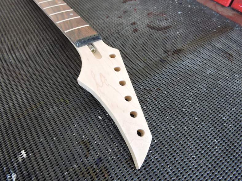

    Have shaped the headstock and will have tuners raked back.

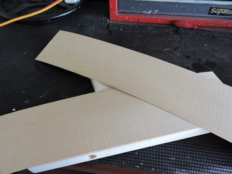

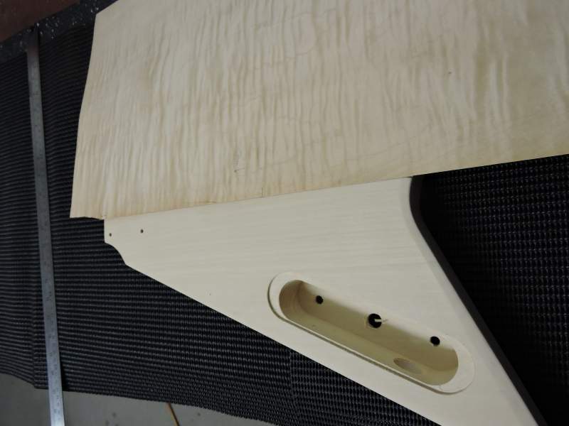

    Veneer comes close for a fit. Not sure how a small "splice" will look at the botton

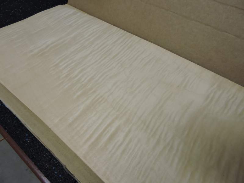

    Got some different veneer as couldnt get the other stuff to fit without having to do some sort of insert.
    Now going to do front and back. sides will be black, and front and back purple- deciding on whether straight colour or blacked and burst first.

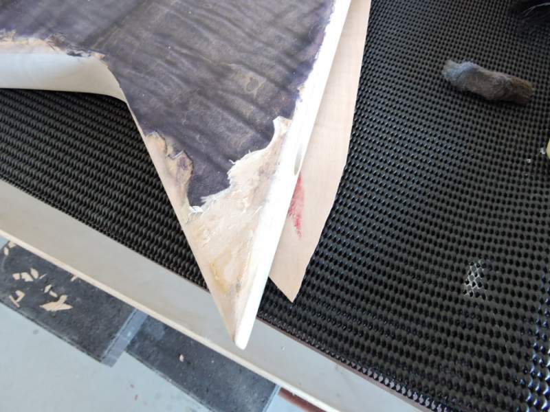

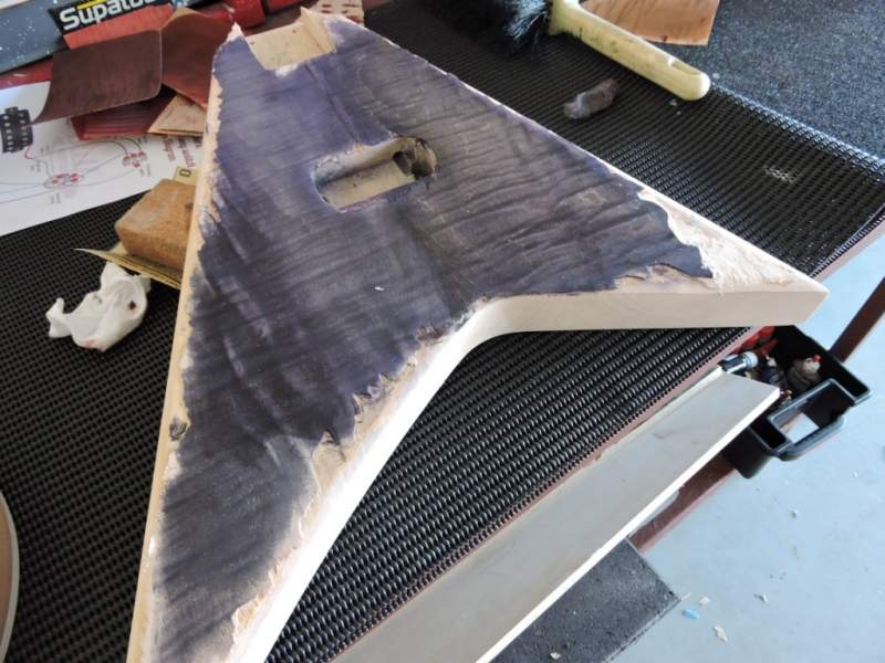

    oops. experiencing some minor technical difficulties.
    So applied the veneer to the front and braced using the "Paver 2000" professional bracing system only to find a week later that the upper half veneer was seriously bubbled.After trying the hot iron method to flatten, to no avail, decided to pull it off after seeing what the colour I wanted looked like. So in take 2 will be the similar to the colour around the knobs. Black wash then the purplish colour.
    So to get the veneer off will run through a mates thicknesser to clean up the top and have another crack. Another problem I think is getting the guitar edges which are beveled to look like a clean edge to the flat top.
