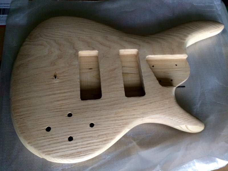

    Body in Nullarbor Ochre. Got a colourless neck finish kit as well.

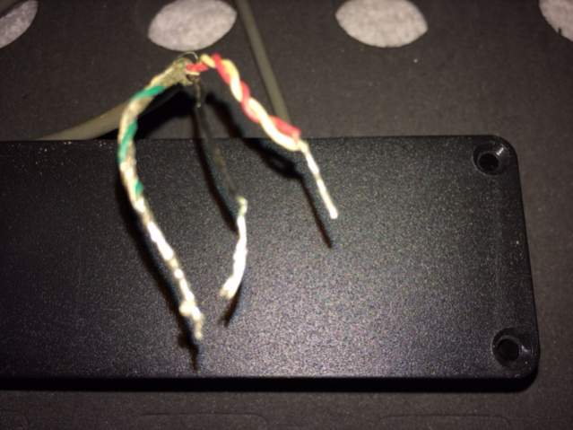

    The pickups... the wiring diagram, http://www.pitbullguitars.com/wp-con...s/pdf/IB-5.pdf, shows bridge and neck pickup with 2-wire connections.
    The kit was supplied with pups with 3-wire connections.
    Not sure how to connect that.
    I'm also not sure if the neck and bridge pickup are supposed to be different. The two are identical in appearance. (I recall single coil jazz pickups have a different resistance/coil windings for neck and bridge.)
    Welcome Tindrrel.
    Earlier versions of the IB-5 just had 2 wire pickups, so it looks like the factory has updated the pups. The photo is not quite sharp enough to be certain, but it looks they've just added the coil series link wires makng it a 4 wire pup. If the red/white twisted pair are soldered at the tip then they should be the series link between the two coils within the pickup. That means the green and black are your ground and hot wires (matching the two wires in the wiring diagram). If that's a bare wire twisted with the green then that should be the ground and the black would be your hot. Just put some insulating tape on the series link tip so it can't short with anything. I can't be certain without a better pic, but that's my best guess without access to one of the new pups to test.
    If you have a multimeter you can check which wires are which and it would also tell you which pup has the higher resistance (bridge is usually slightly higher than neck). Also, the factory typically makes the wires on the neck pup slightly longer than the bridge, so that may be another way to tell them apart.
    Sorry, I should have described the wires as well.
    Theres a black one. Figures that would be ground.
    There's a green one, which appears to be twisted with a bare wire (the shielding?) and soldered at the tip
    Then there's a red and white wire twisted together and soldered at the tip.
    Testing across from black to green wire, both pickups appear to be 16K ohms.
    Testing across from red/white to black, and from red/white to green seems to be half that - so that verifies the red/white as being the series link.
    Changing the battery in my meter and checking again, one pup is 15.98K and the other is 15.92K. I'm not sure that's a significant enough difference to say one is bridge and the other neck. I might have expected at least a K difference.
    Black = hot, green/bare = ground (that matches Seymour Duncan colour coding)
    With the resistance so close it won't really matter which pup goes where, just put the one with the longest wires in the neck position.
