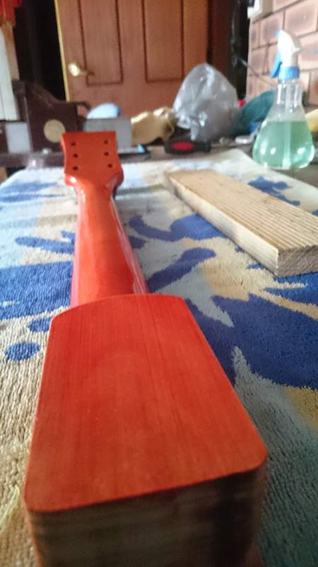

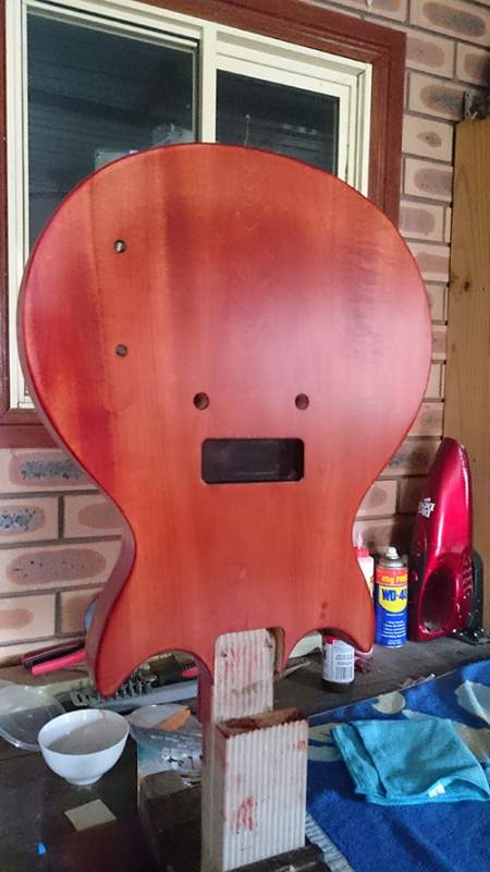

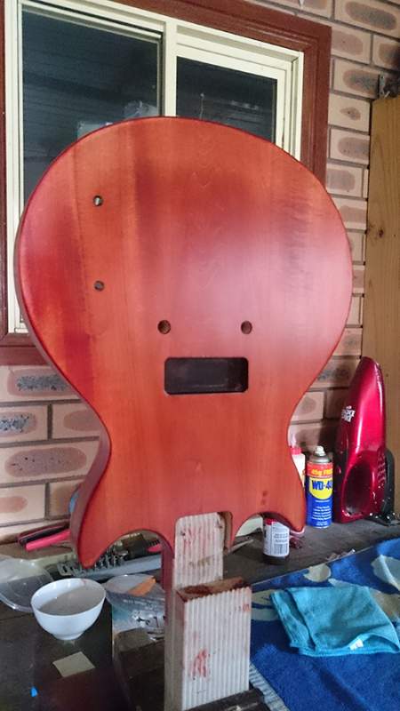

    After building this fine looking axe we were hooked so I looked around for a LP Junior and came across Pitbull Guitars.
    It has now been about three weeks since I started sanding the bejesus out of it...sanding, sanding and more sanding down to 240 as recommended by Wudtone.
    I got some Carmine Gypsy as the main colour and a bottle of Hot Auburn.
    The back and neck of the guitar are Carmine Gypsy and for the front I have combined the Carmine Gypsy with the hot Auburn for a subtle burst effect. It didn't quite work out the way I had expected but looks spectacular anyway.

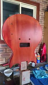

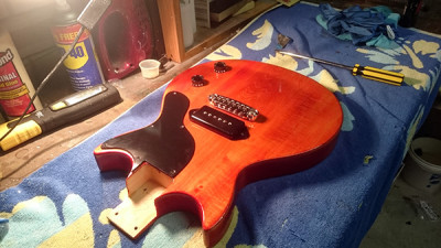

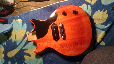

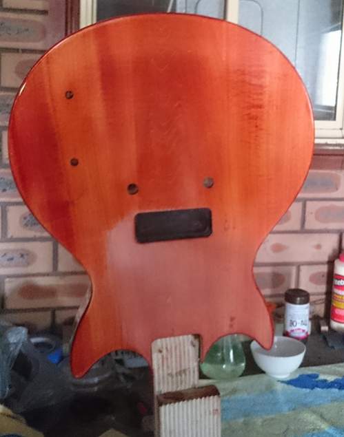

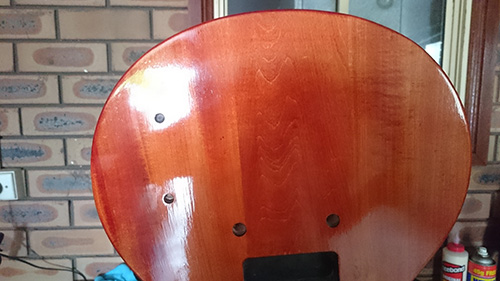

    These are images of the front and back of the body after the final coats of Wutone:
ID:	2446 Click image for larger version.

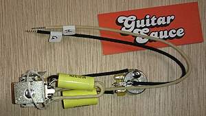

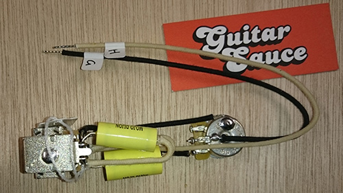

    I have decided to mod out this guitar. I have ordered a Bare Knuckles "Supermassive" P90 and asked Shaun Fricker of www.guitarsauce.com.au to make me a custom wiring harness for my Junior. It has two Mojo Dijon caps, a 22uf and a 47uf cap. It has a push/pull volume pot. It the down (normal) position the signal goes through the 22uf and in the up position goes through the 47uf capacitor. A virtual neck pickup.
ID:	2449 A work of art.

    That is such nice wiring with the harness. Why didn't you have a go yourself?
    I've always had a soft spot for Jr's. Keen to see this develop mate. Bareknuckles are amazing pups.
    Member Dajavoodoo's Avatar
    Feb 2015
    Newcastle NSW
    47
    Yes it is a nice wiring harness. Soldering is not really my strongest skill and I saw Shaun's workmanship on his site and knew that I had to get him to make my custom electrics.
