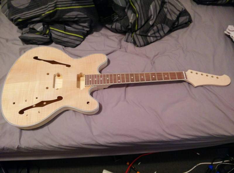

    A new build. Freshly arrived today - super fast shipping.
    It looks great.

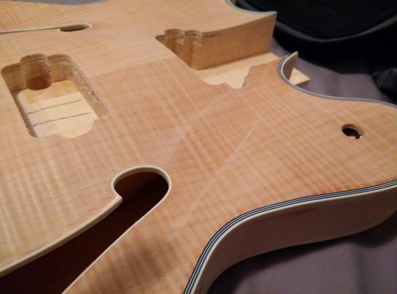

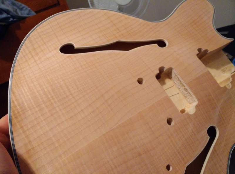

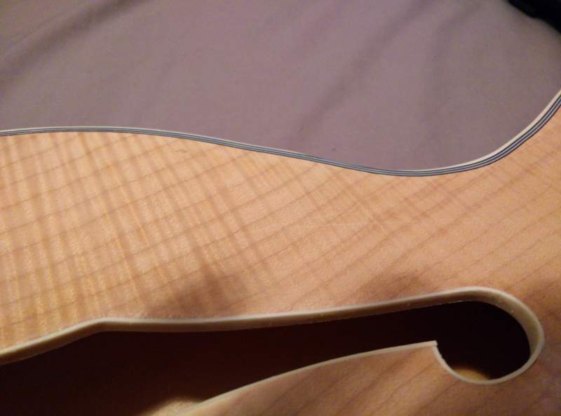

    I've never done a hollow body and it looks like there might be a cap of some sort on it. There are a few machine marks I will need to sand out.
    I've attached pictures. Should I sand them, try hide them, or should I fill them? The more obvious flaw in the photos is above the surface of the guitar (maybe glue residue or another machine mark). The other is a scratch that is maybe half a millimetre down and goes for about 8 cm.

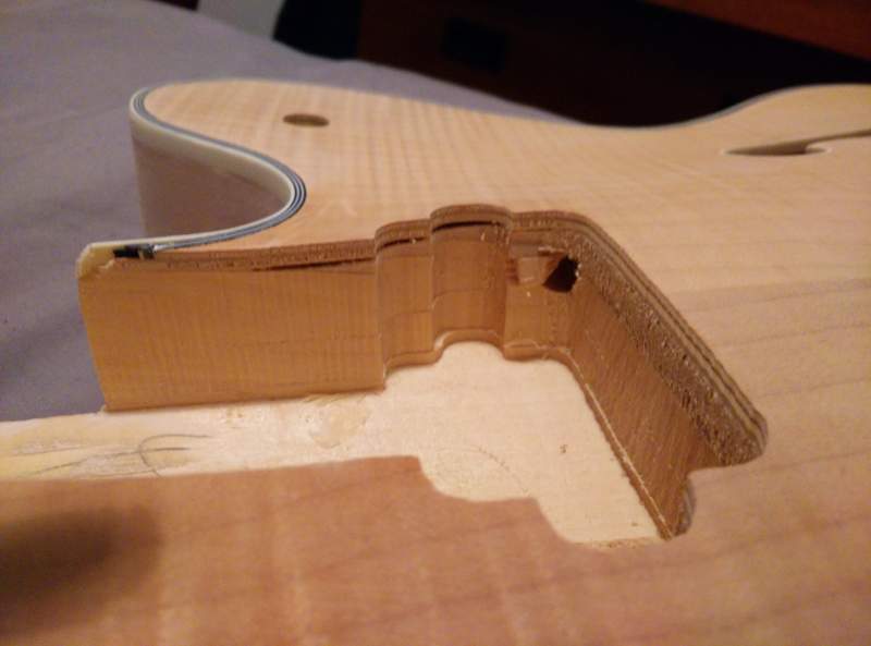

    Whats the best way to get rid of the scratch? And whats the risk of going through the cap getting rid of the other marks? There's also some separation around the neck pocket: is this a problem? The body feels solid around there...
    PS, is this a set neck or a bolt on neck? It seems like a set neck but I figured I'd ask first.

    You could try a damp rag and a warm iron to raise the scratch.
    Just be careful not to over heat as the glue holding the cap might let go....

    Whats a good grit to start on on the top of this? Straight to 400? Or is this a "don't sand you're you'll go through the cap/binding" kind of thing?
    Moderator dingobass's Avatar
    4,491
    Yep, I would go to 320 or 400.

    First cab off the ranks with the Starcaster! Looking forward to seeing this progress. Looks like the cap is symmetrical? Should come up a treat.
    Yeah I am pretty sure the way they did it was they sliced the veneer off the same block back to back and then flipped one of them upside down. Bookmatching or whatever its called, they're pretty damn close.
