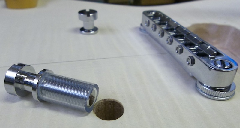

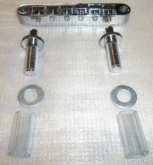

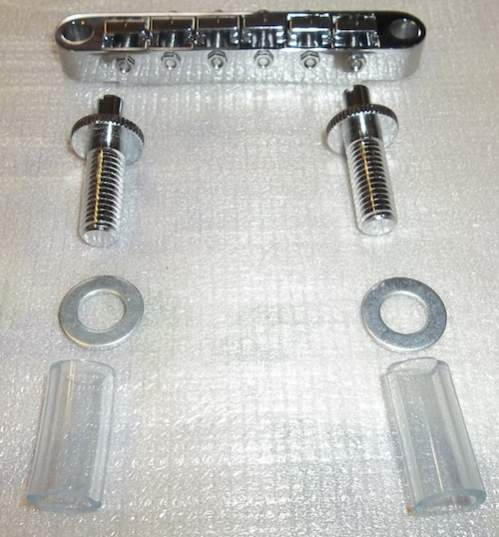

    Here's how I check/test the height of TOM bridges without installing the bushes:
    8mm (internal) vinyl tubing is the perfect size for metric bridge/tailpiece post threads and will then fit snugly into the holes instead of having to drive in (and then later remove) the bushes. A washer or two can be used to account for the rim on the bushes and then you can do your measuring and testing without the bridge sliding around.

    That's a brilliant idea Scott. At one stage when I was making the Bigsby TL I was thinking of trying to make some sort of dowel plugs for this purpose, but this is a much better idea.
