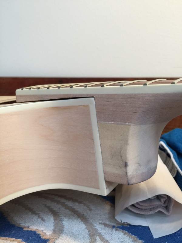

    Only question I have at this stage is about the gap between the top of the body and the neck (pictured). The heel of the neck fouls on the pocket on the back of the guitar before this area is flush with the body... Simple as sanding the neck heel lower until it comes flush or will this mess up the intonation?

    welcome Alex, you've jumped in at the deep end with this one!
    Not sure about the neck fitment on these, so hopefully someone who has done one will see it soon.
    More pics of the gap from other angles will help too: do you mean the neck angle itself, or the way the neck fits into the body?

    That could've been explained clearer. In the first picture you can see a gap between the top of the guitar and the neck, just above the binding even with the neck fitted within the pocket properly. Just wanted to know whether taking a few mm from the bottom of the neck heel to close that gap would be ill advised. More than likely I'll just clean it up and leave it as a shadow line of sorts.

    aaahhh, see what you mean Alex. Once you start playing with neck heals and pockets you can chance heights and neck angles, might leave advice on that to someone who has built one, or for DB to chime in.
    I wonder if a little timbermate filler under that part of the neck would fill it in well or chip out.

    I'm with Stan - if you're going black stain - ebony timbermate and if you're worried it will chip out - stabilise it with a bit of CA glue. If you protect the body with something (greaseproof paper?) and then get your timbermate in, you might be able to take the neck off again - let it dry, stabilise and then sand to a perfect fit. With that said, it will be on the bottom of the guitar as you play it. Downside is once it's taken CA, I don't think you'll be able to stain it (hence ebony timbermate).
    May also be worth trying a dry fit with the hardware - don't knock the posts in just yet, but running a steel rule down the fretboard and placing the bridge in the right spot underneath it will give a very rough idea if there's any room to move on the neck pocket. Maybe a photo of the base of the pocket?
    Thanks guys, some food for thought! Looks fairly plum as is with a straight edge so I think I'll just clean up the edge and leave it as is.

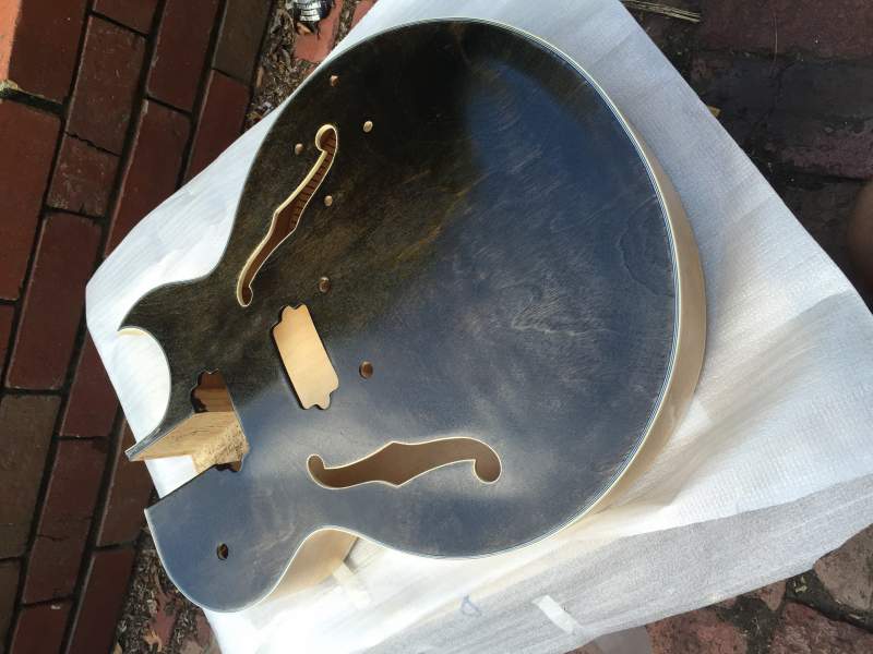

    Had wanted to fill the gap with Timberlake or something but that's gone out the window now that I think I'll leave everything natural apart from the top. Stained up the top and damp ragged the entire thing and it looks great as is!
    Three coats of Japan black feast Watson later:Click image for larger version.

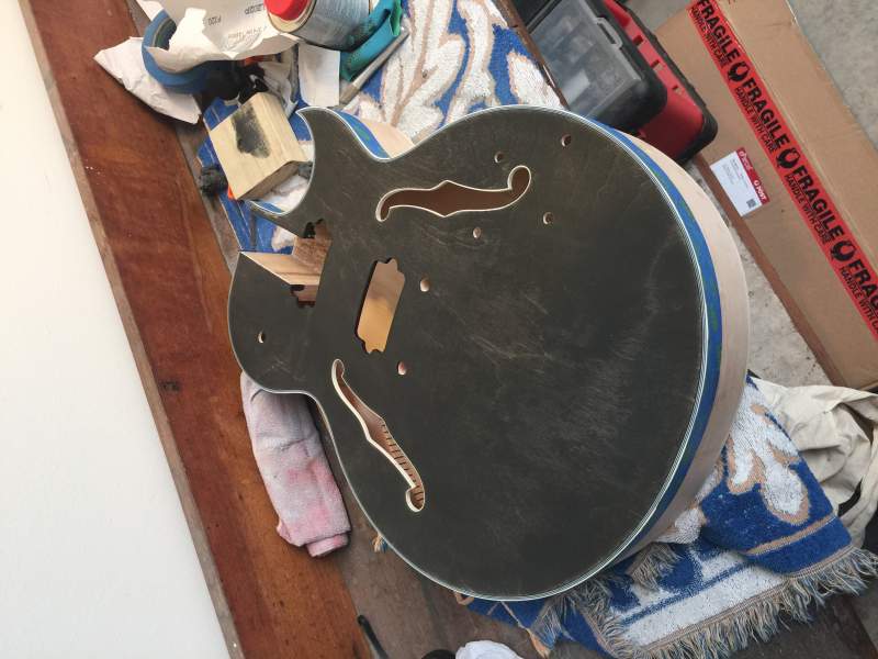

    My most recent plan is to go with master volume and tone pots and use the other two holes for mini switches for coil tapping the SD Alnico pro II set I just bought...
    Anyway we're all here for the pictures so here's two coats of Tru Oil (I've just recently come across the aversion of some forum members to both tru oil and fw stain so I'm probably about to be shunned!)
