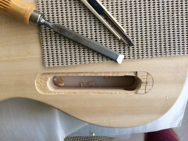

    To convert the standard TL kit body to suit a La Cab P90 I needed to reshape the routing for the pickups and do away with the front control plate route and rebate a rear access plate to the electrics. Easy huh.
    So the project begins.

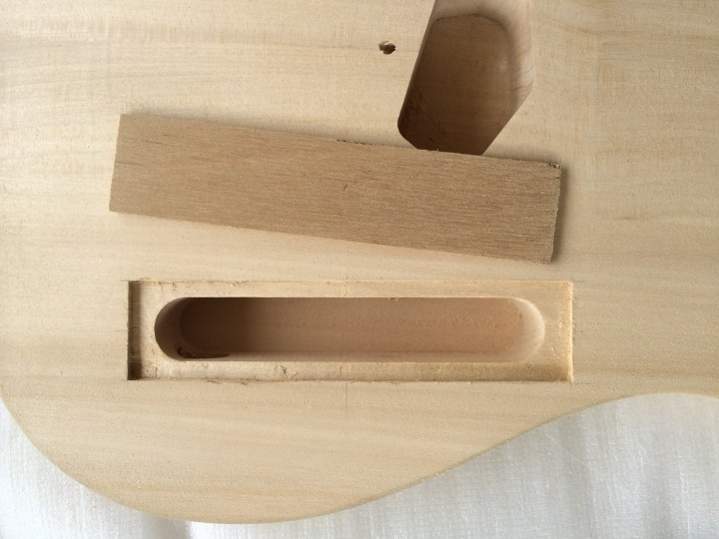

    Fill in the control panel route? Easy peasy. Cut a small piece of ply and reshape the rebate and Bob’s your proverbial. Once done I just needed to extend the control panel route all the way through to the back of the guitar and make a new cover for the back. Done.
    Pic 1. – Rebate the control panel to take new cover
    Pic 2. – New control cover ready to fit.
    Pic 3. – Cut the control access panel through to the back of the guitar and rebate for the new plastic cover

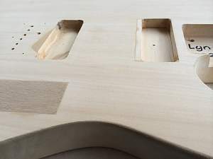

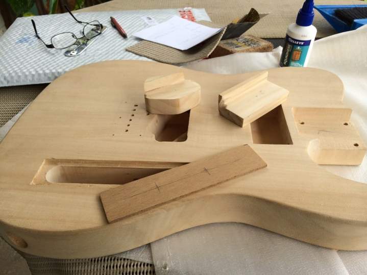

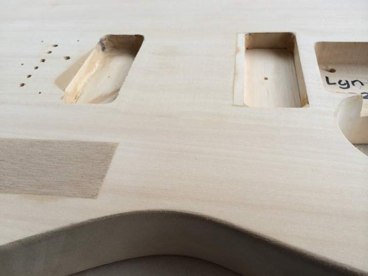

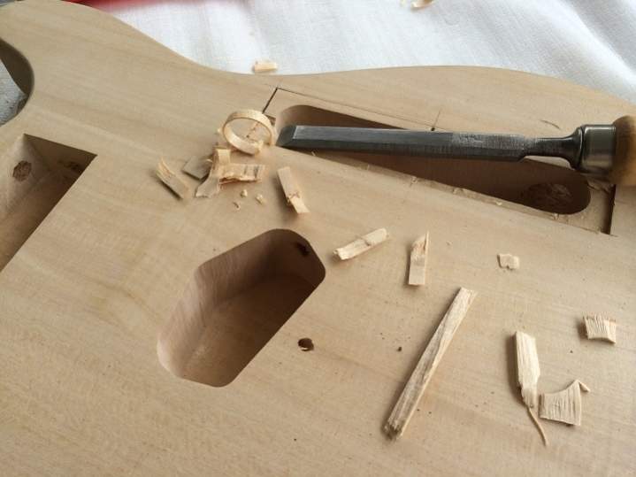

    It was then that I started on the pickup routing. Seeing that I will be using P90’s I found that both the Bridge and the Neck routing was way too deep, and the wrong shape. Especially that stupid looking Bridge routing.
    I don’t have a workshop or a router so the only solution I could think of was to make a couple of handmade “plugs” and glue them into the existing routing. I would be too embarrassed to tell you how long it took to do by hand but I think I now have them the right size to mount the P90’s properly.
    Pic 1. Handmade “plugs” to fill the routing of the standard kit to take the P90’s.

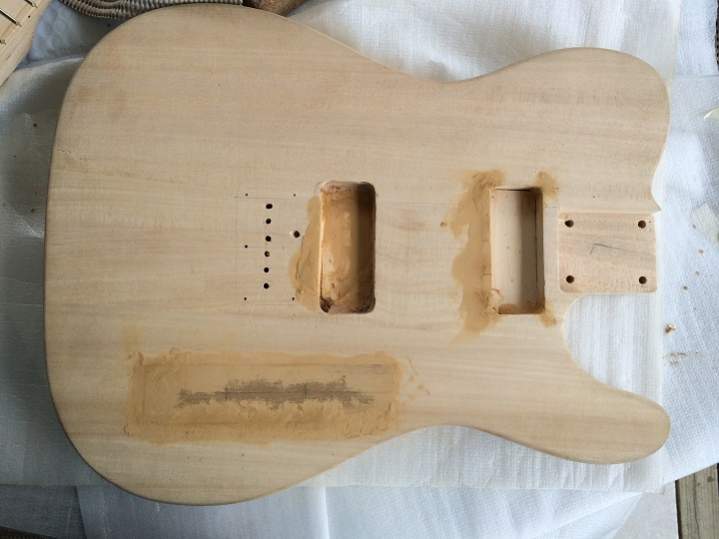

    Pic 2. – Glue plugs and control plate in position and apply WAY too much Timbermate
    Pic 3. – Sand down till its smooth as.

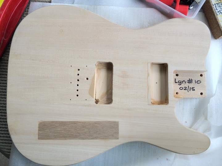

    So that’s it for now, should be starting again in a few weeks when I have finished #11
    Cheers guys
    Rob

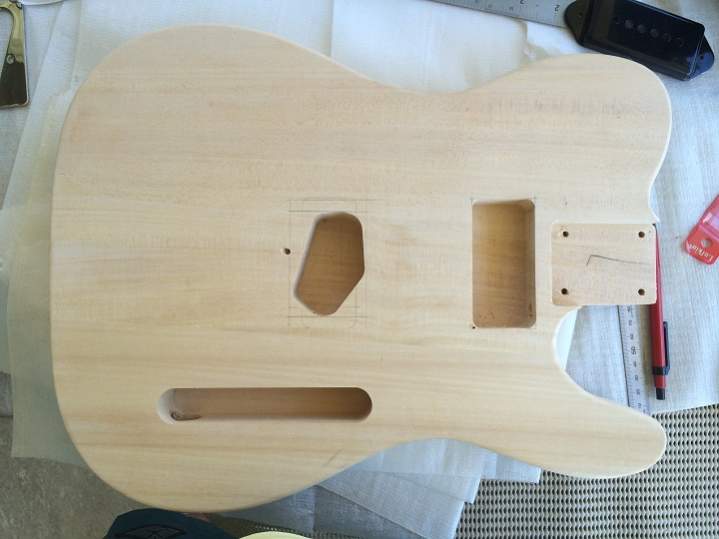

    Pic 1. Standard TL body
    Pic 2. My “La Cab” P90 body.
