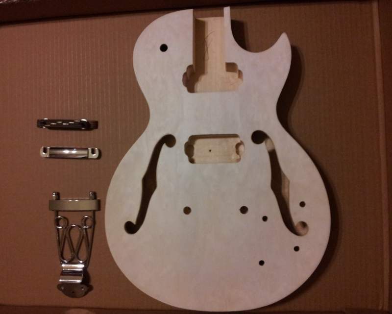

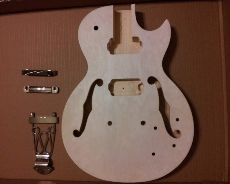

    My second go at a kit, first was an LP-1s to learn on.
    Came with holes for a saddle which were filled with dowel.

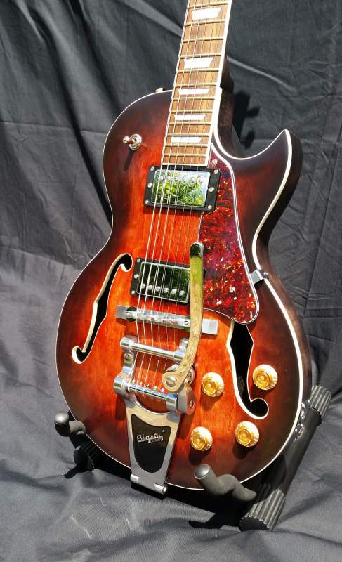

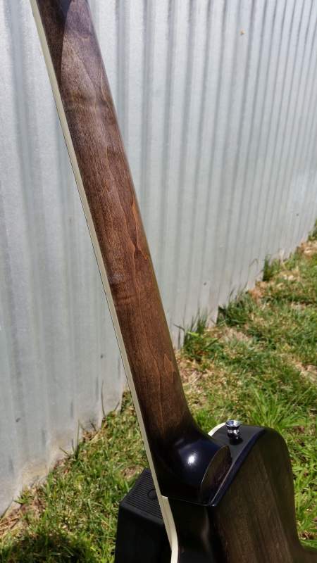

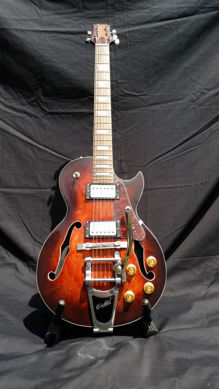

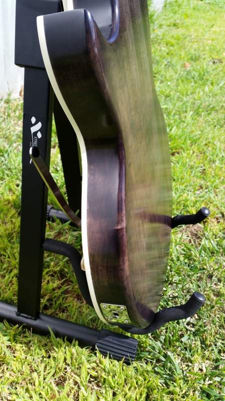

    Front finished with Wudtone Carmine Gypsy and Black Magic Woman mix with BMW burst, back and neck BMW with Wudtone gloss.
    Mock up with black knobs to go with surrounds, gold seemed to look better.

    nice one Grant, I hope you are going to enter this in February GOTM, this will be hard to beat. Is that an original Bigsby tremelo ?
    I agree the gold knobs look better than the black

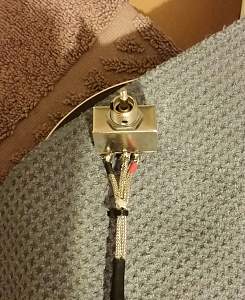

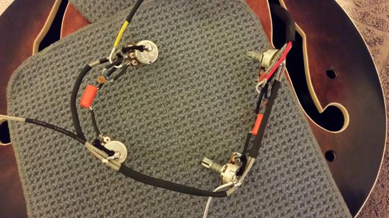

    Followed the ES 335 wiring diagram and used shielded vintage wire, orange caps and tone circuit mods.

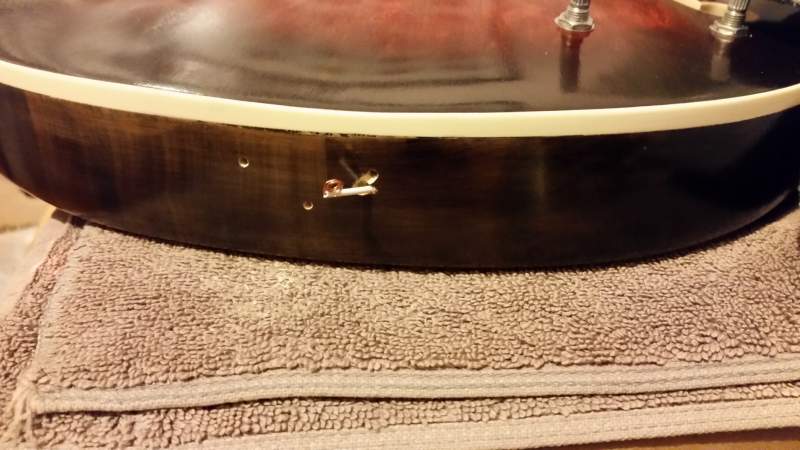

    Earth wire for tailpiece

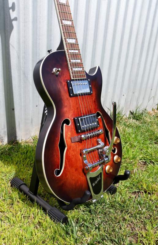

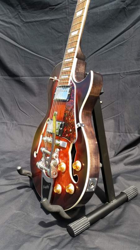

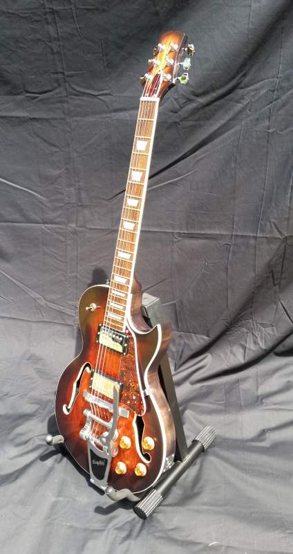

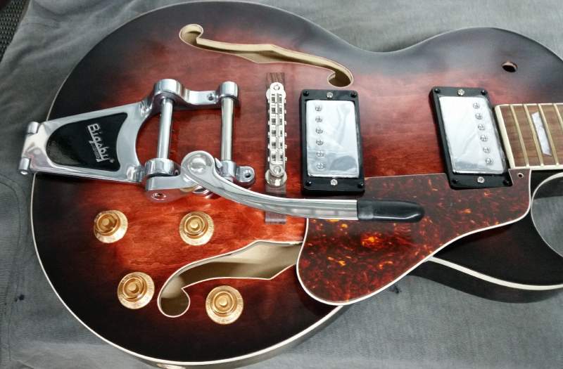

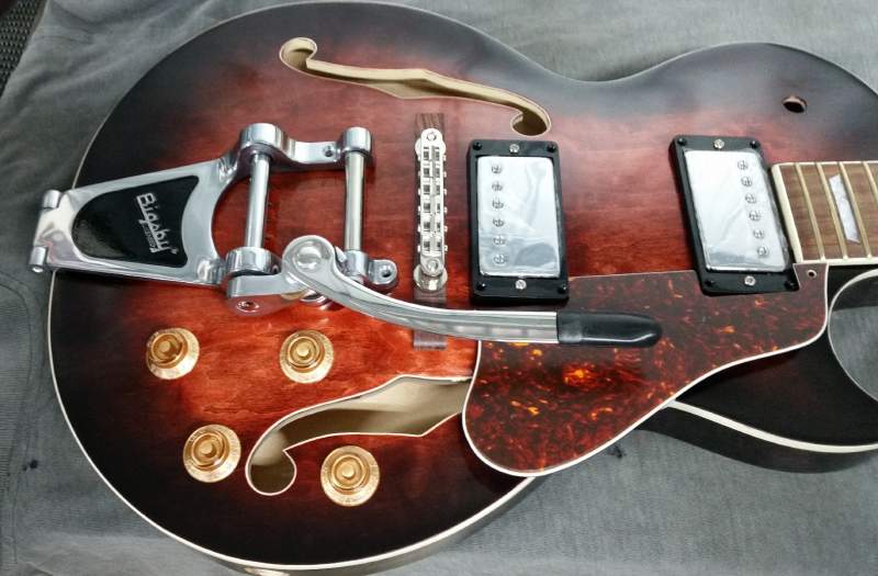

    Assembled and set up with roller bridge and Bigsby B70 tailpiece.

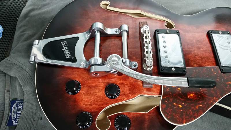

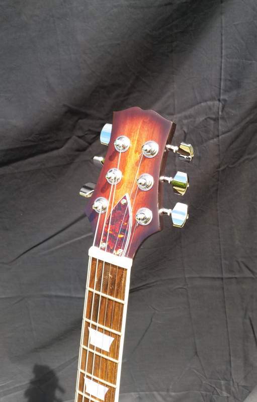

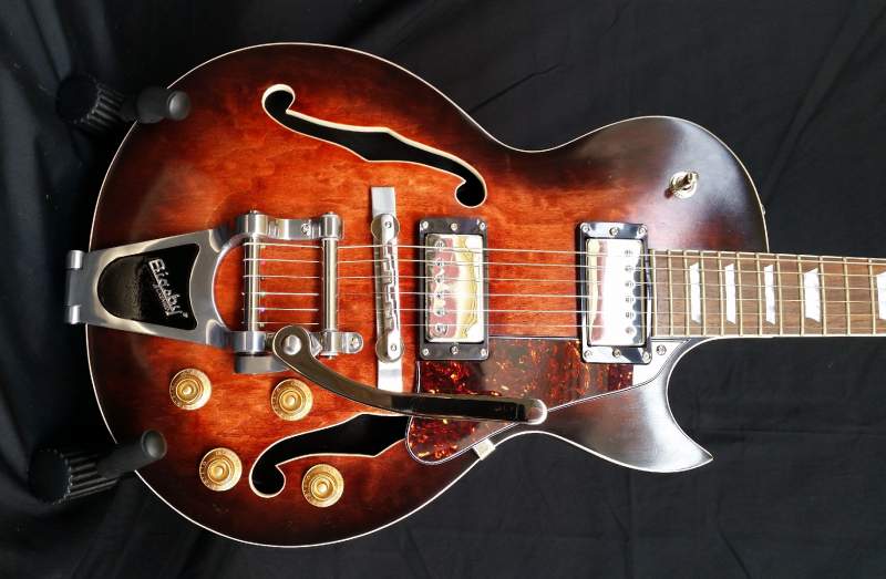

    Added tortoise shell pickguard and truss rod cover, diy - didn't want to cut up the 335 pickguard I bought.
    Changed bridge for a Bigsby aluminium one because the action was too high and I mangled the wood base trying to get it low enough, other option was to unglue and shim the neck.

    nice save then Grant
