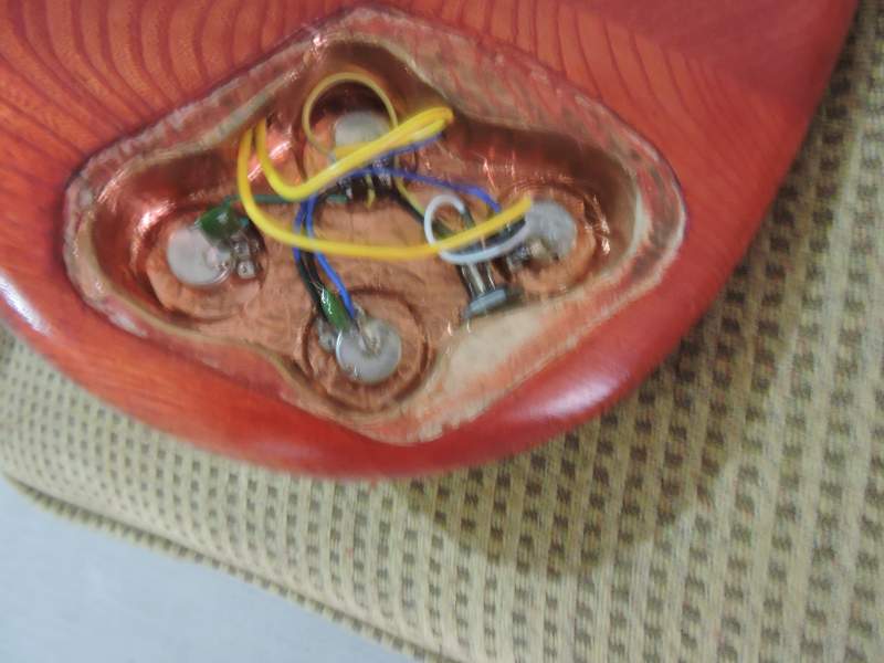

    I would recommend making some sort of template based on the cavity cover. The one definitive recommendation I can make is DO NOT do it with a Dremel freehand.

    Hey Fatmunkey, what Tony said do not do it freehand. I didn't realise the no recess till I it was all finished and bolting together so I had to dremel it without ruining the clear coats. Good you noticed this early. You will need a fairly shallow pattern following router bit and you will need to make a template. Best of luck !

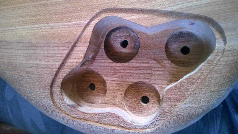

    Have just done it frehand with a dremel on my IB-5 the other day... It can be done - take your time and don't rush. Used a router bit - 650 - straight cut, then clean up any edges with sandpaper and a small chisel. Big issue I found was that with the supplied cover, most of the screw holes sat over voids. In the end I had to oversize the area that I cut out. Second challenge is that it's not flat and the edge dies away to the edge of the guitar. It can be done - you may be more successful with a template, but it may take a bit of doing to get one that fits on the edge.
