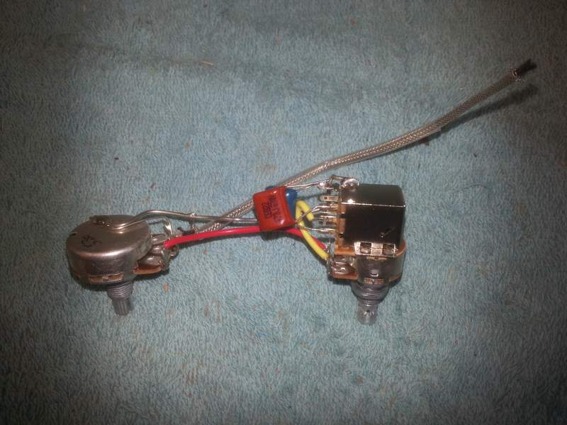

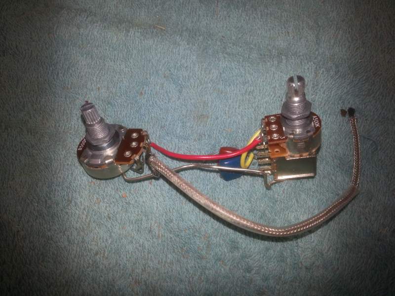

    I wasn't totally happy with the wiring in the Gypsy, so I have come up with this. it is a pushpull A500K pot for tone and a B500k pot for Vol,
    it selects between a .022uf cap and a .047uf cap
    The gypsy used two B500k pots and this forced the bass tones to the high end of the log linear pot, so there is only a small portion of the pot that selects bass tones. Now it would be a simple fix to reverse the conections on the tone pot so they have a larger portion of the pot dedicated to lower tones. But no I decided to take the harder way and build a push pull set up. whether or not this actually ends up in the Gypsy depends on which of the three DC builds I have, has the better tones.
    Cheers PK

    looks like we have a new wiring guru in the making...
