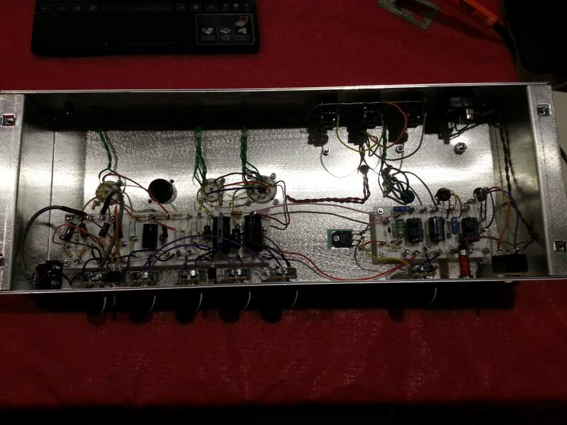

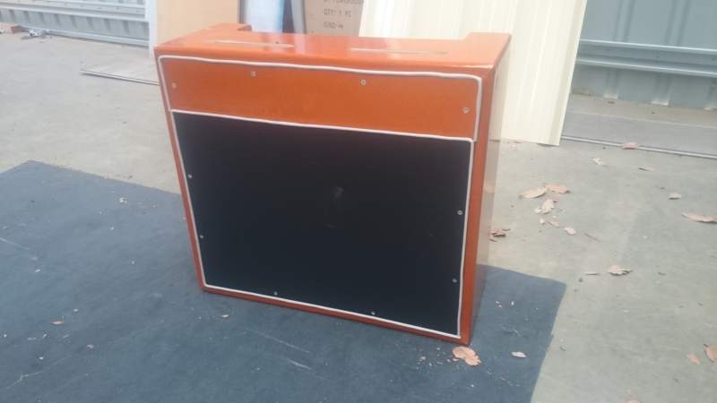

    Previous to ordering my guitar kit, I found a UK company that sells tube amp kits, having never had a serious amp I started looking around and liked what I saw for the money. I took the plunge and bought their 5W "British Overdrive" kit, which duly arrived a couple of weeks later. After about 3-4 weeks of part time evening work, probably about 1 or 2 hours per session, the kit was assembled and ready to be installed in a cabinet. With some 18mm ply and some bracing from the Big Green Shed and a second hand speaker from ebay I was in business. Once built the cab was covered in a metallic gold/orange vinyl that caught my eye in Spotlight (I was tagging along with the missus, honest!), the kit and speaker were installed and minor hardware fitted. I was very impressed with the tone, I haven't really had a chance to crank it up yet but it seems pretty loud for a 5 watter!

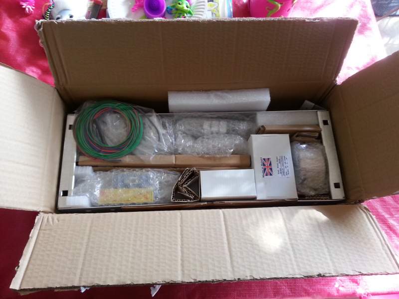

    The kit as received:Click image for larger version.
Name:	2014-07-28 14.15.30.jpg

    Assembled:Click image for larger version.
Name:	2014-08-20 22.00.11.jpg

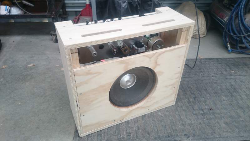

    Trial assembly of cabinet:Click image for larger version.
Name:	2014-10-19 16.24.20.jpg

    The finished item (sort of):Click image for larger version.
Name:	2014-11-30 13.22.44.jpg

    Hi guys, yes the kit comes on its own, it is a complete kit apart from speaker and cabinet though. It cost about $450ish shipped for the kit, plus the speaker at $75 and about $80-100 for materials for the cab. Just the one channel, and gain is pretty good, there is a bypass switch for the tone stack for extra gain, and a two way boost switch (fat and bright) which doesn't add a huge amount. I haven't had a chance to record samples yet as I don't have any decent recording gear, but it is on the to do list It comes set up for the valves supplied but if you fit different valves for different tones you need to adjust the bias voltage.

    But holy crap, it must be heavy with 18mm ply! Would give great resonance though
    Mentor kells80aus's Avatar
    Jan 2014
    Wyndham Vale, Vic
    775
    Hi TC.... absolutely fab. being a power freak, what does this kit put out. I've been looking at valve amp kits along the ceriatone line. 18 watt and JTM 45's and JTM45/100's but the later two are out of my price range unless I rob a bank or something.
    Love your work.
    Cheers PK
    Kellza
    (PK)
    Wokka: For a similar shop built amp I figure you would likely spend at least 50% more, and even if it didn't work out cheaper, as you said the experience is worth its weight in gold

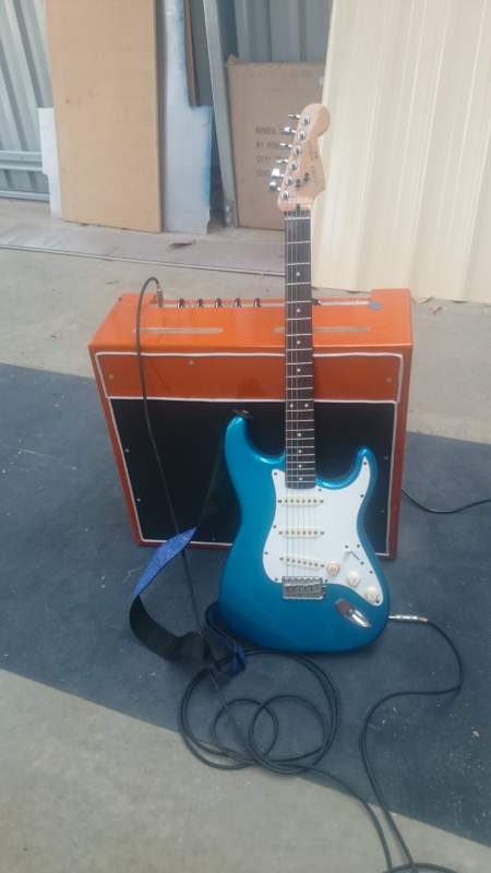

    Stan: It's actually not that heavy, but it certainly is solid! I considered putting casters on it, but figured I can live with it, I've carried heavier amps! It's not massive, here is my guitar next to it for scale: Click image for larger version.

    PK: It's the baby amp of their range at 5W, but apparently a 5W tube amp is louder than a 5W solid state, not sure why but that's what I've heard. Check their site, they do a range of different style amps from a tweed Champ clone to an 18W Marshall style. Like anything else, do your research, companies vary in price and support (some don't provide instructions, only a schematic) and some companies offer a complete kit including cab and speaker if you don't want to chase them up yourself.
