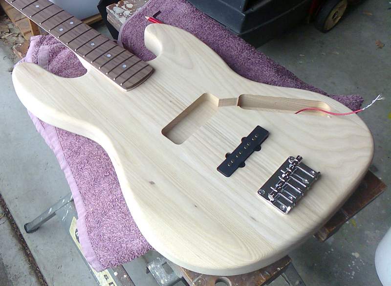

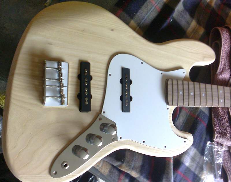

    This beauty arrived just before Christmas and, as I'm off work until 5th January I'm hoping to get a good start on it. It's good looking kit but it does appear to have been cut with older router bits, its a bit rough and is going to need a fair bit of sanding. The drill bit used on the bridge ground hole was clearly in need of replacing. The neck is pretty straight and the truss rod is responsive.
    There are a few small blemishes on the body, but nothing to worry about.

    There is a bit of glue and/or wood polishing from blunt router bits on both the upper and lower cutaways, and some definite glue leakage on the bottom end of the body.

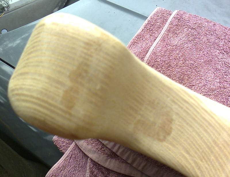

    Today I've been able to get neck alignment worked out and the neck holes drilled as well as measuring the scale length and getting the bridge alignment finalised and the done the drilling for that as well. I find one of the hardest parts is getting the tuning machines straight but after a lot of measuring, re-measuring and triple checking I got their placement worked out as well. The last bit I got done today was doing the rough shaping for the headstock.

    DT Clear for the neck, Nullabor Ochre for the body. Part of me is hoping that it will come out like the finish on old Wal basses. But to be honest I don't have a set vision like I had for the Bigsby Tele, so as long as it gets a decent finish I will be happy.
