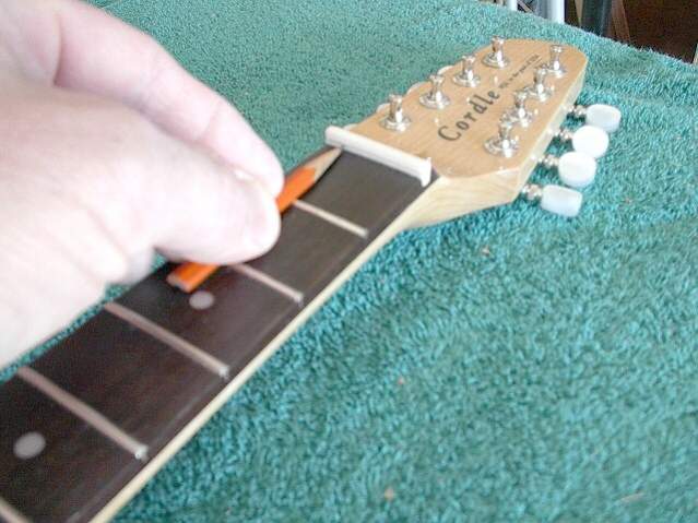

    This is what I would do.
    Set your nut in position temporarily. Take a carpenters pencil and split it in half or sand it down flat so you can run it flat along the frets to mark the radius.
    Here's a random pic from google so you can see what I'm talking about.

    Member ultpanzi's Avatar
    Apr 2014
    233
    I've always wanted to do that but I've never come up with a good way to sand down the pencil cos I dont have a disc sander, I only have a random orbital and it often takes off too much or too little.
    You could even whittle a normal pencil down with a knife, that would do the trick
